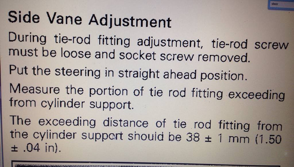

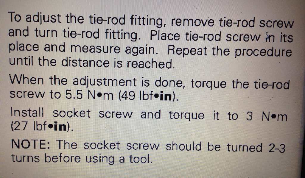

I know this has been asked many times, but havent found the right answer. I recently bought a pair of 2003 Seadoo GTX 4TEC's and one of them wants to pull left at high speeds. I have to keep the steering to the right, just to keep it straight. I "think" the OPAS are lifting and droping correctly, but when I look, the left paddle is about 3" away from the HULL and the left paddle is more like 3 and 1/2" away. The other seadoo not having the issue, are both around the same. Can I adjust this one somehow, and if so, how exactly? I know some people are going to say remove them, and I will someday, just not yet. I know I can also put the PVC in there to shim them up, however thats not really the issue. Thanks!
