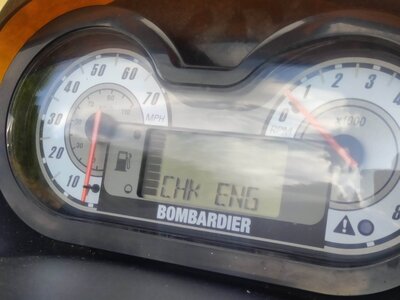

Hi
I have problem with my jetski. More then 3000rpm oil warning. and long beeeeppp
Ive checkec oil pressure seems is ok. short movie

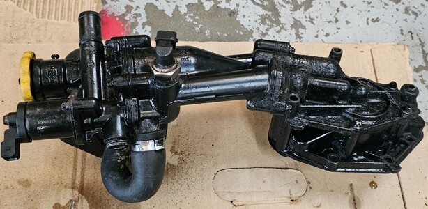

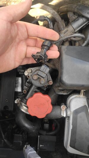

I checked connection from 2 oil sensors frone and read to ecu - OK
I checked ressistance 2 sensors 1 is normally open and second normally closed. 99% ok
Its possible voltage regulator rectifier cause this problem ?

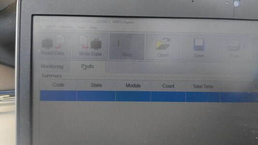

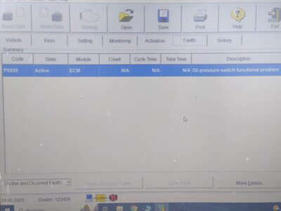

I vw check faults by buds diagnostic - no faults even if I disconnect 2 plugs from sensors - it is ok ?348386744_226379190175925_6266156360974329883_n.jpg348386570_930120844767811_3520108830089217917_n.jpg348386857_1278672802748658_7458145138267822975_n.jpg348386599_3245931862365703_7211844884004396911_n.jpg

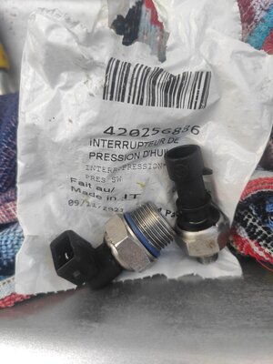

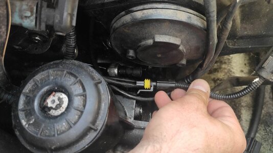

I replaced 2 sensors front and rear. Front is normally closed - I think is ok.

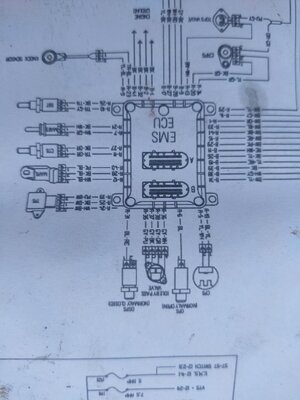

Rear oil switch sensor should be normally open but mine is Shorted to gnd thats way I have error. If i disconnect plug then error P0520 dissapair but when engine go to 4000rpm then oil check ON.
Whats going on here ? Those 2 type oil sensor - normally open and close.

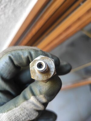

I found also
Should I use BLACK sensor ??!!

Seadoo changed from normally open to normally closed at some point. Are you sure you have the correct part number and sensor?
Are you sure you have the front connector on the correct direction? It can be put on backwards.
everything is ok I think. Explain please
