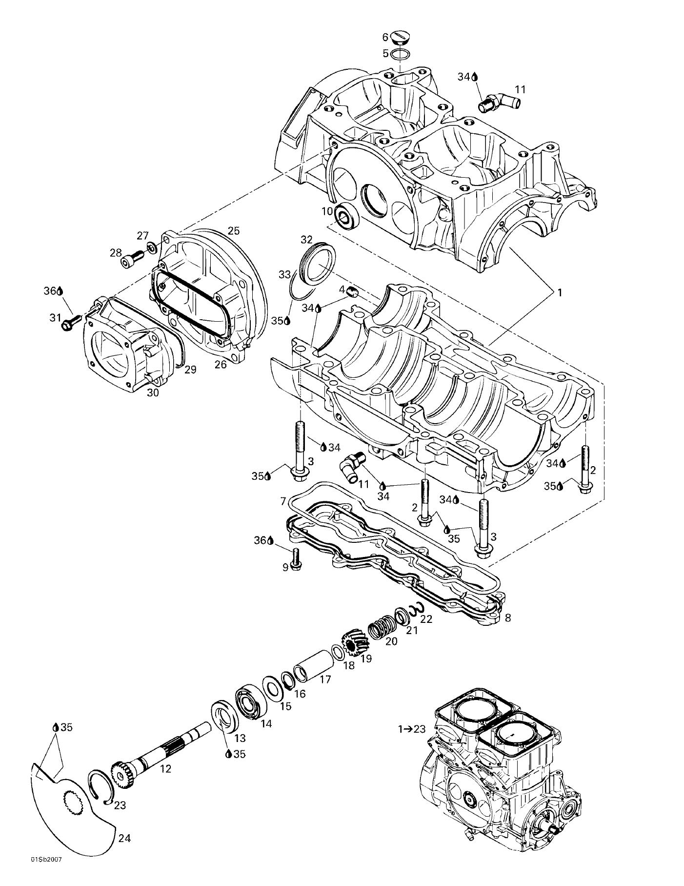

Just get down to item #30, the intake manifold

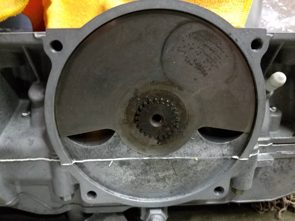

OK, here is what I found out. The rotary valve is not turning! Darn! This seems crazy because the engine actually ran for a few seconds before I removed the intake this morning. The engine ran for a full 10 seconds in the video I posted last week. When looking through the rear intake port (PTO side), I can see the crankshaft turning. I cranked it by hand and with the starter this morning. The rotary valve didn't budge. It was completely still. What now?

Your next step is to pull the rotary cover and rotary valve and check for damage. And what stopped the valve from turning.
The cases have to be split to repair the rotary gear.
OK mikidymac, I'll pull the rotary cover and rotary valve next. If I don't see any problems there, the only last thing is the rotary gear, right? I assume the rotary gear is a major job.

If the RV isn't spinning, the brass gear is stripped. You can pull the cover for an initial inspection, but ultimately the motor will need to be removed from the ski and torn down.
