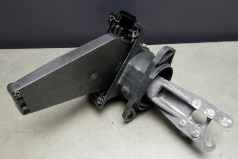

trying to get gas tank out of my 99 gsx rfi and man what a pain! the mounting bracket for the coil pack is in the way which is held to the hull by 2 rivets top of bracket and glued on the bottom (see pics) any tricks on getting the tank out? thanks.

I replaced the fuel baffle on my 96GSX and I don't think that tank is coming out unless you remove the motor. I was able to slide the tank forward far enough to replace the fuel baffle. Mine doesn't have the mounting bracket for the coil packs, I would think you will need to remove the mounting bracket, cut through the epoxy and the re-glue the bracket back on.
Lou
motor is removed but that pesky bracket is in the way and sounds like a lot of work to remove the bracket but yea you're right about the bracket. now i wonder how much if any gunk is in the gas tank. the PO premixed the gas which is a no no on rfi engines but of course the oil pimp was still in tact. ( engine is out being rebuilt) I did siphon all the old gas out. maybe i'll slide the tank back in and forward to remove the fuel pump assy that way (replacing pump and regulator along with filter socks) and hope for the best.

I just checked, the recall involved the smaller 9 gal. gas tanks, like the 96XP and some 12.5 gal. GTI's. GSX's were NOT part of the recall. So unless your tank absolutely needs to come out I would just try to service it inside the ski.
Here's a video of how these things are made, the gas tank is installed before the deck is epoxied to the hull.

If you take the whole steering column off or the part the stem goes through, you can get to the baffle easier. That is just the baffle though. Have no tips on the tank.
If you remove this, the baffle will pull out of that hole that covers.
thanks jetskigoodies, ill keep that in mind. or maybe pull the tank forward after removing the mpem which ever is easiest.:)
