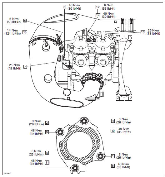

Rebuilt the carbs, new fuel lines, sprayed storage oil into spark plug holes while I did the work. Now I have got it all back together and when I fire it up It's blowing smoke out of the exhaust Manifold. I torqued the for bolts on the exhaust to 18 pounds. I also did this in a Crisscross pattern slowly adding turns to each one. I also used a new gasket. I have not hooked water to it because I don't want to have water go into my intake box. It was hard to get the pipe to line up Perfectly,but I was able to get the bolts in with my fingers first. Any Suggestions? Can I Reuse the gasket if I have Redo the Exhaust? Man I just want to go for a ride. There is a gap between the exhaust and the engine where the bolt from hell is. 2000 seadoo lrv 951cc.
