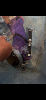

Just got in a few minutes ago, ran the 95XP in the hose and no leaks, IMG_4833.jpegI annealed the copper ring and then gave it a quick sand on a piece of glass with some 1000 grit paper. The ring measured 1.06mm before and 1.10 after annealing and sanding. IMG_4842.jpegIMG_4843.jpegAfter reading up on the 1211 I decided to use just a light smear of ultra copper on the paper exhaust gasket. The 1211 and the ultra copper were both RTV’s and I had the ultra copper so… I went that route. IMG_4814.jpegI thought the welder did a good job welding in the new Welch plugs, I knew he would, he’s about 35 and has been welding in his dads weldinh shop his whole life.
