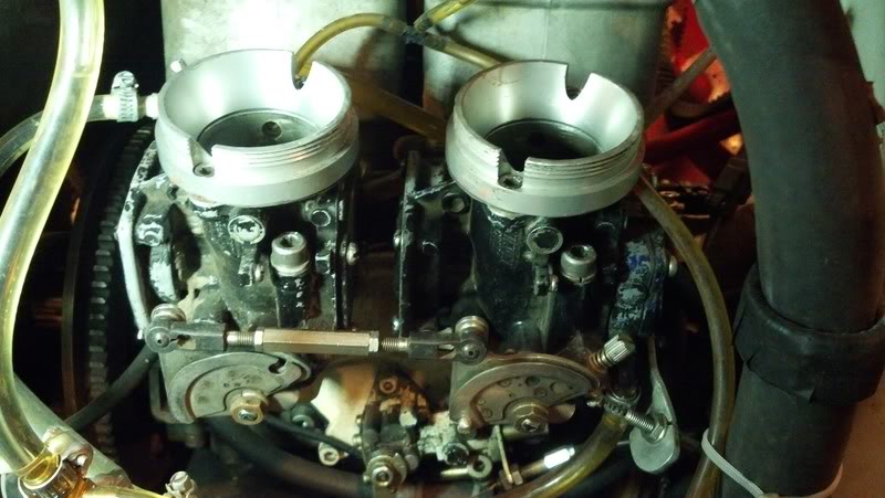

Ive got the thing running really good with these carburetors, just cant get the idle nailed down. It also is hard to start, have to crank it for a good 15 seconds before it sputters and starts to fire. These carbs are a bit different than i have worked with before, and that is why i joined here... to hopefully get someone that can point me in the right direction of getting them tuned up. Hell ill even become a supporter if you guys are willing to help me. Been fighting these things for a while.
Carb Setup

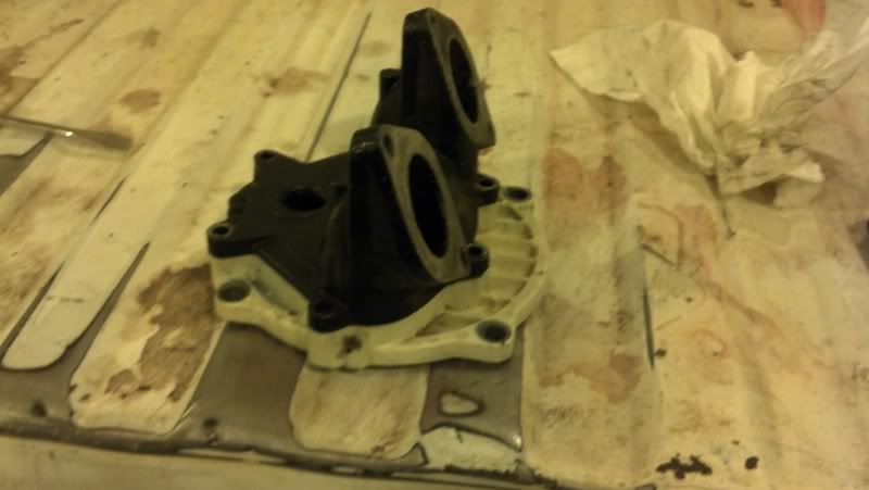

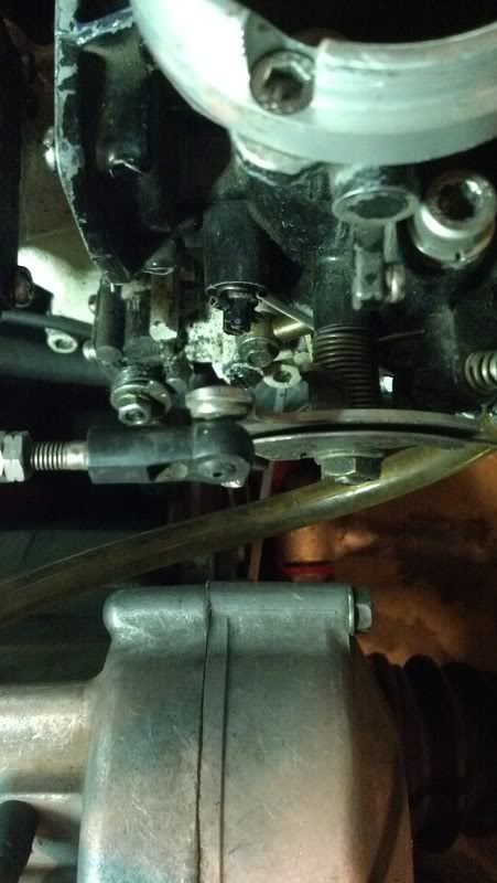

Clearance between trans and carb. With the roundslides they wont fit down in the space. even if they did, there is no way a filter would fit on them.
intake setup. this is a spare i have in my parts pile.

Do you have the primer hooked up? It doesnt pop right off when its cold and you prime it?
When you have this "bog" have you tried to hit the primer to see if it helps or hurts?

Yes the primer is hooked up. When i start it cold with the primer after it has been sitting for a day, it will pop right off, run for a sec and then die. prime it again and it will pop right off again and usually continue to run. as long as i hold the throttle a little bit because i dont have the idle figured out. Once it is fully warmed up, it takes a little bit of cranking before it will start. This is not using the primer. If i gave it a small shot it would fire right off.

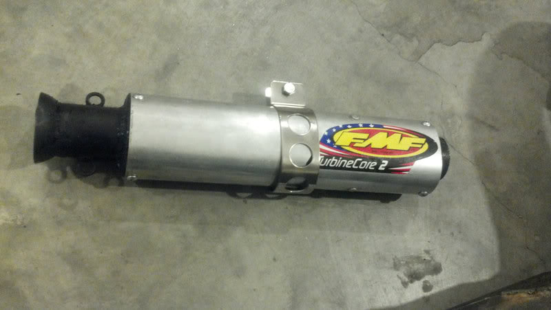

Man that's gotta be loud, how are you cooling it?
Sure is loud. Modified a 500CC dirtbike muffler for a larger pipe.. its more or less just for decoration because it does not seem to do a hell of a lot. i did not want the huge snowmobile can hanging out the back.

i got the carbs dialed in so they were running perfect, but wouldnt idle. I was puzzled. One day randomly surfing youtube there was a guy trying to find a vaccum leak on an ol ford. What was the symptoms.. wouldnt idle!. SO i decided to tear apart my intake system again and inspect each and every gasket and sealing surface with all but a darn magnifying glass. Turned out that there was a bit of sandblast remnants between the rubber o-ring that is between the rotary valve cover, and the piece the carbs bolt to. Cleaned all of the crap out of there, made sure everyting looked good, lapped the flat surfaces where the gaskets contact, and put it back together. Fired it up and it even sounds different than it ever has. Almost sounds like it has a miss to it. Put my hand over the clutch side carb and it would just keep idling. put my hand over the mag carb and it would kill it. looked down into the throats of the carb and they are out of sync. got them close and it is running great, just need to get it out and jet it.Also have a sync tool on the way
