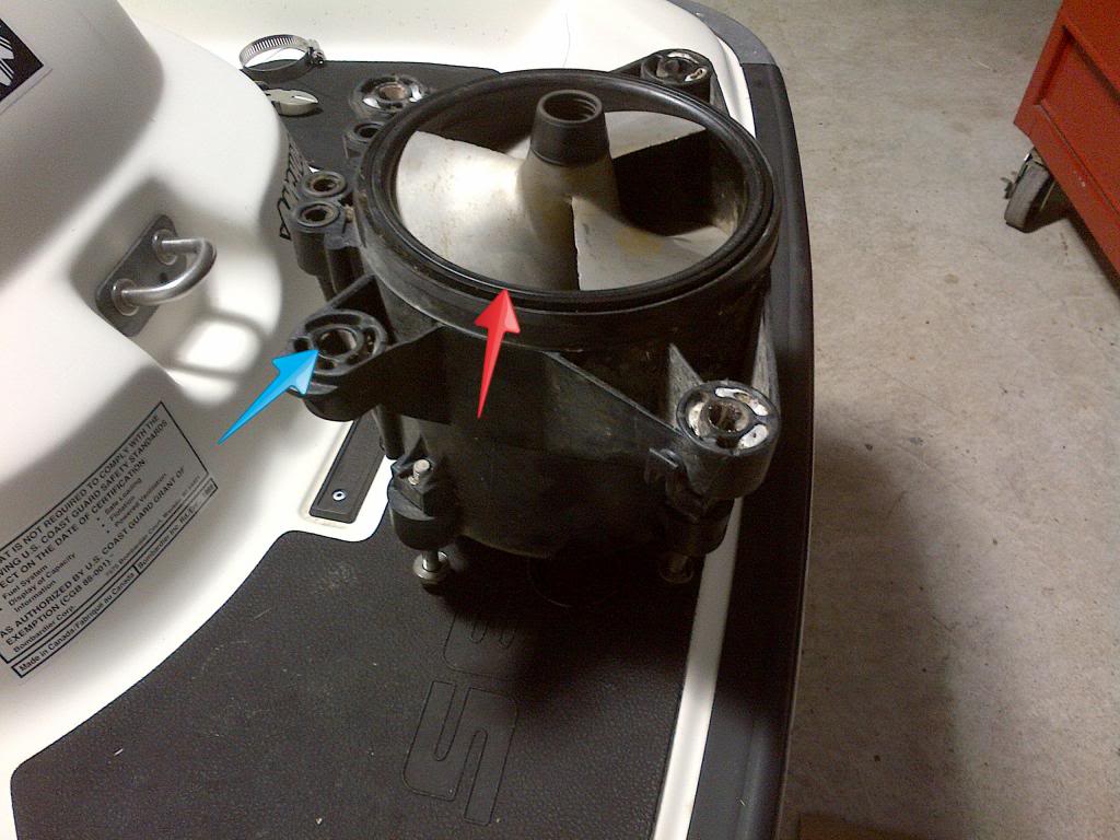

Does that part go between hull and pump? I have a rubber (silicone) one and it seems to be really snug and in good shape.
The seal will go between the impeller housing, resting against the wear ring and the pump support plate. The pump support plate usually is silicones to the fibreglass hull, which you will not need to remove for the job at hand.
For some reason it seems they did not install the neoprene seals on all the skis, nor do they show them in the parts manual. It is still recommended to put one in there it helps with cavitation. If you have one in there and it is in good shape you are good to go.
The red arrow shows where it will go on the impeller housing.
