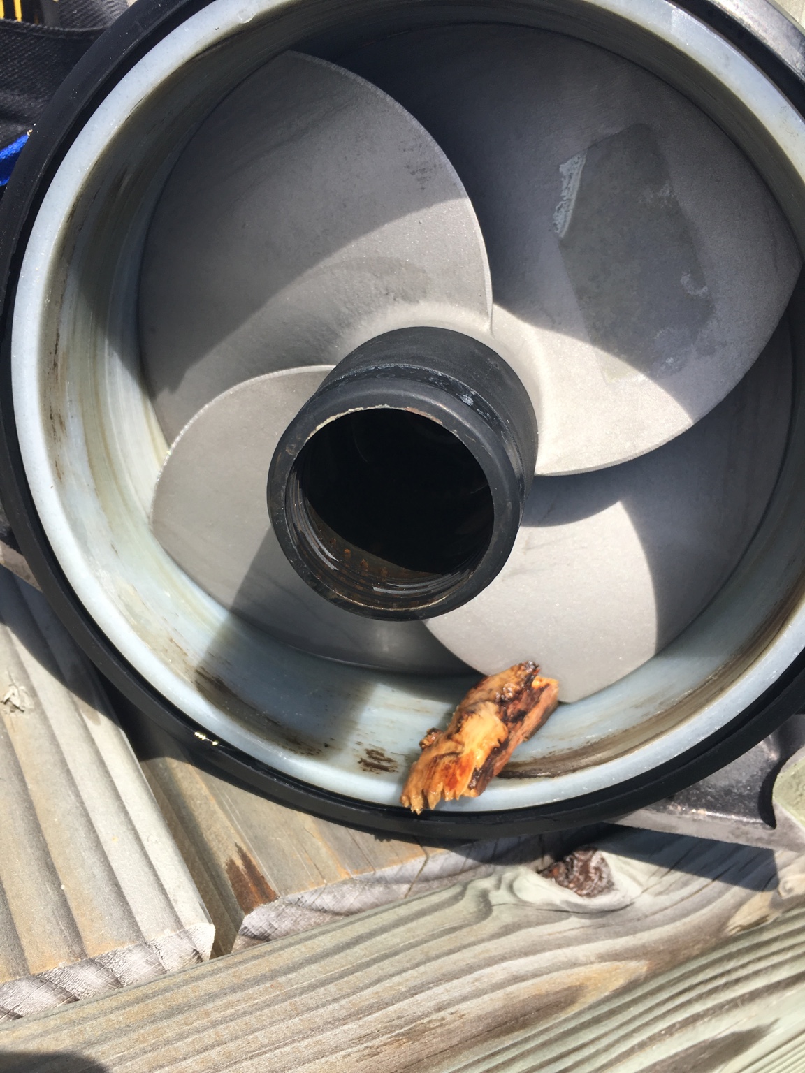

I thought the shaft had stripped out from the excessive amount of vibration I was getting plus I was playing pretty hard just before it happened.

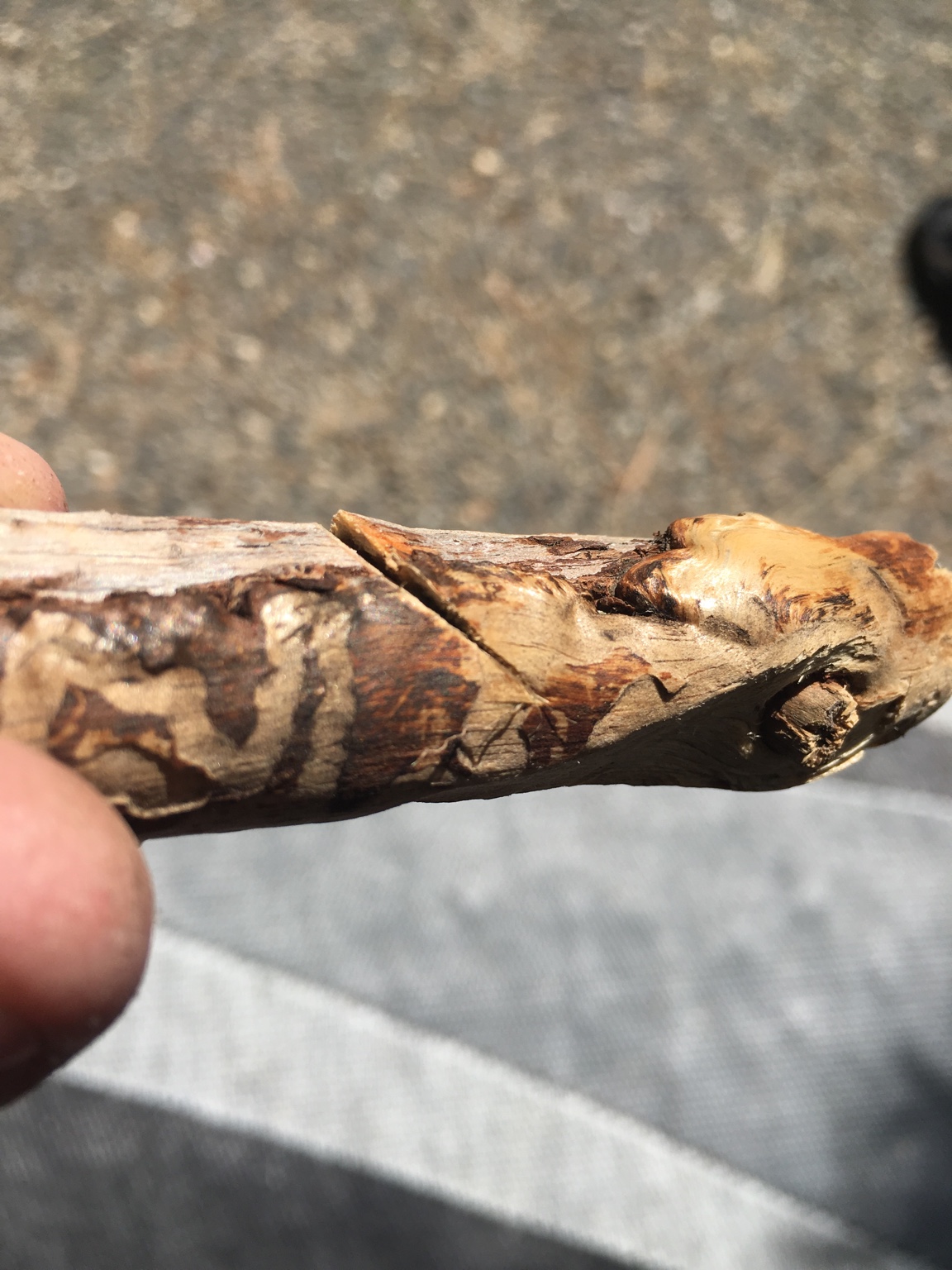

Anyway a hour of standing in the lake while on the boat lift I pulled her apart and bingo..... Drift wood! The impeller had sliced into it but not in half so it was stuck on on blade.
Ps I only dropped one bolt.... Lol
Thought I'd post this as I'm sure it's been posted before but thought I'd share. I could not see a thing from the out side, maybe if I had my bore scope. But flashlight in the dark I saw no signs of anything... Just a FYI.
