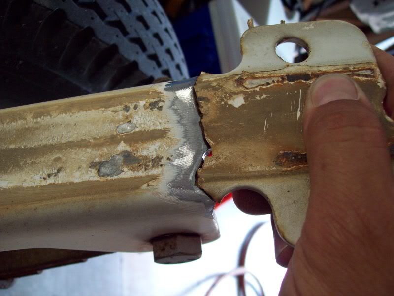

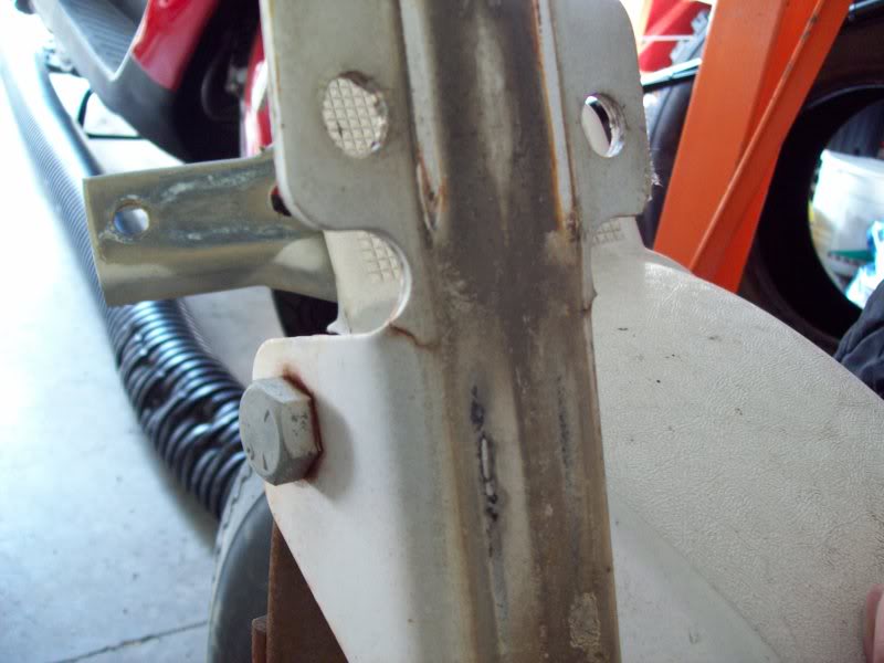

Hi all, new to this forum; I just wanted to tell you all to check the brackets that mount your trailer springs to the frame. I was giving my trailer a good once over before vacation and found the bracket broken off at one of the four points and the other three points where cracking. Take a look at the pictures... I saw the cracks and thought it was just the paint cracking but after closer inspection I found this...
This is the trailer that came with my SeaDoo boat, it has SeaDoo decals on it that match the boat so it's not some cheapie trailer...
Sorry it was a 95 speedster, as far as I know it has never seen salt water... I live in the MidWest (MO) and I am pretty sure the boat has never been past the bordering states.
