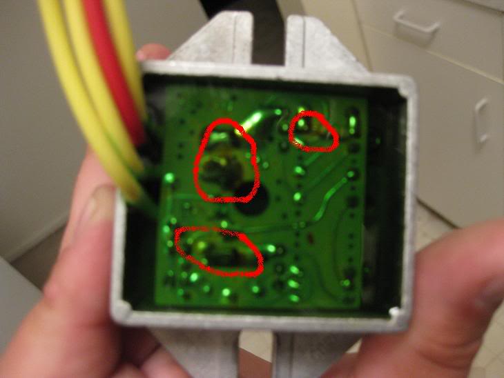

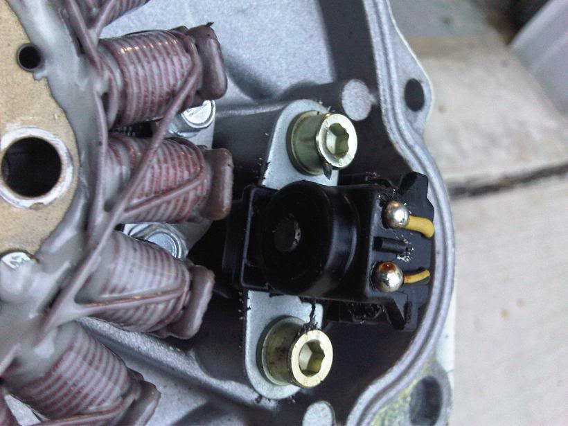

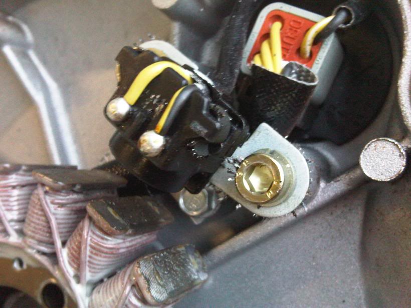

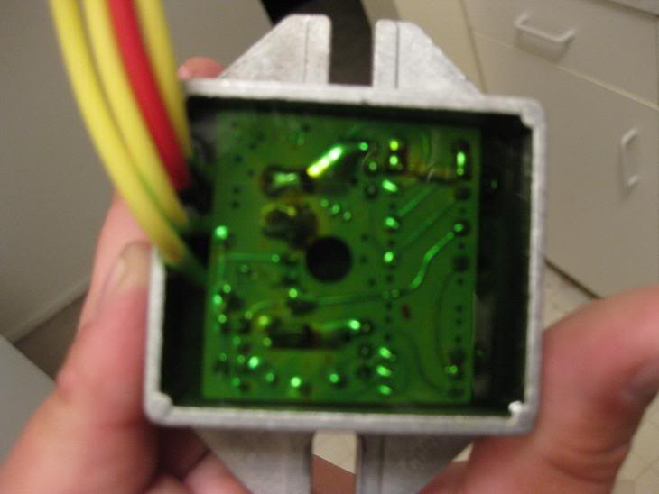

I'm pretty positive this is/was my problem... This thing is burnt! The solder contacts are blackened, and you can see where it got so hot it discolored the circuit board inside. The Sea Doo would fire up fine, but sometimes would display "12V low" on the info center, and after awhile would start running poorly, dropping rpms, sputtering, etc at anything above idle. I REALLY hope this solves my problems!
I replaced it with a new one this evening, I haven't had a chance to test it out yet. Hopefully Wednesday!
