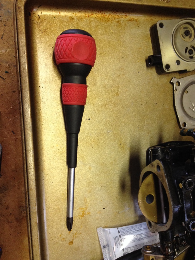

After stripping out another set of the carb screws on the plate that covers the main jet, I went to find an old post on carbs. I found one that said the screws were actually JIC and not Phillips. So I bought this screwdriver http://www.***********/gp/product/B000W9N09M/ref=oh_aui_detailpage_o00_s00?ie=UTF8&psc=1 on Amazon. It is a JIC +2 size. I just got it and it works GREAT. I pulled the plates off 3 different carbs and they did not even think about camming out. One was really stuck, but the screwdriver really holds great and it pulled it right out. You can tell it fits the screws very well. This one has a big ball on the end that is easy to hold and turn and put a lot of pressure down on the screw. If you do carbs, I would seriously look into getting one. This one was only $12 delivered free in two days with Prime.
. A picture of it

Yep, if you google JIC screws, you will see that the difference between the JIC and Phillips heads. Close but very different. The JIC screws are easy to spot. They have the dot in the head next to the cross.
Well I had JIC on my brain and it is really JIS. Sorry. Cant edit the posts now for some reason. Also, the link is bad so in Amazon it is a Hozan D-332-100 JIS +2 Ball Grip Screwdriver
