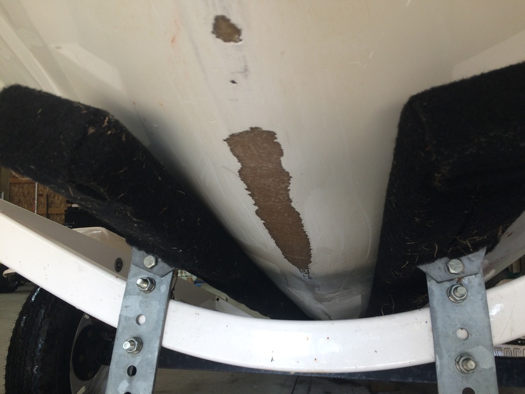

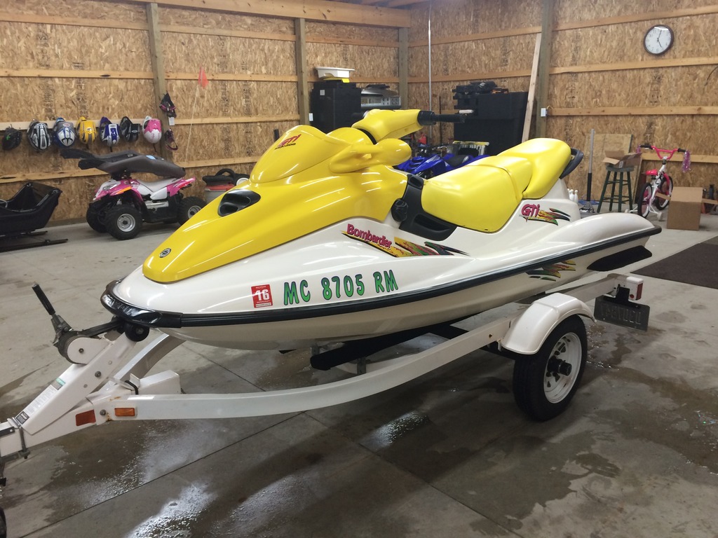

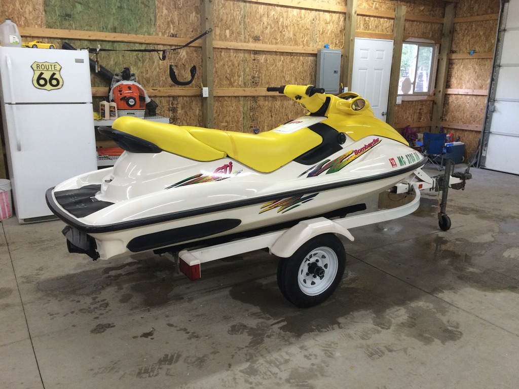

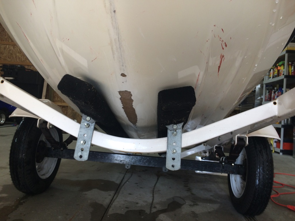

With me getting back to the sport with my XP I think I could use it more if I got the wife and kids involved. I found a good condition GTI locally with no trailer for $1400. I went and test drove it and it ran great. Already has new fuel and oil lines and looked clean. I did notice that they beached it a lot. I kind of checked the bottom but obviously not well enough. How horrible is this hull? I assume it can be fixed? Should I not use it until it's fixed? Thanks for any help.
nice ski! for the record,EVERY one of my skis are worse on the bottom than that!
but,check it for soft spots,,but it really doesnt look bad from what i can see

Personally i would just brush on a couple good coats of exterior oil base paint to seal it. If it holds up for the rest of the season then leave it alone, if it starts coming off then you have all winter to fix it right.
Assuming it's 100% dry right now, I'd put a light layer of fiberglass over it, sand it, paint it and enjoy.

Run it. My 96 is just like that. There is so much resin in that, I would find it hard to believe that it would water log. It's just sanded thru the gel from beaching it.

I wouldn't worry about the rash on the bottom - I see this often on boats (main hobby). Unless you're paper thin, which from these photos I doubt, you're fine. You're only at risk of osmosis when it's rougher than this, and that's only if it's left in the water for much longer periods.
I'd do a proper gelcoat repair during the winter. Shouldn't take long if you prep well, and are prepared for a good bit of wetsanding. Provided there are no gouges, or anything to be filled (A thin layer of bodge or bondo it's called in the US? will take up any pin holes.) I spray flowcoat on in cases like this, just add a little styrene to thin it out.

As for the hull, I would repair it with some glass, sand and paint it. It may not be absorbing water at this time, but it is easy enough to add some protection. And we all know,, protection is a good thing....
If you plan on beaching it as well, buy one of the Keel Protectors and install it. This will all but eliminate the wearing of the hull..
