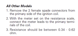

I opened up the rear electrical box to get a look at the coil and see if maybe a connection was corroded or something. Thankfully it was dry in there and nothing really looked especially corroded. I pulled the 2 female wire connectors off the coil and tested across the 2 blades with my multimeter. I am getting around 3.4 ohms, which i think is very high - manual says it should be between 0.34-0.62. I was suspicious of that reading, since it runs so well at all other RPMs, so I even got a different meter and measured again with the same reading of around 3.4 ohms. Does that make sense that it would measure so high yet only have issues at a very specific RPM in the middle of the range?

I got a brand new one to put in my SPX, which was previously running perfectly. When my GTI was acting up, I took the original OEM coil from the running SPX and put it in the GTI, which had an aftermarket junk coil, and the GTI started running perfectly. That left the SPX without a coil, so I figured I'd get a cheap one for now even though it might not last as long as a good used OEM one. Boy was I WRONG. I opened the sealed package, immediately tested it with the multimeter and got 1.5 ohm resistance, factory spec is 0.34-0.62 so thats WAY higher than it should be even straight out of the box. I put the brand new aftermarket coil in the SPX, and it started showing the EXACT SAME symptoms as described above for my GTI with the aftermarket coil (I assume, it has no markings).
