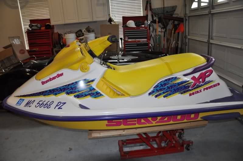

Here is a photo from last spring:
Seat is original. No cracks or rips. I removed the Sea Doo branding once it began rubbing off.
Gaugues work. The black bezel paint is flaking off, but they do work.
Trim motor bench tested good.
Hood has some fade on it, no cracks.

Yep that thing is clean. I would go thru the carbs, and replace the fuel lines too if you decide to rebuild.
