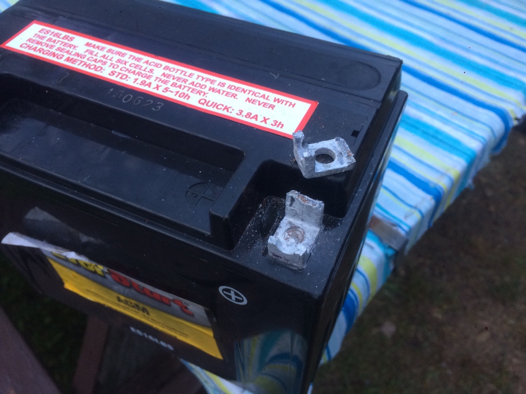

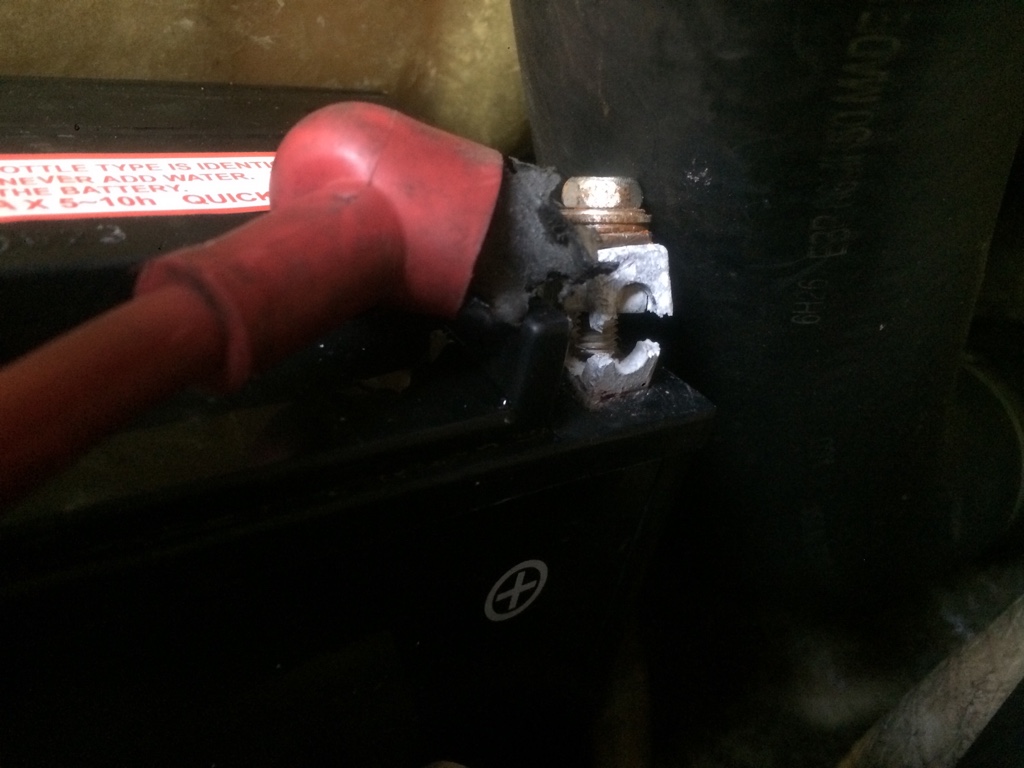

Ok folks. Here is one I am scratching my head over. How do I repair this? The battery is new, one month old, so don't tell me to replace it.
Ideas?
Remove the screw. Tap it back down, use a soldering iron to melt the legs back together. Use a nut and bolt of the correct length.
I thought on this type battery with the floating nuts the bolt goes in front to back and not from the top.

Looks like screw was too long.
I've had some split on top corners too but not fully raise like that.

Are the lugs lead? Can it not just be soldered (melt/welded) back on and be good to go?
It is the bolt that came with the battery. I have a stack of flat washers on to space it off more. It is not binding. The top of the terminal "box" just lifted off.

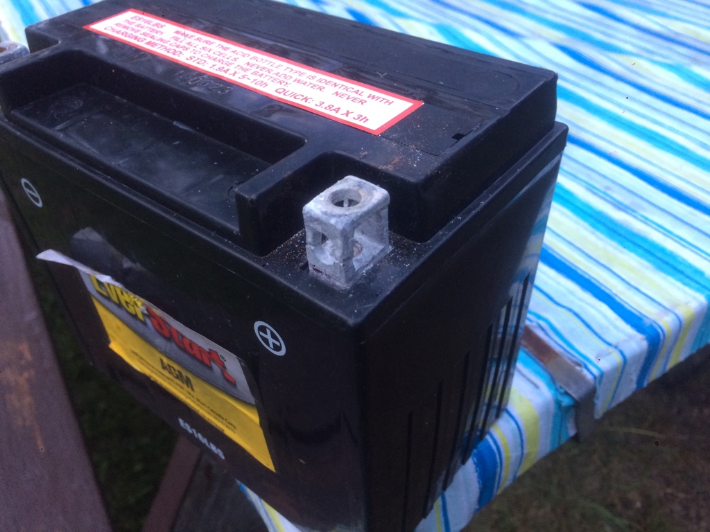

Looking at the picture I wouldn't risk it either.
How thick do you think the base root of the post is. I am thinking of drilling and tapping into it.

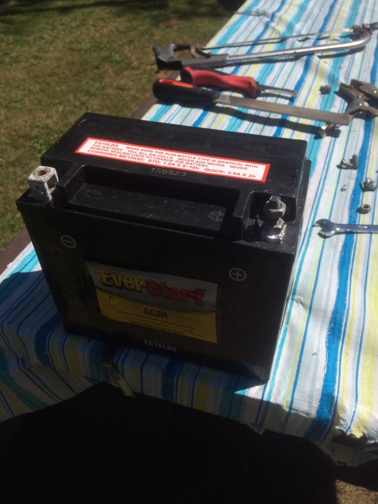

I am nowhere near a walmart until wednesday next week. And the Doo needs to run today. A new battery is not an option. This one is fine other than the post problem.
A service tech tells me there is a good thickness on the posts and to go ahead with drill and tap with no concerns. That is what I am going to doo. I will update later when it is done.

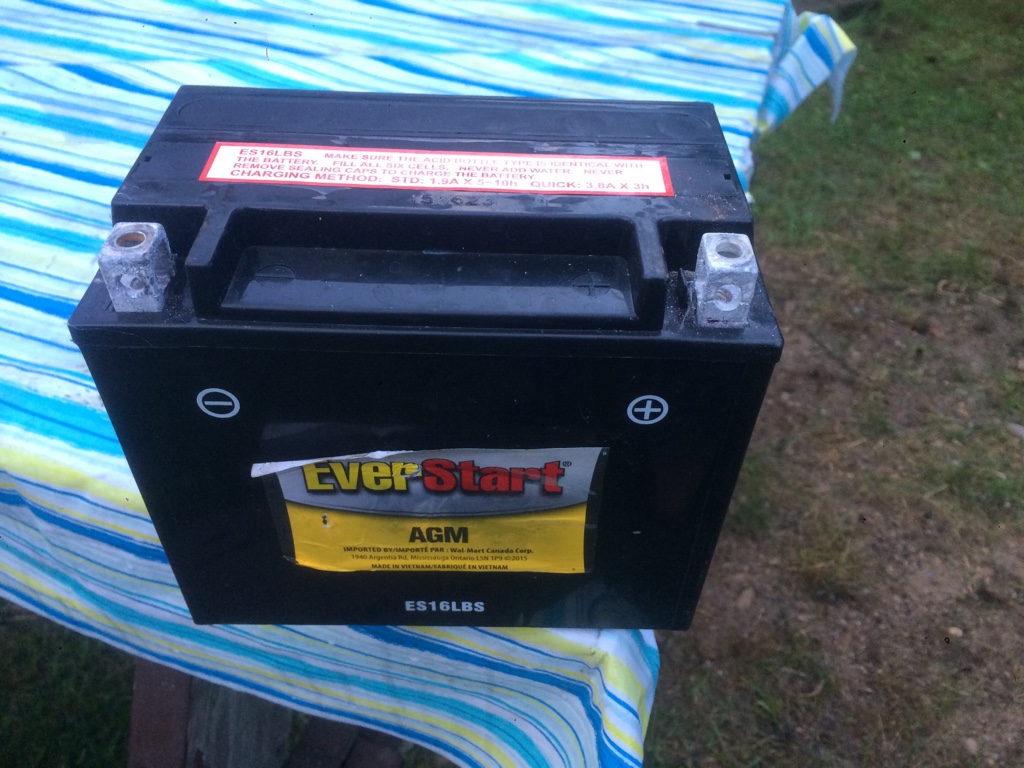

There you have it. Fixed and working fine. Not my best picnictabletop machining work but good enough.
Drilled 7/16" deep down center of the post. Cut a 1/4"nc x 1.1/2" stud. Lock nut on bottom. Top nut for clamping wire lead.
Cost: 20 minutes + sunburn + 1 hotdog + 1 beer + 0$
When the weather turns, I will cut the other post off and do the same thing to that side.
