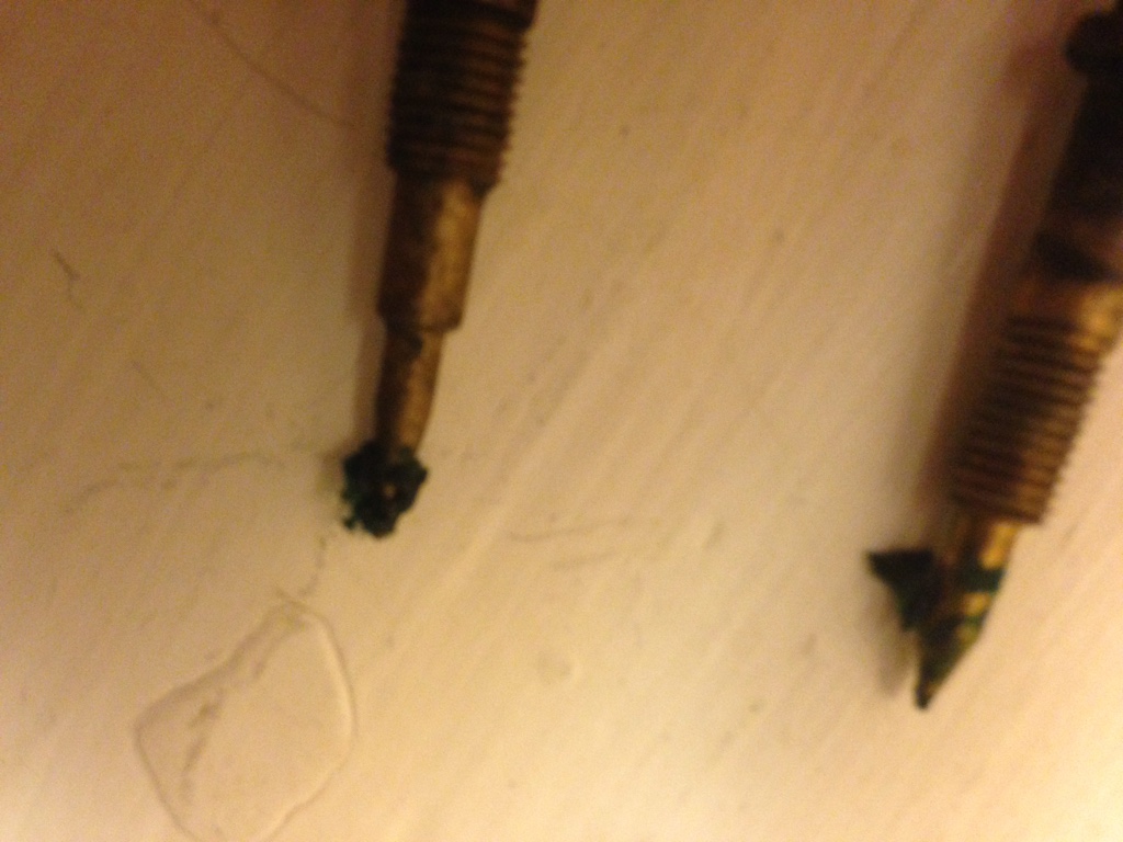

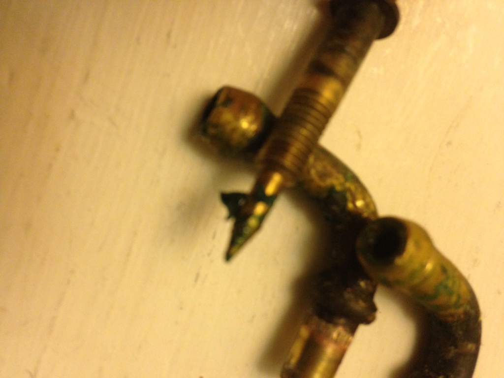

And this is a prime example of the green goo.. This stuff is definitely sticky almost tar like.. I used these two needles to lightly pick out the little blockages in these inlets.. This stuff is no good..
