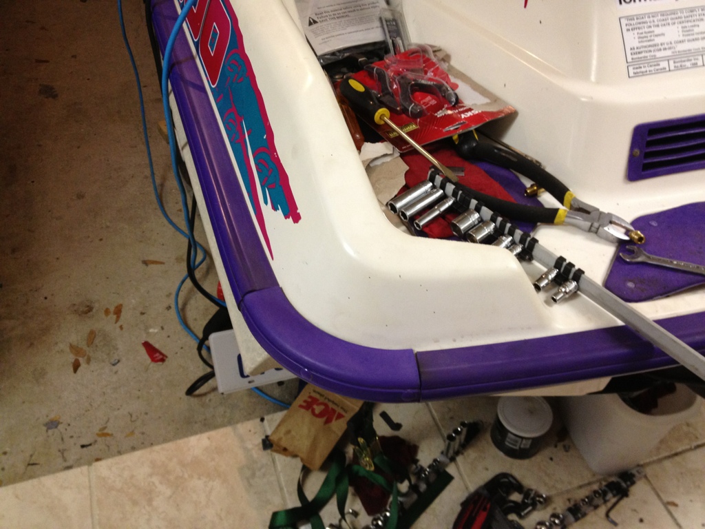

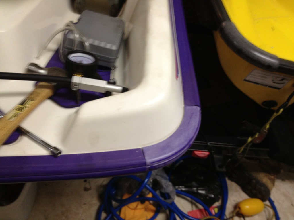

Didn't get to the lake on Friday, but did get the pump back on and everything back together. I also picked up a heat gun from harbor freight and brought the corner bumpers back to life on both skis, and installed new blacktip mats on my xp.
before:
after:
the vents on the rear of the seat also got all their color back via the heat gun, really pleased with the results.
