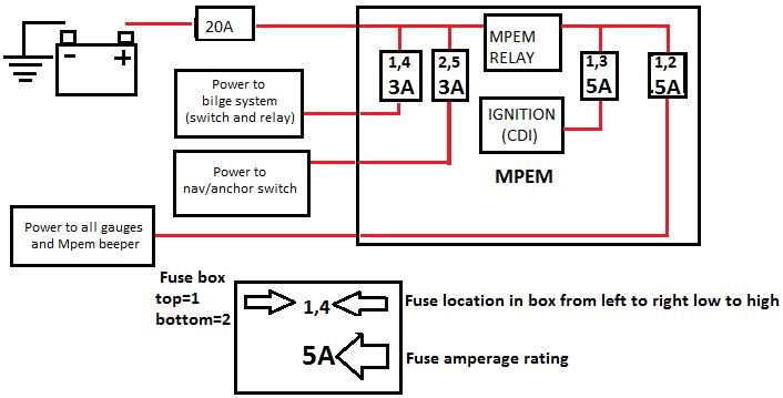

I love the 98 wiring diagrams, I was looking at the 96 because I didn't feel like downloading the 98's (I'm on a verizon mifi in the country). Now I am glad I did. I figured the wiring worked the same, it does, just the 98 includes the radio, added some fuses, moved some fuses to the mpem and added more details to the drawing.
Anyway, I'm sorry if I confused you with the black box under hood comment, looks like it doesn't exist in the 98.
From what I see, the mpem's ignition, nav lights, gauge power, warning beeper and oddly enough, bilge pump all share the same internal power circuit, supplied by an external 20A fuse, but each component has it's own fuses as well. The only common denominator is the 20A fuse, and mpem internal circuit... The blower does go through the mpem, on the same power supply at the mpem's comp, (which is not the same supply as the ignition) and is on a separate circuit from what is malfunctioning.
Does the beeper still work when things go bad? Try shorting one of the temp sensor wires to ground to see. It shouldn't if you have lost power to the ignition.
There is nothing in the Mpem between your nav lights/bilge pump and the 20A fuse electrically, besides their respective fuses. The other components have a mpem relay that is turned on with the mpem security, anything you normally see turn on with the key.
I extracted the basic circuit from the FSM and turned it into a basic power flow chart. It is for the average joe to easily understand, that is why I didn't use correct symbols or just copy the manual and post it. Well, hope it helps, enjoy.

That is exactly why i think it is just something simple like a loose wire. The lights do not go through the mpem. If you are losing the lights, it isnt the DESS post or mpem. Pull the battery switch out and check the wires on the back of it. Check the wire from the battery to the switch and check the grounds on the battery.
According to the wiring diagrams, they do go through the mpem physically, they however are not controlled by the mpem. They just use the mpem as a power buss. You can help prove this by unplugging your mpem and seeing if the lights or the bilge pump work. Would not be the first time a FSM has lied to me lol. It would help this situation out, if you could test this for us as I don't own a speedster. :) Thanks in advance Foster.

Due to the sensitivity of the MPEM, i dont really wanna mess with it and unplug anything. However, I did pull the battery switch out and I know that there is a smaller red wire that does control the bilge pump and lights. With that disconnected, the boat will not start. So it would be safe to assume that is the single power wire that feeds those items with the mpem. I looked and tried to follow that wire looking for the 20 amp fuse. I dont see it, the wire goes into loom and then goes into the MPEM where I cant see it.
The problem is not the post or lanyard, the MPEM does not need to communicate with it for the lights and bilge pump to work. They work anytime the battery switch is on, without the lanyard on. I dont think the MPEM is bad because the problem is intermittent. I really think there is a bad or loose wire. Its probably not the ground because you get it to crank but not turn over. I would check for that red wire and make sure it is tight on the battery switch and follow it looking for a bad spot.
