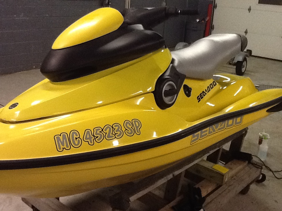

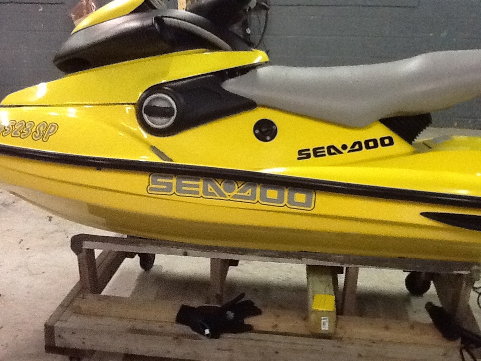

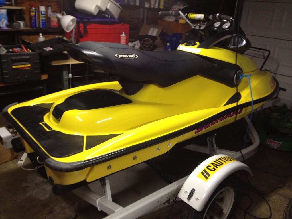

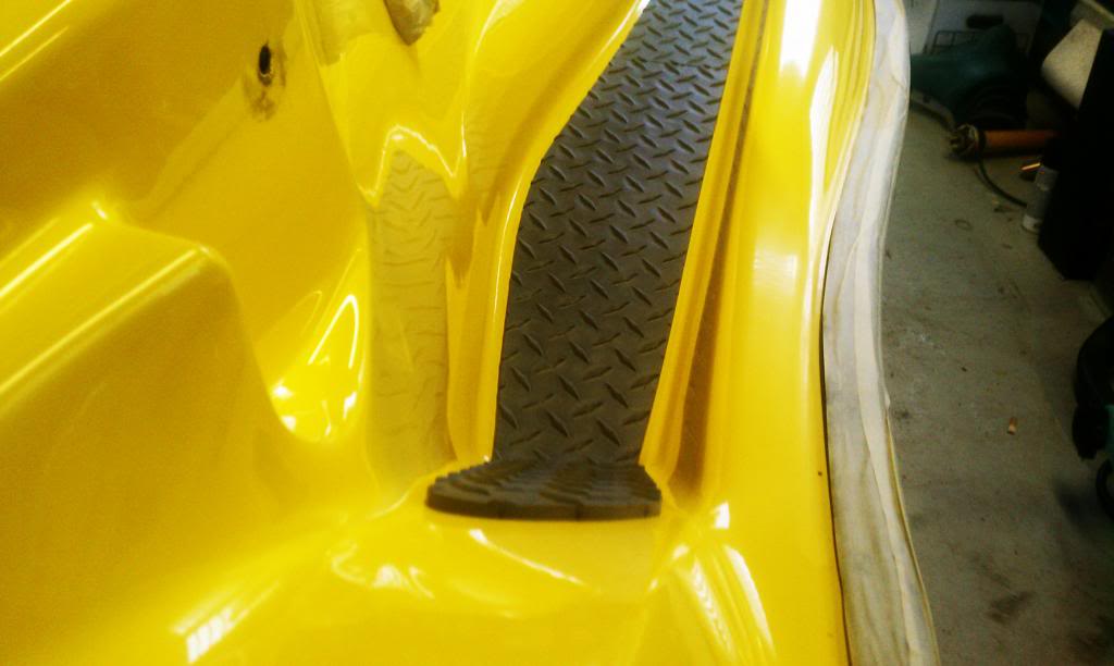

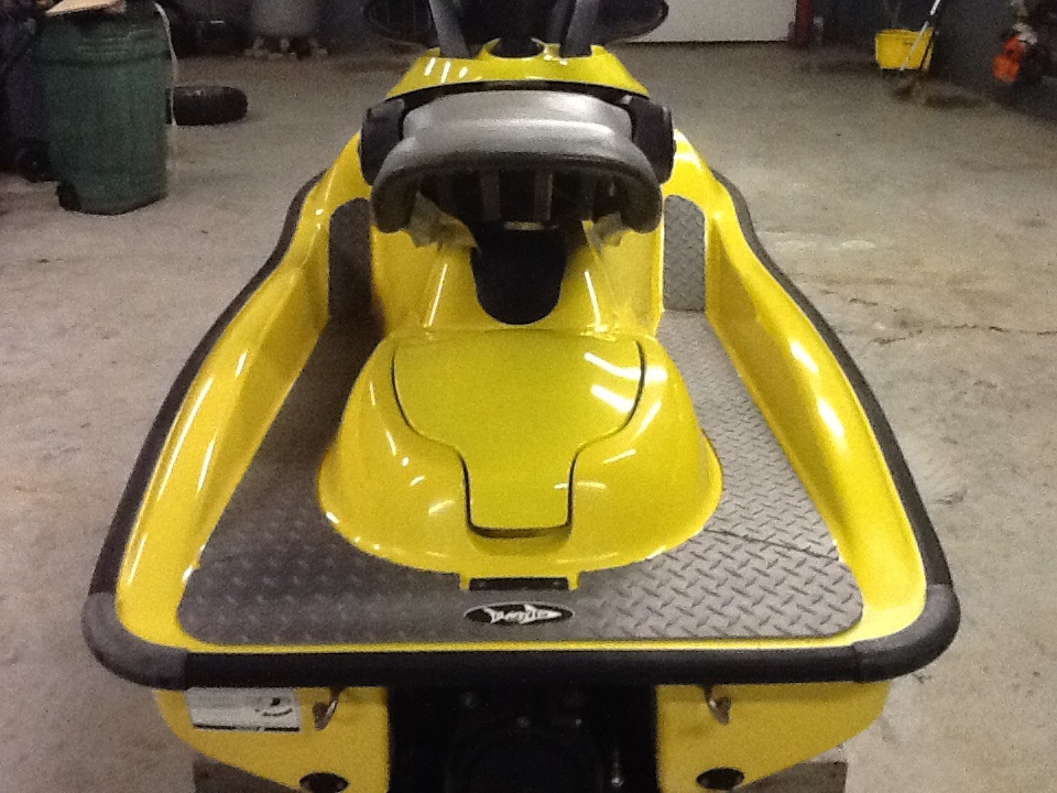

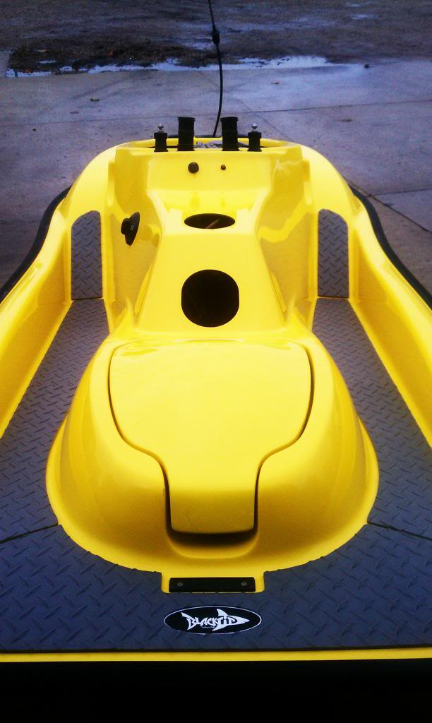

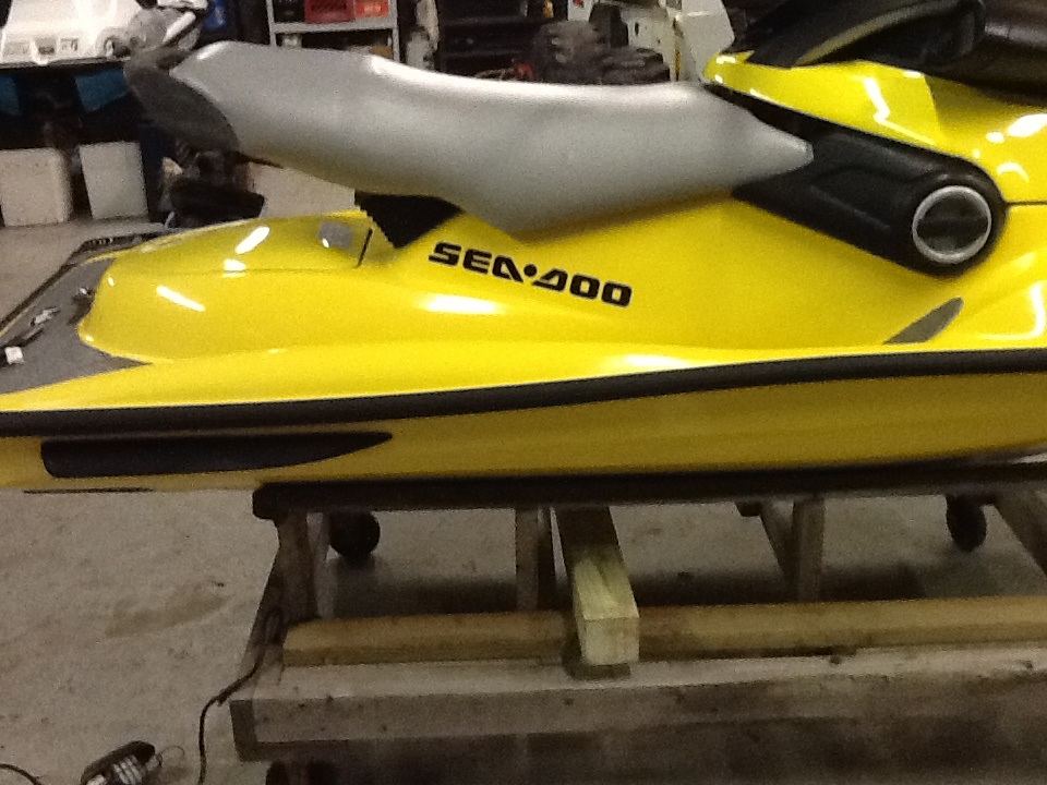

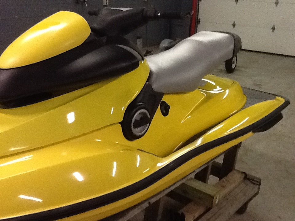

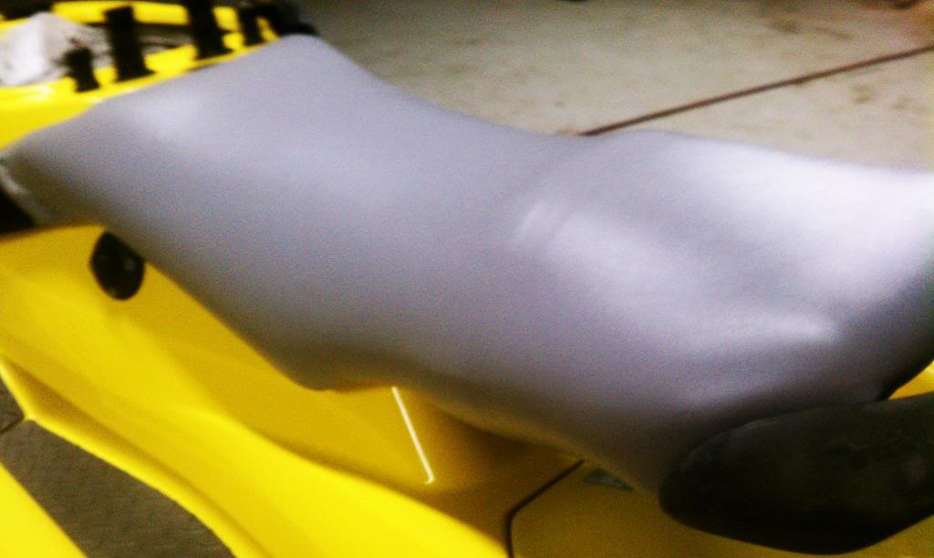

Weve been working on this for a while. I wish I had before pictures, but here is what done so far..

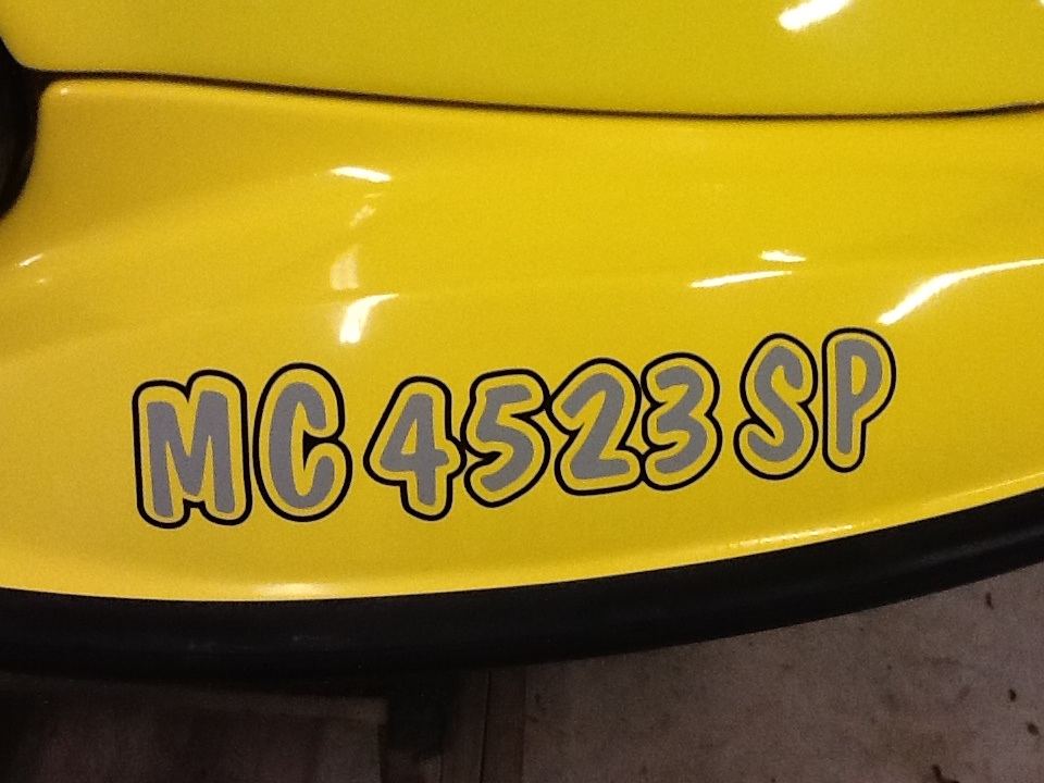

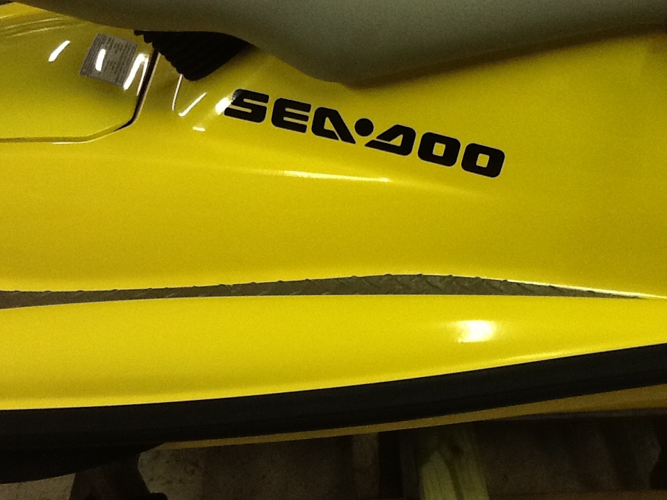

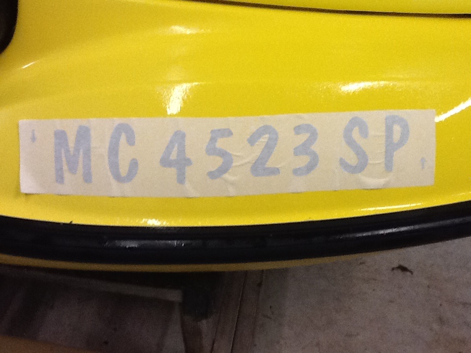

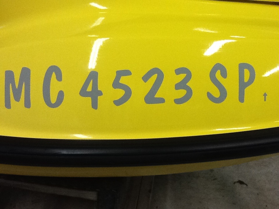

I just got in the decals from Tony today
Here is the install
The head pipe is out getting welded.

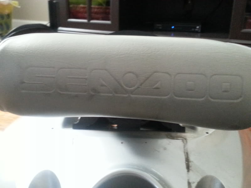

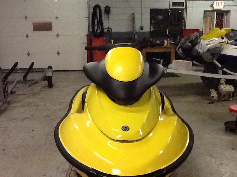

Im just waiting on the new hood to come in.

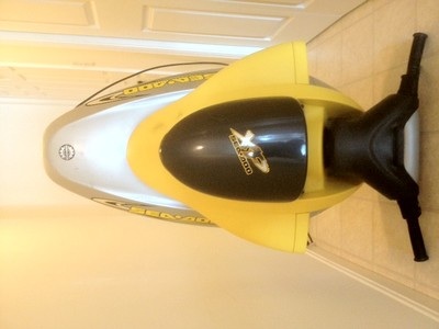

Here is the hood im getting. Im going to take the grey portion and swap it out for the yellow piece on this one. I think the grey will just make this look sooooo much better.
We were going to put it up for $2000 but my brother saw it in the warehouse and wants to buy it, must be his tax returns talking lol.
2k is about right for a northern ski, but its nice to be able to pre-sell it :)
I had the exact model, was about 95% as clean, and had non functioning gauges, and I was barely able to squeeze 1650 out of it on a trailer.
personally I like this model (and the 96 for that matter) without the stock decals, stripped clean, and a few stickers added back on.
I just never really liked the wishbone hull with a 787, felt sluggish, I liked the xpl's more because of the nice top end it delivered. Your bro might find that a prop will add quite a bit to the hole shot. My biggest complaint about my 2001 xpl was that it would get so hot in the storage bin (right over the engine) that my ham and cheese hoagies used to turn into ham and cheese melts !
But I really like this hull for long river cruises and such, and it handled the chop very well also, I just couldn't get it more than a few inches out of the water when jumping a wake.

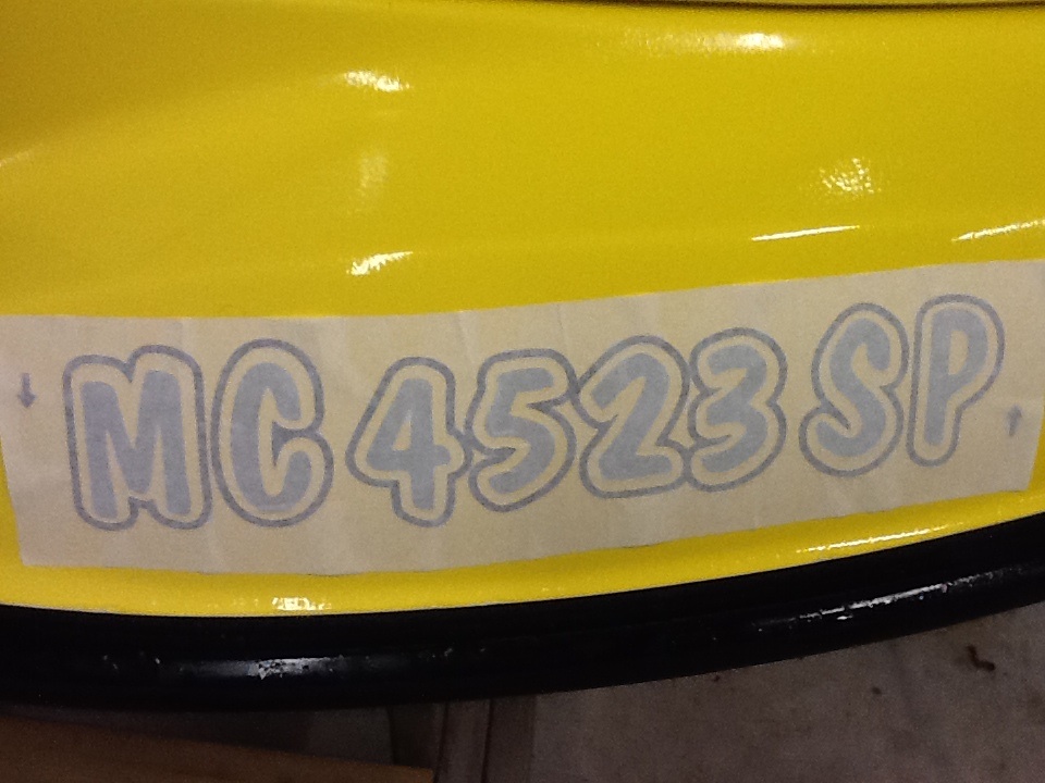

I have a question. I have noticed that in some of your rebuilds, you put the registration stickers on them. Why do you do this? I know in Missouri(where im from) whenever the ski changes owners that you are assigned a new registration numbers and have to put new decals on them. Is it different in Michigan?
in Florida the Reg #'s never change, i "think" its the same in Michigan, the only thing I ever did as a seller was to not put the Registration sticker (with the expire sticker on it) even if I had one, that way the new owner couldn't just ride the ski while it was still titled and registered in my name using my registration sticker, and never get around to doing his paperwork, more of a self protection thing than anything else.
and on a side note, i thought it was weird to see you install those stickers as two separate sets of vinyl, usually when I order stickers, even outline ones like that, they are on one piece of sticky. That must have been a trepidus moment getting that to line up perfectly on the 2nd part of the install, I don't have real steady hands, it would make me jumpy.
Once a watercraft is asigned a registration number here they stay the same forever, we just have to get new tabs every 3 years, it is a square sticker that goes on the end of the numbers. As for not using the registration sticker, that doesnt work here. The tabs transfer with the seller, just have to make sure that the buyer signs the title in front of you and you get a copy ofthe title signed and a copy of their id. Plus getting reg#s that match everything make the buyers really appreciate the build, I feel the reg numbers most skis have look cheap.
Putting on the second later is very easy, you just spray a water/soap mix on the area after the first one goes down, the second one the mask becomes tranparent when it hits the water so you can line it up perfect just by simply sliding it around. The water allows you to slide it around like warm butter on bread. If i get 1 color they are on the same mask and i only have to put down 1 peice

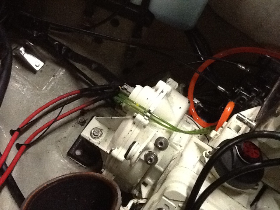

I hauled off and bought myself a 100' roll of that orange "fuel line" off ebay. It's complete junk! The fuel around here had it hard as a brick in two weeks. I thought "that's OK, the fuel system is done, I don't have to fool with them anymore anyway". But a leak formed that first season. I don't mean from pulling them off the nipple and putting them back on cause there is none of that with the stiffness. I mean all on it's own without being harassed. Your not clipping it back a little and returning it to the nipple either cause it's too stiff to seal. I'm just using it for vent and water lines now.
The fuel line, I use on mine too, I havent had a problem YET. I like it because i can see the fuel going through it. I get mine from fastflowfuellines.net I know some guys say its not coast gaurd approved. If you read the sticker that I dont remove from the back of the hull, it clearly states this vessel does NOT have to comply with coast guard laws including FUEL systems. It is not a pressurized system so it is not needed. Anyways I use it on mine and if its good enough for mine it is good enough for the ones I sell. I know some of you guys have had problems in the past with it. I go through my carbs every spring and those were put on 2 years ago and still no problems. I dont run anything special either, just premium gas like im sure all of you run as well. If I do start running into problems I will change my ways though.

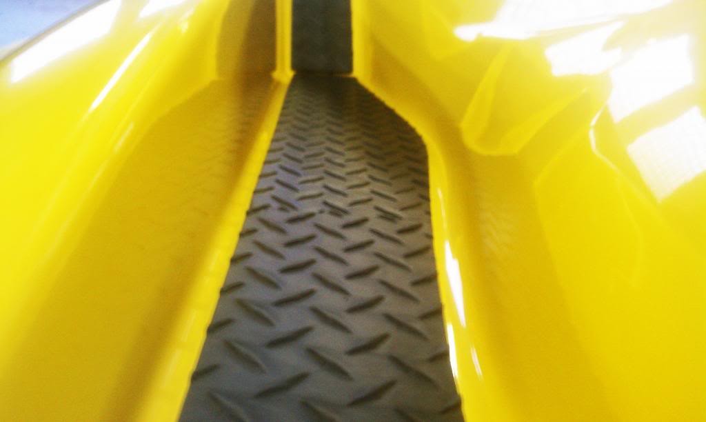

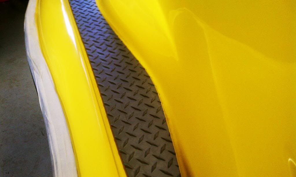

Got the MATS from watercraft superstore, they are just blacktip, grey diamond plate. Got them on black friday, 50% off free shipping. That was a huge thread started in nov.

The hood is on a greyhound bus now coming from Maryland. So should have it soon. Shipping it on grey hound was $75, usps qouted it at $180. The head pipe is back on. The only thing left to do is swap parts from the hood. I will be selling all the gauges off of the 2000 xp hood, I will also be selling the top half of the hood and the steering cable. The only thing we are keeping is the bottom grey portion of the hood and the handlebar pad everything else will be for sale.
