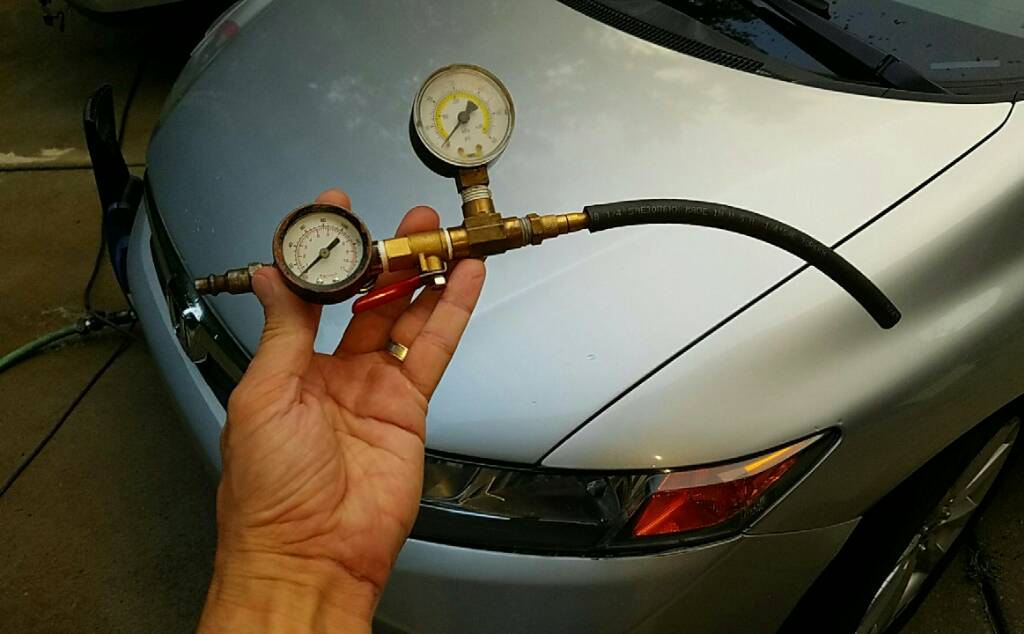

You need to make sure you're blocking off the return line and putting pressure to the feed line (arrow pointing into carb). I usually just hold my thumb over the return line, as the test doesn't take very long. Once the carb is assembled, do the test again and make sure the needle holds at least 20psi. It should hold close to the pop off pressure if I'm not mistaken. If it leaks early, you know that your diaphragm is pressing down on the needle, or it's defective. A defective needle will never yield a good pop-off test as it'll just leak. It will not give you that clean, crisp POP at the desired pressure.
I built my own tester from Harbor Freight parts. It's cheap, but very effective, and can be used for all sorts of other applications, like pressure testing auto coolant systems, or pressure testing testing crank cases. It consists of a Pressure Regulator, a Tee, a gauge, and a valve. The point is to be able to regulate how much air you're allowing to the carb from your compressor, and to be able to close it off and watch it leak down. The valve must be before the gauge obviously.
