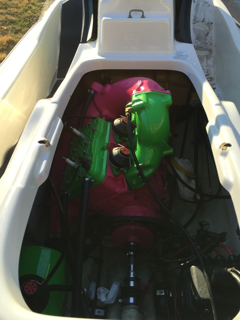

With that pink and green paint, I don't see that the motor will have any issues starting. It will scare its self every time you try to start it. :eek: If you got the carbs right and the raves and rotary valve are like they should be, then that thing should just start. Pull choke, crank and braaap. A primer would not hurt I guess, but I don't see the need. You would just be hiding some other issue. Mine were tough to start until I did the carbs correctly.
Nice work by the way. Looking forward to the finished piece.
Hahaha you know you love the pink! Haha, awesome ok great. I will leave it as it is. It was my first time pulling everything apart but I did it by the books so feel it should all be good. I think most of the previous start issues were a combination of all the broken things, battery was always dead/carbs pop off was wrong/dirty filters/hole in water bellow/leaking exhaust fitting etc. Lots of little stuff. Crossing my fingers but I will just keep the choke in place then. Thanks for the info!

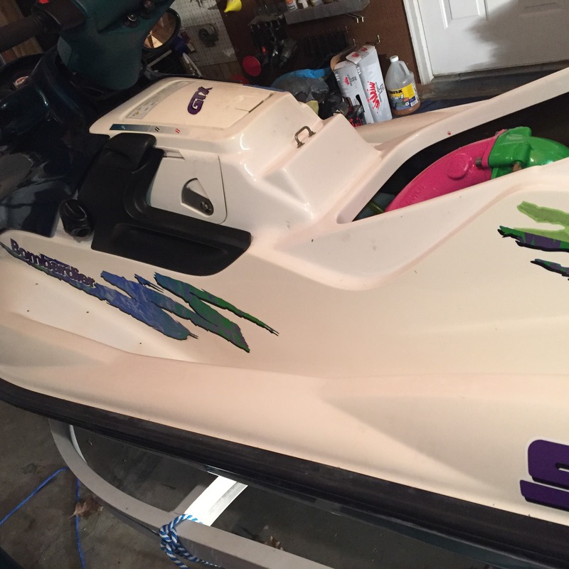

Hey guys, I started removing the mats today and was curious what is recommended to use to seal those holes? Just any type of sealant, or bondo?
I cleaned up the sides a little but I ill get out the scrub brush after the holes are sealed to clean it up better before laying down the hydro turf.

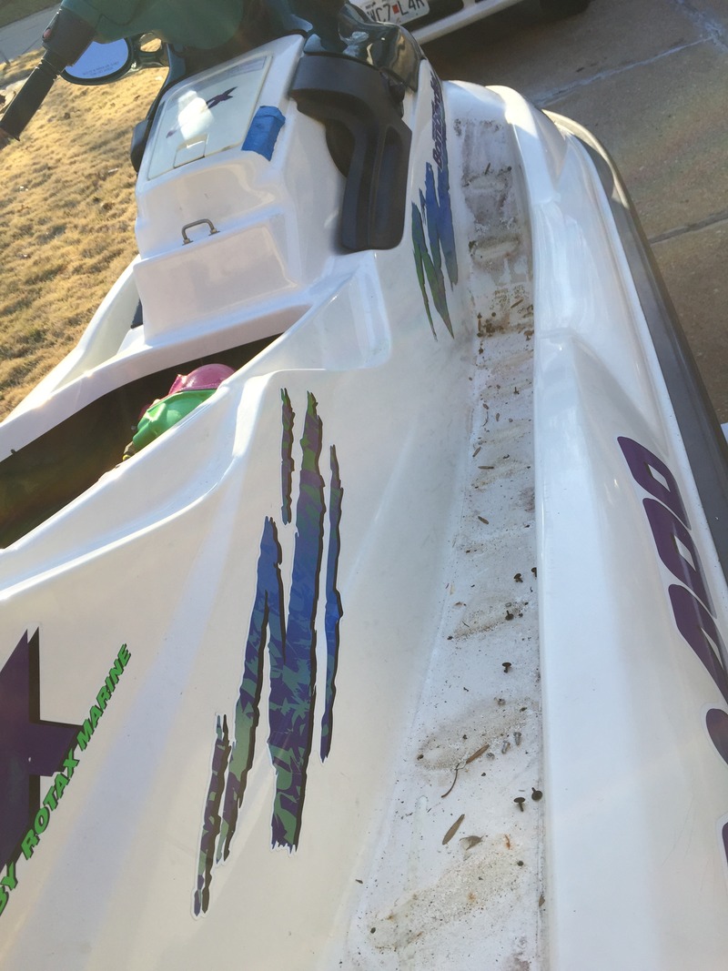

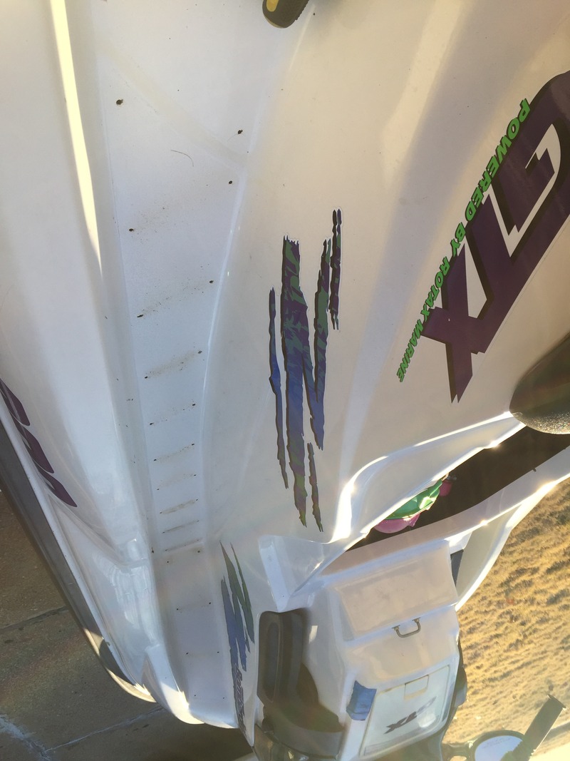

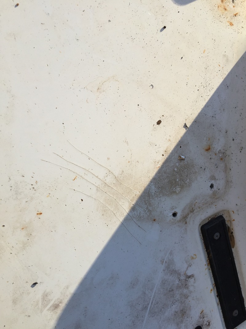

I also found some spider wedding in the back area shown in the pictures. Think I should bother trying to fix that somehow?

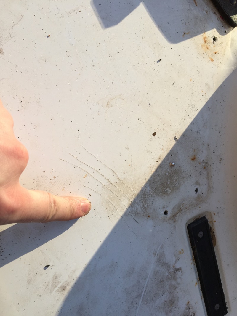

Some small cracking
Wiped down a little
Honestly I found the green buffs out weird. It shines up well, but it ends up vary mottled if it had a bunch of scratches originally. I could not save the bottom of my Shamu ski so I ended up painting it. The white cleans up well with compound, but you likely will need to wet sand it first. The white gelcote is really tough stuff. If that spider web area is the only area, I would consider leaving it and just buffing like seadoooaddiction suggested. It is a lot of work to repair correctly and match the color back. I think RacerX uses the expression to never under estimate the value of a strategically placed sticker... Just use bondo or epoxy to fill those holes left by the mats.
That crack is under the traction mat. So that will be covered. Spim uses that expression about the stickers, but I always liked it. Lol
Ok awesome thanks. I figured with it covered no biggie but wasn't sure if I should worry about trying to strengthen that area or if thats just considered normal wear and tear at this point. Thanks guys, I should have the new mats installed tomorrow, then going to throw the carbs on, tidy up the inside, run a few misc hoses left & then start working on shining her up!

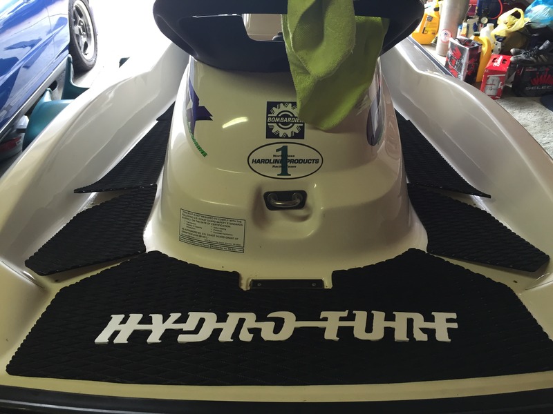

All mats removed, holes filled with epoxy & cleaned up the foor boards. I laid down the rear mat and decided I do want to wax/clean all of the white before installing the rest of the floor mats. Mostly don't want a white ski with darker white/yellowish between the new mats. Haha might be OCD but its the best time to clean it up. With that being said I started taping off the decals on the ski I plan to keep and started removing the old ones.

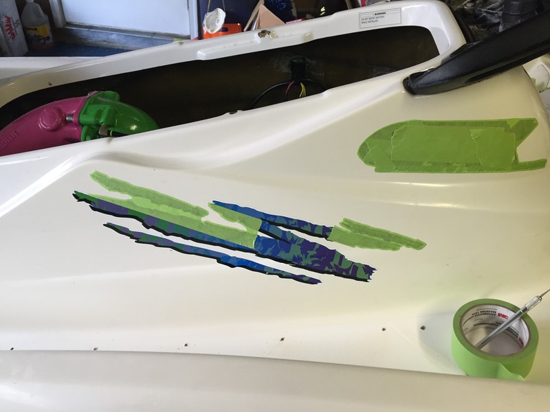

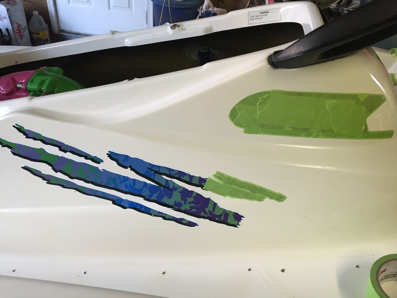

Ill order some meguiars once I see what I have/dont have. The masking up of all the decals is really going to be the time consumer lol. Tedious work for sure! I am keeping the main body graphics as they are in good shape but the front registration letters and some torn rear decals will be removed and replaced. I will also be removing the hood for some vinyl work this week. Still debating on what I plan to wrap/not wrap but I will have a better idea once the hood is off and dissembled.

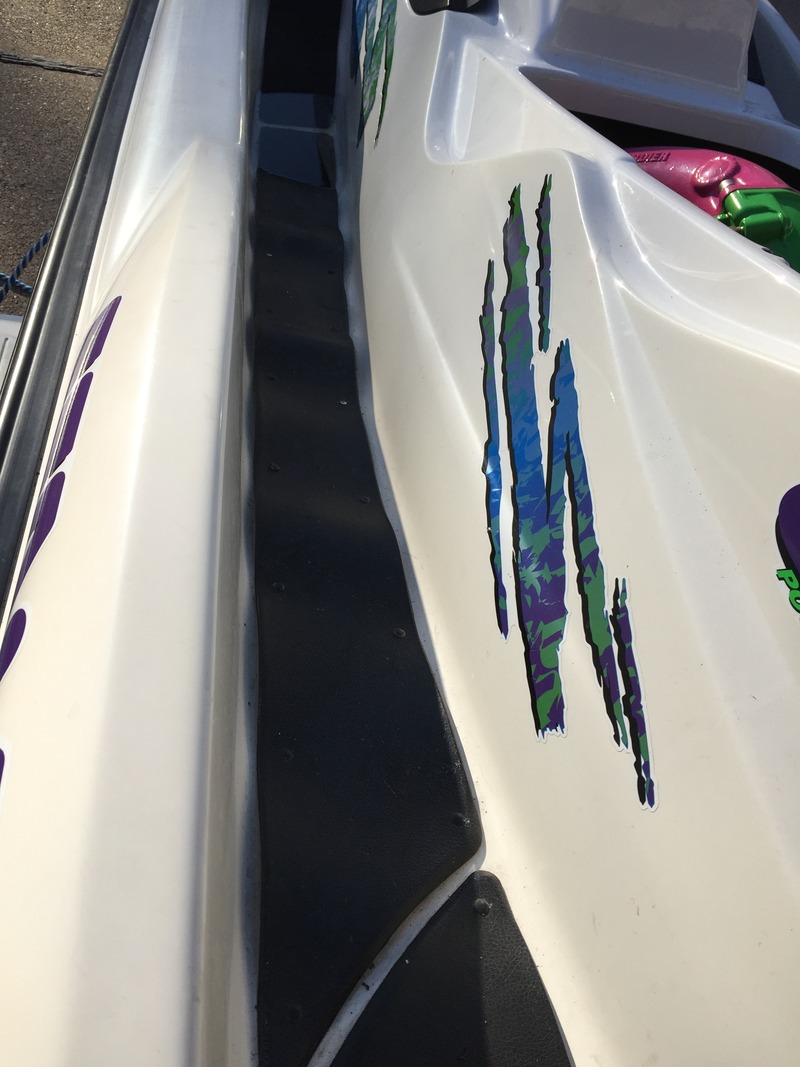

Well taping all this up should be fun lol. These graphics are huge and a PITA. I am just tracing the outside with a blade....slow process. I am wondering if wet sanding will actually be required on her, the white really isn't that bad. I think I am going to try the aggressive meguiars compound first w/the mid/aggressive pad first and see how it does vs starting with wet sanding. I just really, really hate wet sanding lol.
The GTX I posted in the other thread I never taped the decals up. If you do the wetsanding by hand, you won't have any problems with the decals @ 2000 grit. Don't let the buffer catch them with a heavy cut compound on them or they'll burn through and smear all over the place.
Your boat, I wouldn't even wet sand, I'd just hit it with the light compound and get the turf on.
Oh ok awesome. So with the fine cut compound I also wouldn't have to worry about burning the decals? Obviously I can be more careful around the graphics just curious, that would save me at least an hour or more from taping all those off haha! Just checking! Thanks so much, I will buy some of the fine cut meguiars and some finishing wax today and go to town.
Sorry for the noob question haha. I usually only hand wax but I did get a nice porter polisher I have been itching to try out.
Just pretend everything will burn through the decals. Then if it doesn't you'll be happy.
Better safe than sorry!

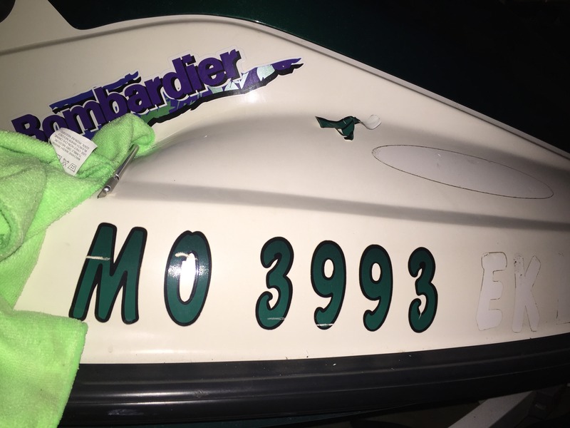

Started removed the decals "I am going to keep the stock decals". I thought about removing them all and changing up the scheme a bit but the seat and everything is in good condition as well as most of the decals. I am going to remove the hood and vinyl wrap it in some dinoc black CF material, paint the middle grille satin black & leave the top cover on the hood and side mirror green and see how it looks. I may also wrap some small center pieces in CF such as the glove box and side plastic panels but I am going to do the main hood first and see how I like it.

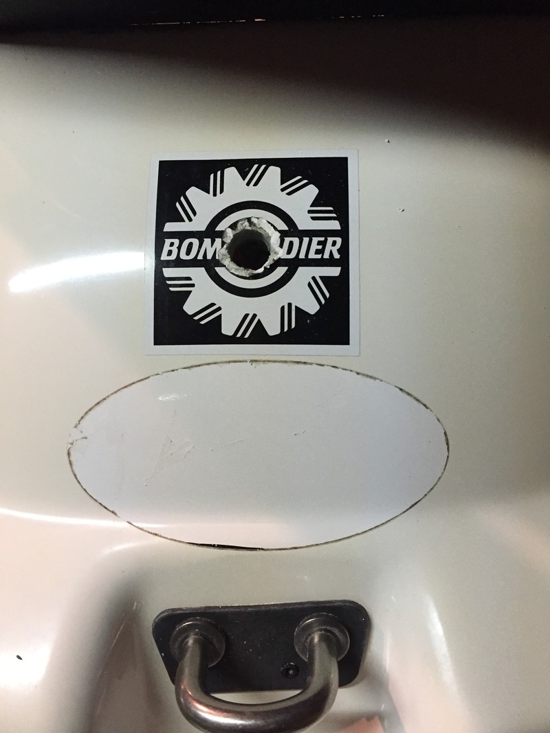

Monday starts the polish/wax process. Also need to find a larger drill bit to finish drilling the hole for the plug for the bilge pump.

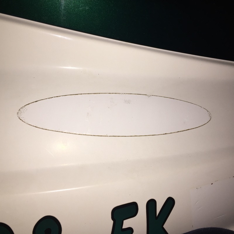

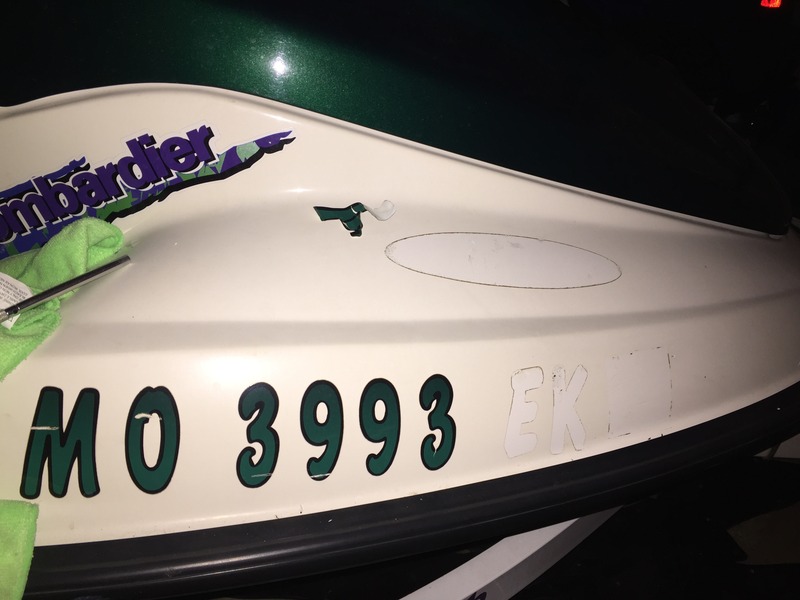

Sorry for the bad quality pics, was working in the garage when I got home after dark. Minimal lighting at the moment LOL
White really isnt too far off, I am going to start with the fine cut and see how it does first. I also have a fine cut pad from chemical boys.
Hole started but not quite bit enough for the plug

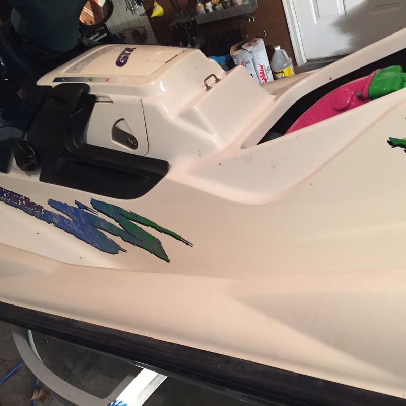

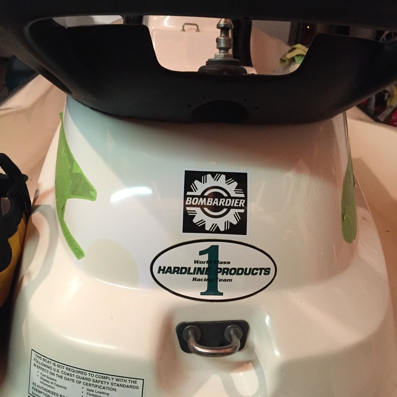

Ack. That's pretty yellow. You might have to sand that.
Dang I hate sanding. I'm gonna try the light compound and see how it does. Maybe switch to the heavy compound and heavy pad. If neither works well I suppose I'll suck it up and start sanding. Haha I dread sanding
If I am stuck sanding I'll probably remove all decals and get something made up for it later on.
It literally takes an hour. Get some brews, a good CD, and enjoy the time :)
Lol, I have hours into the hood on my HX, and even more on the hull and deck. I didn't keep track of the days I have into my 95. If you can sand an X4 in an hour I'll load a trailer up and pay you $150 an hour to do a ski with a 1 hour maximum per ski.[emoji12]
