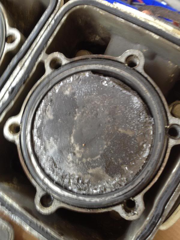

96 XP PTO PISTON in peices , WHY? Pics inside
Rosie2514
PTO Piston
Head
Is this from oil issue ? Lean issue ? Or what?
I'd like to hear your opinions . Motor is currently getting completely redone since it is long over due anyway .

Ive seen similiar cases and this looks to be a lean issue, did you clean your fuel filters/ internal carb filters? did you replace your oil filter often? most people say the oil pump is bullet proof.
Looks like a lean condition and the piston was in the process of MELTING from excessive heat caused by too lean of a mixture for that cylinder. You will probably find some aluminum on your spark plug too, (which by the way, is a very good early indicator of leanness, IF your lucky enough to find it early)
Yea there was aluminum residue on the plug . Carbs were cleaned last year . So there is no telling what could have made it's way in the filter since then. The oil pump filter was never changed lol

I don't see lack of oil evidence here. When that happens everything looks grey and dusty. Is the rave valve chipped?

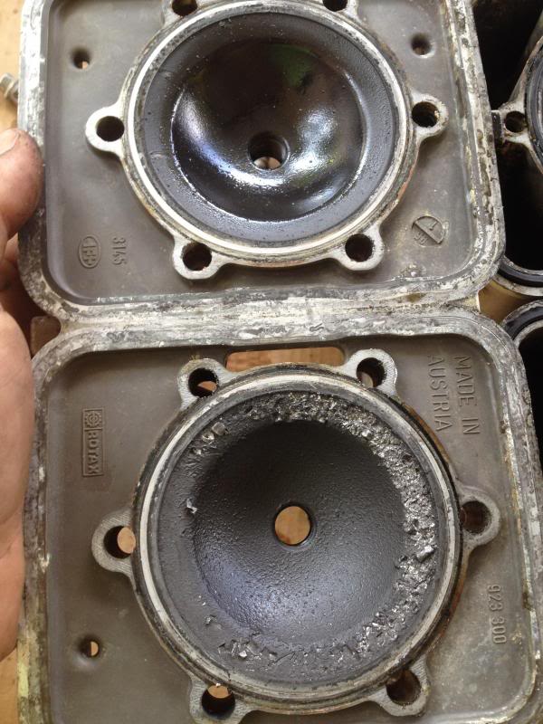

I'm thinking detonation possibly, lean on fuel since the oil was there? That's the exhaust side of the piston so it would get hotter and possibly detonate the ring land. Just make sure you go thru everything. I know you not starting the debate but pre mix wouldn't have stopped that just because the oil is there, the fuel is what would cool the crown.
Rave valve has some little Knicks .
Top is pto side
Also , that is not rust. Just a reflection .

I am on board with the lean fuel answer. I have rebuilt several snowmobile engines that had this same exact destruction. Piston gets hot & expands larger than it should be & the hottest spot is right in front of the exhaust port. clearances get the tightest in front of the exhaust port & the land breaks off from the binding.
As far as color, the color of a scattered piston means nothing. they all turn grey once they grenade & you can't tell spit from it anymore.
Here's a picture of a piston from an engine I rebuilt a few years ago. This was the good side. When I pulled it apart, I found the crown had no piston wash at all, evidence that it was running lean & hot. If you look close at the pictures, you can see where the ring groove is pinched tighter. basically the land is mushroomed & fatigued right in front of the exhaust port only. This piston was headed for sure destruction just like the one in your pictures.

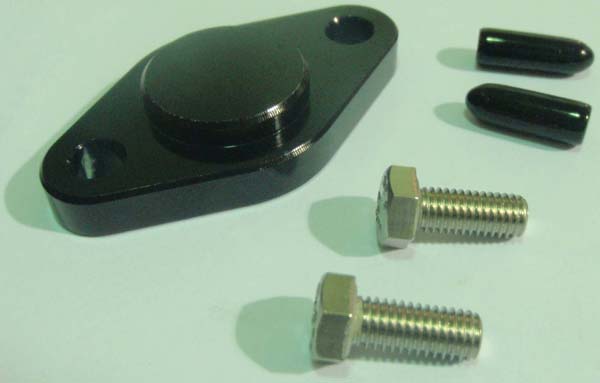

Just take one small line and hook it to both nipples. If you buy the kit it comes with two little caps to plug those fittings and a cover for where your oil pump was
I have never seen the kit, but does it have some sort of breather for the RV case? just curious.
I know racer, the reason im going premix has nothing to do with my motor blowing up lol
Premix just makes more sense for my application is all. Personal preference.
No prob, I have no issues with Pre-Mix. My Speedster is set up for pre-mix, it's easy. I did it when I kept gagging the MAG piston on the one engine in the Speedster and swore it was oil related, came to find out it was an air leak killing the engine. But now, I'm done with pre-mix and switching back to injection. Just looking to get back to simplifying and cutting back on the gallons of oil I would go through every season. @ 40:1 I use a full jug of oil to a fill up of gas (40 gallons), so I constantly have to have XPS-II on tap. I don't mind the cost but some days I look at the $120 fill up(about a 1/2 tank) just to go for a ride and scratch my head.
Most just just leave the tank hooked up, plug the line going to the pump and install the kit pictured. race guys will ditch the tank and loop the RV from one side to the other.
