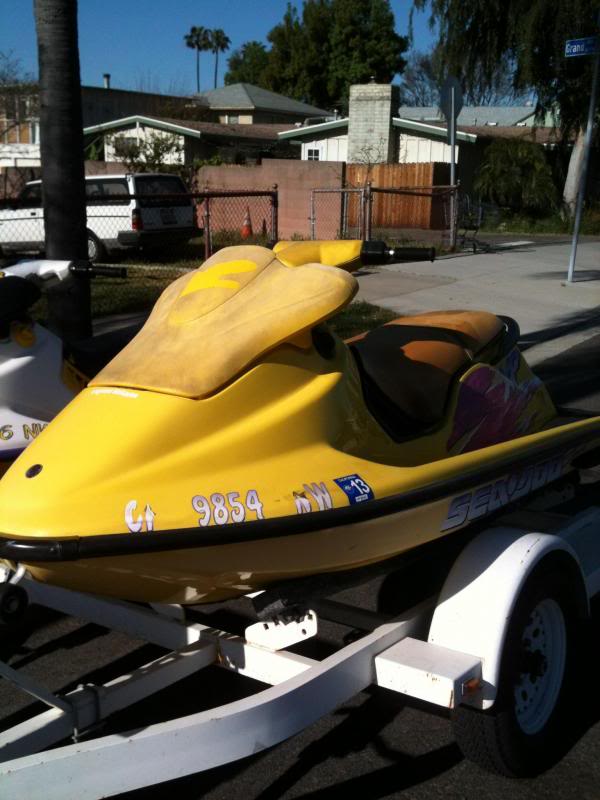

I got complete bins...with black tubes even.

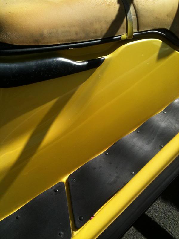

Heat decal evenly but focus heat in smaller area to start it process. Should pull off in bigger pieces.
When you heat it too much you'll see vinyl decal bubble but should pull away like rubber band until piece breaks.
Then you start over
Careful not to burn gelcote
Ty!!!! Your tips helped a lot! Got most of the decals off and it doesn't look like it needs much buffing. Since we didn't have time to get them all off I didn't want to take pictures but it's coming along.
