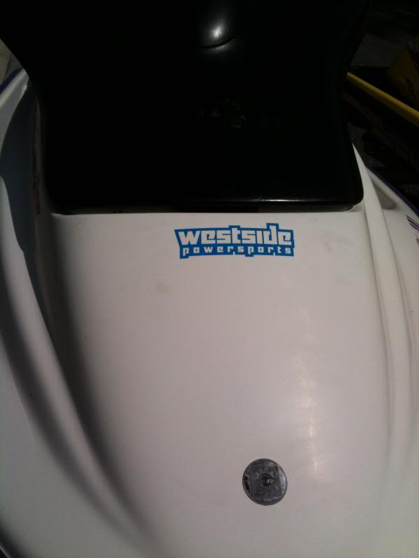

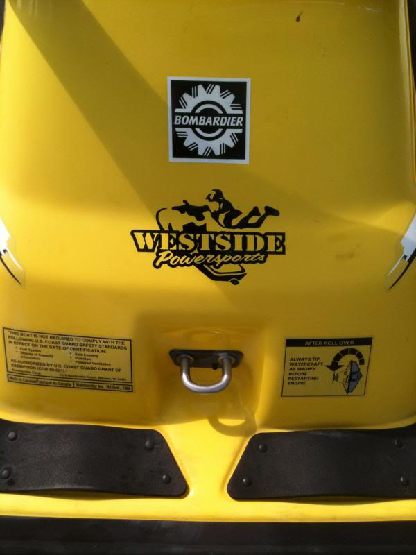

Buying some marine grade vinyl to redo the seat on the 96 XP. Its so heavy when it fills up with water it's ridiculous and I don't want the sponge to start ripping. Painting the hood yellow and trying the zippo fluid trick on the handlebar pad. Any tips on the zippo fluid trick? Also got a cheap eraser wheel on amazon to remove decals. Getting rid of all the pink on both of my XPs.
I tried using a heat gun. i can lift the corner but it so brittle it won't peel. Maybe I'm not getting it hot enough?
Heat decal evenly but focus heat in smaller area to start it process. Should pull off in bigger pieces.
When you heat it too much you'll see vinyl decal bubble but should pull away like rubber band until piece breaks.
Then you start over
Careful not to burn gelcote
I'll give it another go tomorrow with the heat gun. Thanks for the tips. I'm glad I didn't return the heat gun. I paid less than $10 for it so it wasn't even worth the drive.
