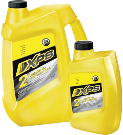

The 95 xp came with 1.25 gal mineral XPS oil that I almost finished up using. Thought it would be fine but obviously I have no idea.
The 96 I suspect has mineral oil because of the empty bottle XPS mineral oil in the trailer box I bought with it. Since I have no idea I figured I would clean the oil tank and switch to synthetic. Should I do the same for my 95 XP? I hope its okay.
Thanks Jetskigoodies. I appreciate all the help.
If it were me, I'd use the mineral oil up in the '95 XP (assuming it is PWC quality, API-TC oil) since that has the 717 (no RAVE), but most people seem to recommend the Full Synthetic API-TC in the 787 engines. That is what I plan to use (if/when I get a 787).
