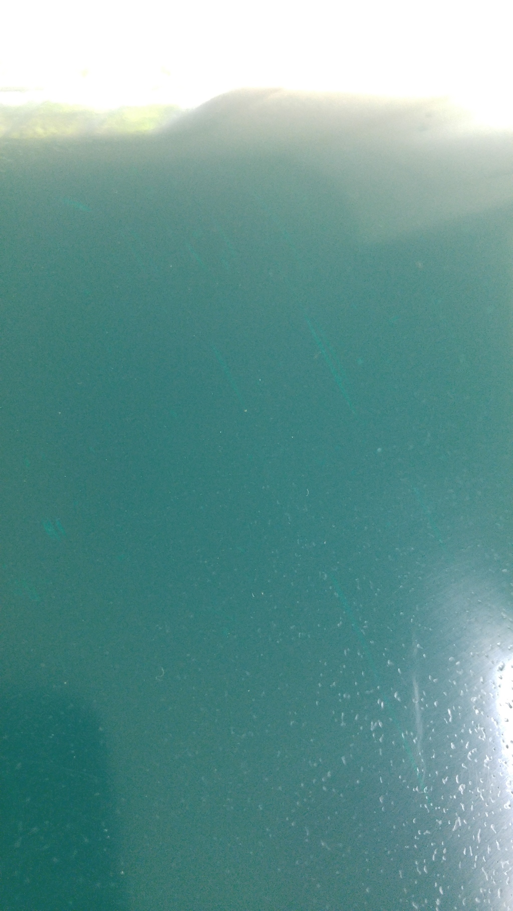

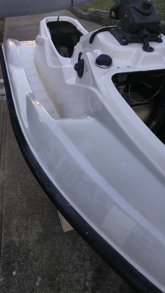

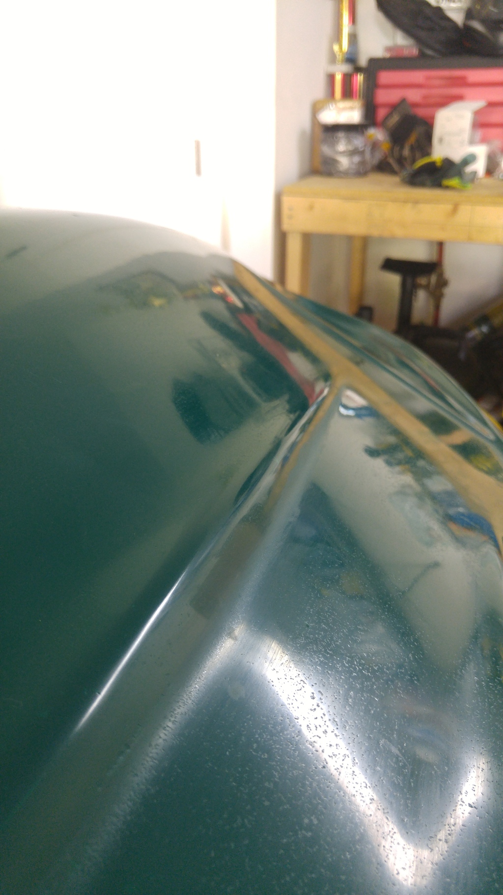

Ok so I tried to take some pictures but not really the best. I had some stuff to do when I got home today so I just had to take some quick ones. I split a quart of gel coat between the two skis but I should have done some more per ski so I could have done a second thicker coat. When up on the ski, you can see faint areas where I covered the scratches so I think a second coat would help. I think spraying it would help reduce the sanding effort need. If I were to do it again, I'd consider trying to spray it.
I think some of the areas that look porous could have used more sanding and/or a second coat. I wasn't too concerned with it since that part of the ski should be in the water for the most part :thumbsup:
Cool, that looks good for rolling it, WAY better than before. Did it set up fast? How big of batches did you mix
Thanks! I did about 150-200 mL at a time. We rolled it on about 11pm on Saturday night then started sanding it around 10am Sunday.
I used a 3" wide high density roller. I got paint cups so I could measure how much I was using at a time and so I knew how much hardener to add. Make sure to get the stir stick covered in gelcoat before adding the hardener so the stir stick does not soak up the hardener.

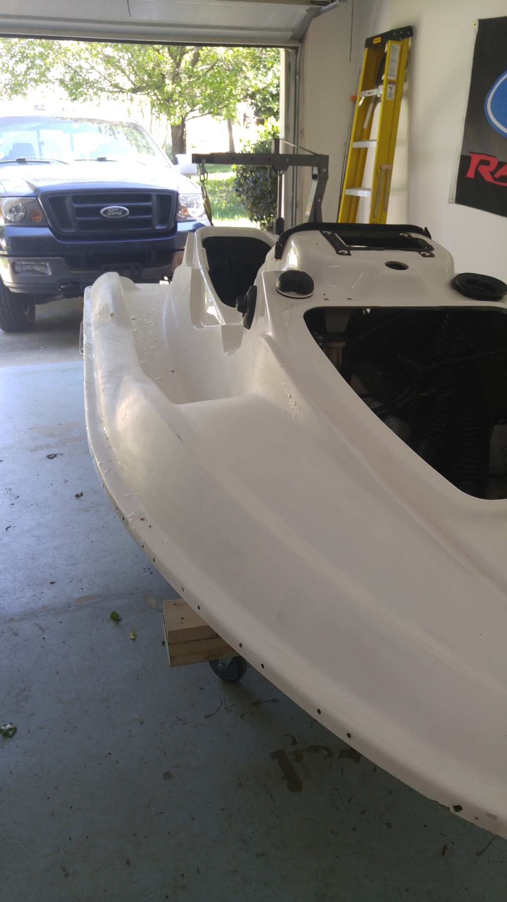

I'm currently working on the top gel coat of the 97. In the picture below (I posted this earlier in the thread as well) that the gel coat was in horrible condition. The gel coat literally was peeling off as I sanded it. I purchased the Snow White gel coat from Jamestown Distributors (P/N FIB-5700). After applying the quart I bought over 2 coats, it looks alot better. Although it looks better than before, I noticed some thin spots after sanding it with 400 grit. I've decided to purchase another quart to thicken the gel coat. I think once I'm done, it'll come out great.
Before:
Its windy today and didn't clean it off before putting it in the garage today so don't mind that:
Some of the areas still had water in the picture. The additional 2 coats will really make it look new.

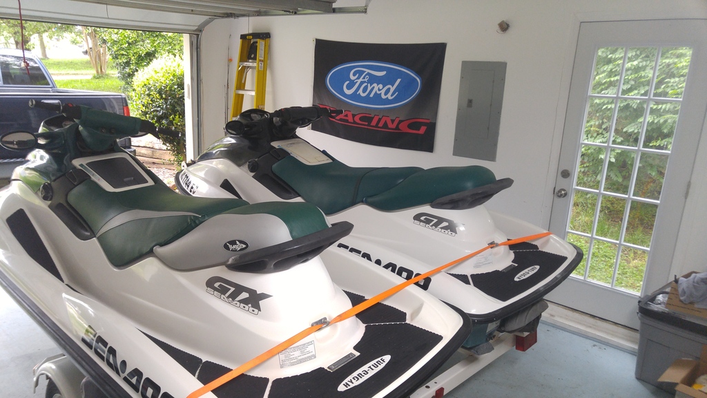

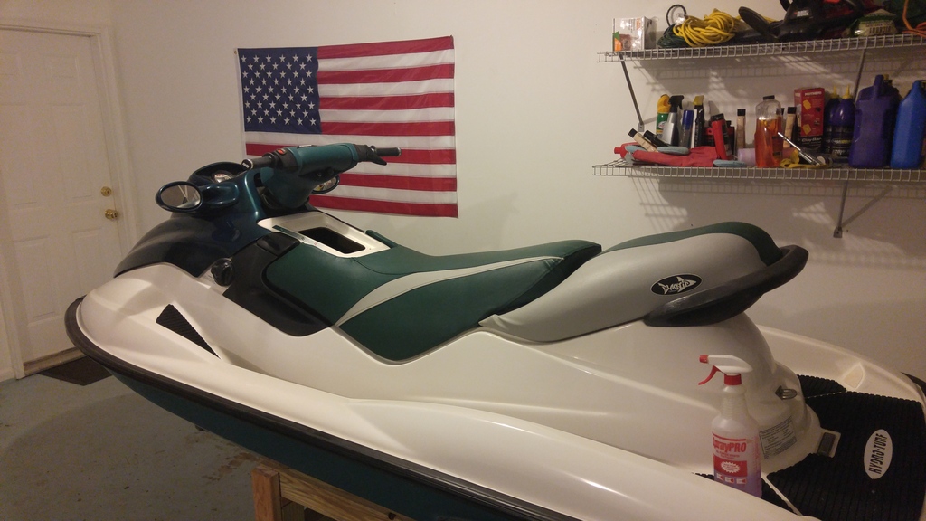

Well I got the seat covers on the 96. I just need to add some more staples, finishing some pulling in spots and do some trimming on the rear seat. I'm pretty much done at this point with the 96 until the engines get back. I'll be able to concentrate on the 97 until then as well. The gel coat I ordered this weekend should be here tomorrow so I'll start that process.
Here's the 96 with the new seat covers installed. Probably not the best job but it was my first time doing it.
Thank you! I appreciate it. It was a little tougher than I thought it would be but overall looks good. I forgot to post but I also purchased ODI 120MM Ruffian handle grips for both of the jet skis. I'll post some pictures when I get home (my work blocks Photobucket). They are a small change but definitely add to the look.

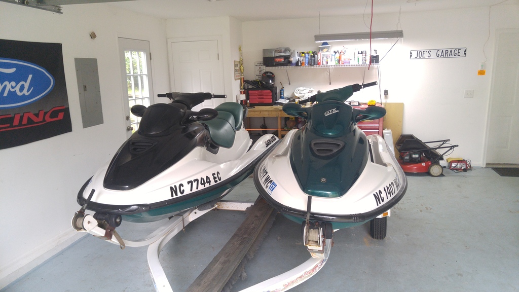

Well I feel at this point I can say the majority of the restoration is completed. There are some things here and there that I will progressively work on. I need to get them both in the lake and get the engines broke in but I feel like I'm ready for summer!
