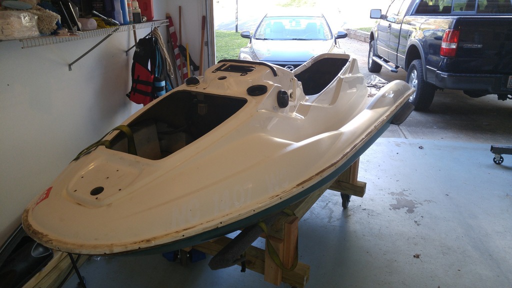

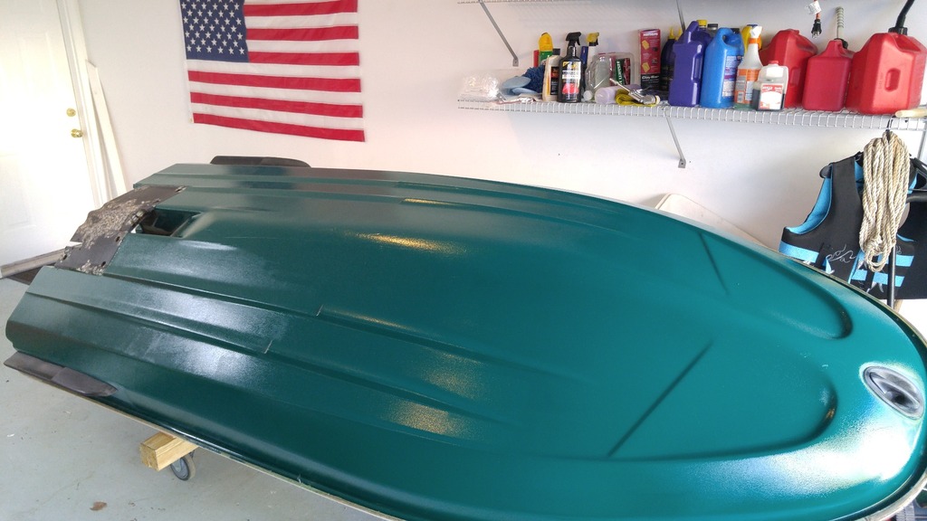

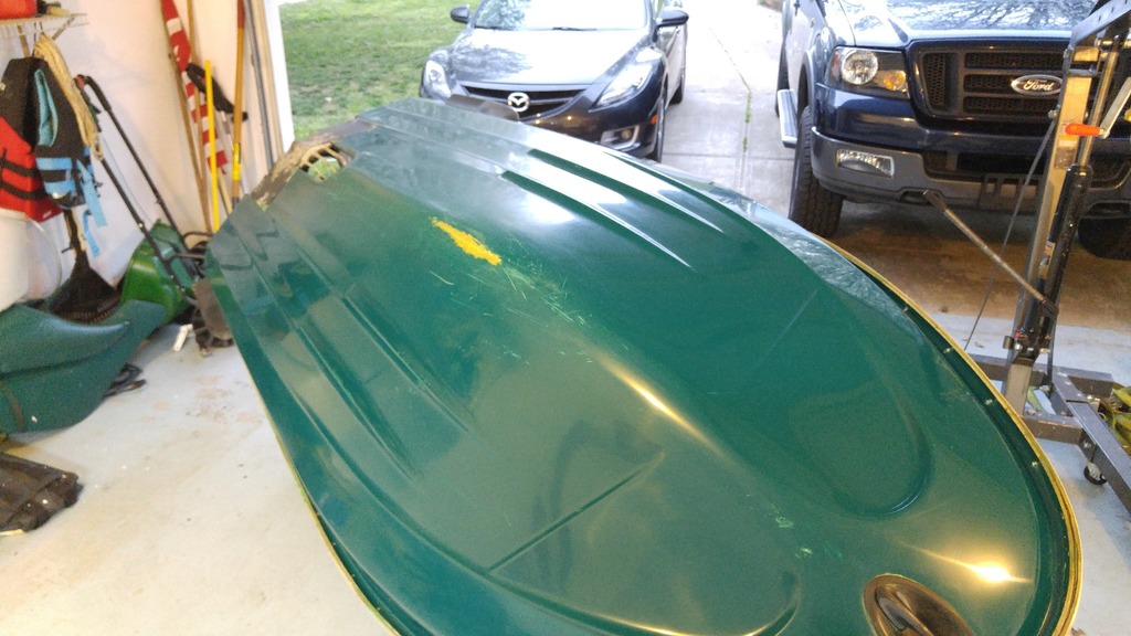

I have removed pretty much everything out of the skis except the steering cable and mpem/wires. I have turned one of the skis over to start the hull repair. I worked on buffing it yesterday for a few hours and it turned out quite nice. I have some new gel coat from gelcoat.com for the bottom so I can repair the scratches and the one area in the picture that needs it. I'm happy with the other areas how much it is cleaning up. After this one is done, I will turn the other ski over and start it.

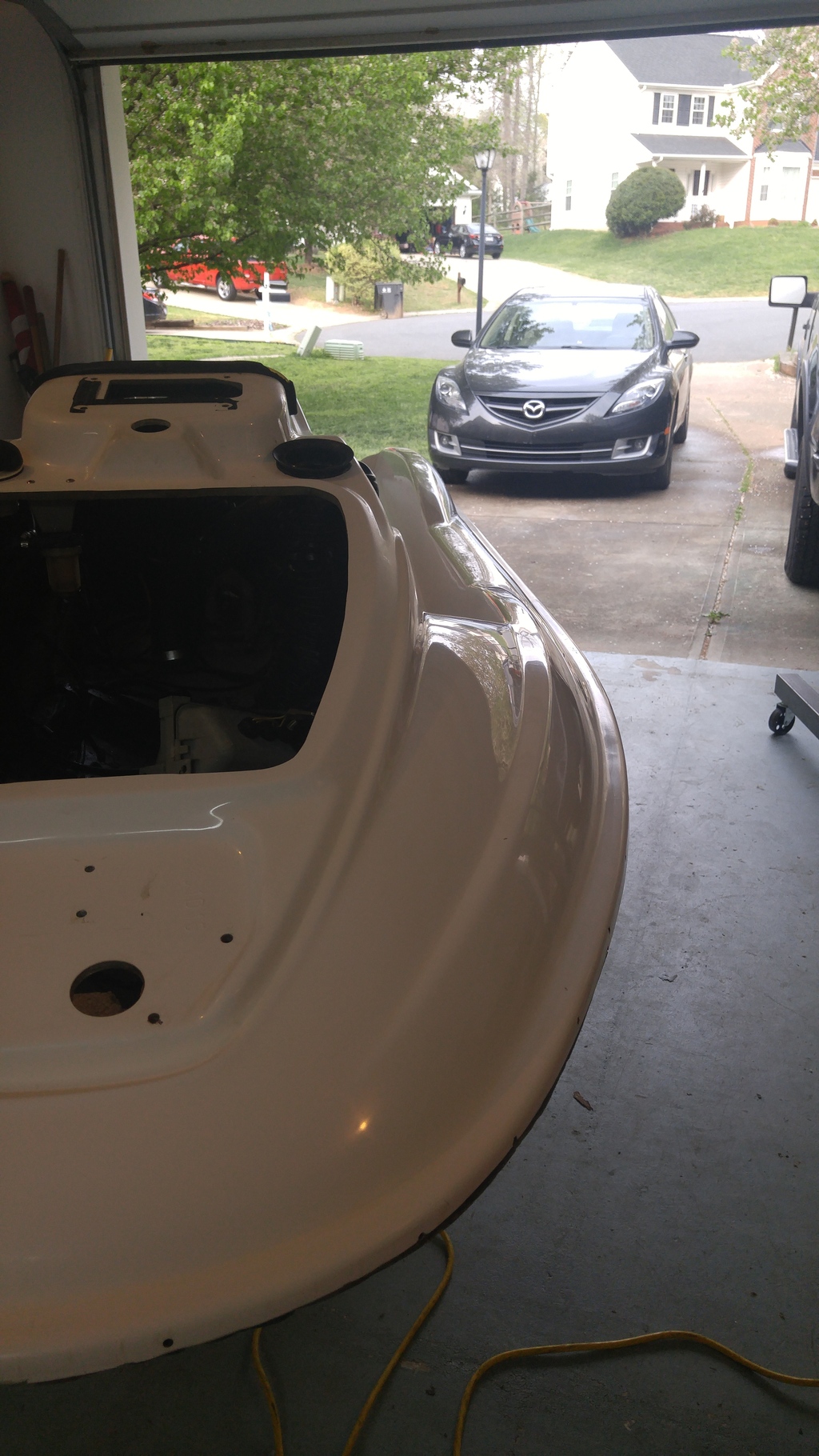

I received my gel coat from gelcoat.com on Wednesday for the hull. I worked on the 96 GTX today and its looking pretty good after applying 2 coats. Once it cures, I'll sand it smooth and buff it. I hope to get to the 97 this weekend.

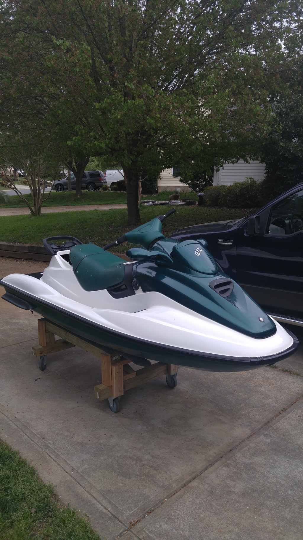

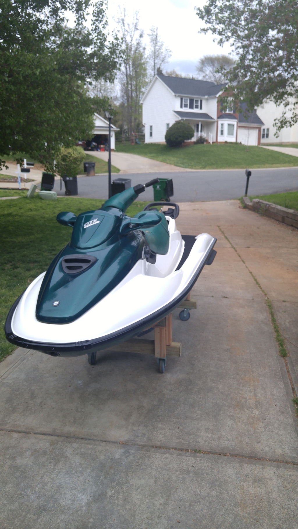

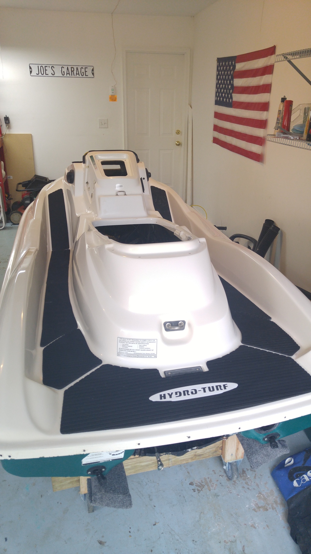

Just wanted to post another update. Still waiting on my engines to come back from SES. I've completed the body work on the 96 GTX as far as working with the gel coat. I plan to paint the bumper rails and clean the inside of the hull next. Overall the top and bottom of the hull turned out well and the new HydroTurf looks good installed. It was alot more work than I thought but definitely worth it. I'll be ready to get the 97 body work done but I think I need alittle break from all that sanding.

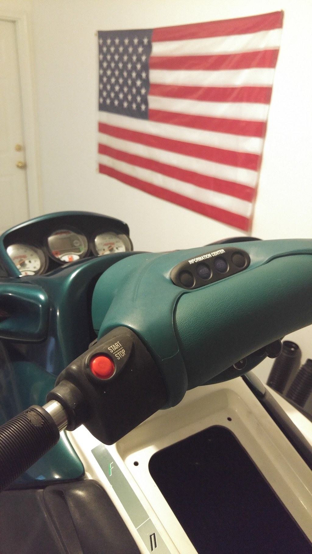

I also installed a new Start/Stop Button I got from SBT. It looks so much better than the one that was on there. I should have taken a picture of the old one before I took it off.

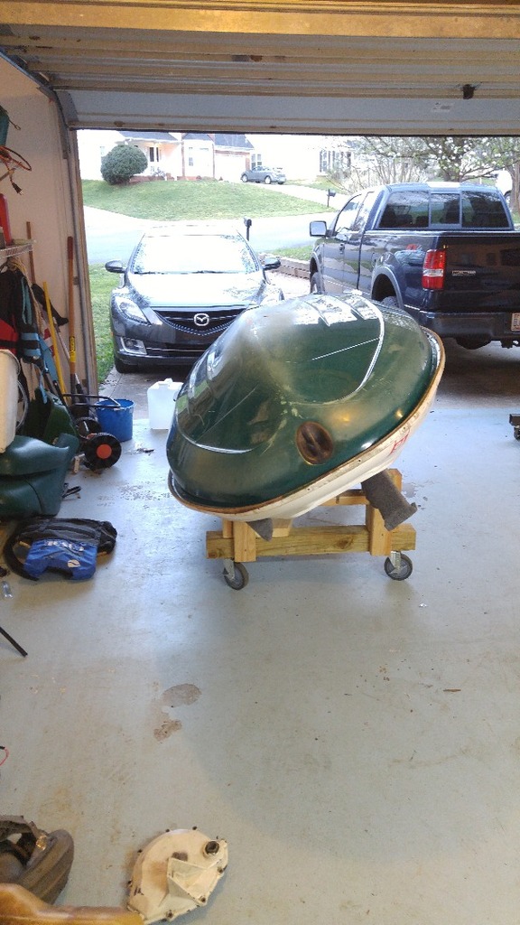

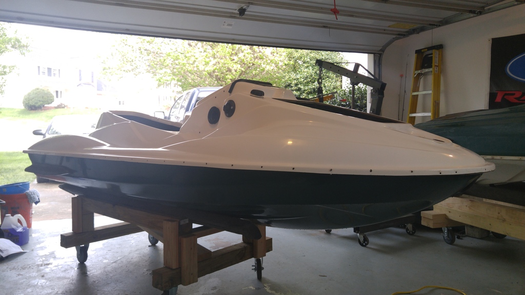

We got started on the 97 this weekend. My fiance helped me sand the bottom of the hull yesterday and today. All I need to do now is apply some wax and it can be flipped over but that'll wait for another day.
Here is the before picture on the 97:
And the after:
Thank you! I appreciate it. We put in a lot of work on it this weekend and couldn't be happier with the results.
It's amazing how thick the gel is that you can erase the prior owners boo boo's. Top notch.

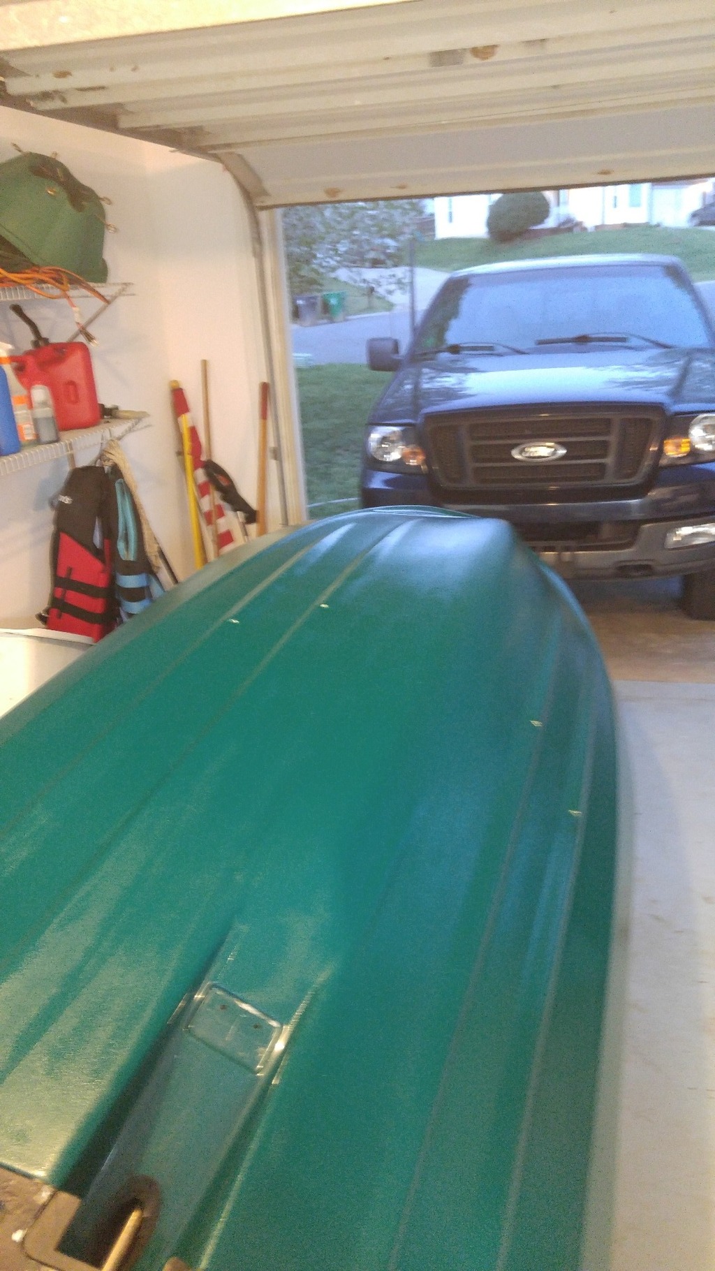

We applied some additional gel coat to the bottom to help build up the bad areas then sanded it smooth. Some of the areas were pretty bad. I'm very happy how it turned out.
Rolled it on then sanded it the next morning with 400 grit then 800, 1000, 1500 finishing up with Meguiars Swirl Remover.
