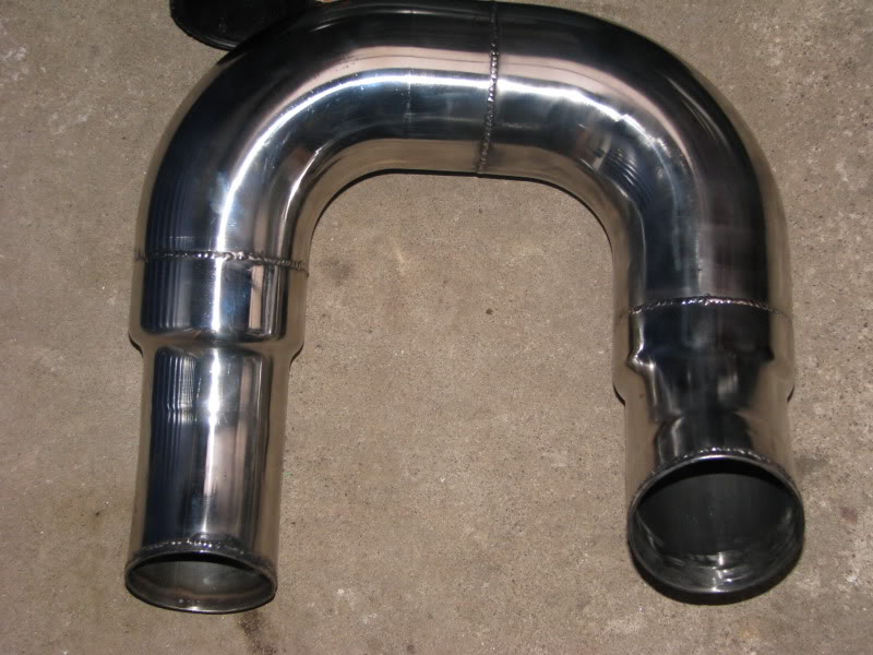

sorry to bring up a year old thread but i wish id found this last week, i did this same mod yesterday for a total cost of $0.
Using a 63mm diam 316 stainless pipe 350mm long (2.5 inch diam 14 inch long) that i got for free.
I used the joiner pipe from the left hand side to replace the T piece on the right hand side to get rid of the 1st small resonator. I chopped the ends off the last rubber hose before the main resonators to make the stainless to outlet piece.
I double hose clamped both ends of the pipe because i couldnt roll a bead on the pipe.
The idea was to retain the u bend by the fuel tank to stop to much water getting into the waterbox as advised by my local seadoo dealer.
1st test run was thismorning, sounded really good, especially when moving slowly. It may be my imagination but it felt more responsive and ran better.
Here is the final result
These are all the parts leftover. On the right next to the foam is the 2 offcuts from the hose i cut for the stainless to outlet section.
