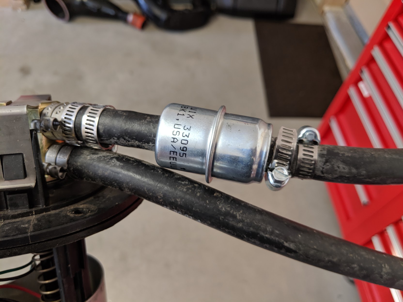

The inline fuel filter on the line to the fuel rail is not designed to be replaced per se. If you try to find the Seadoo part (which includes hoses and all) it will likely not be available or it will be $100+.
One option is to cut the fuel line as close to the filter fittings as possible and replace it with a standard metal canister fuel filter – the suggested one is Wix 33095 (available locally or $6 from Summit, with some appropriate stainless-steel hose clamps – you can either use the typical worm drive or Oetiker-style crimp-type if you have them and the tool). Now you have a cheap filter you can replace more often.
