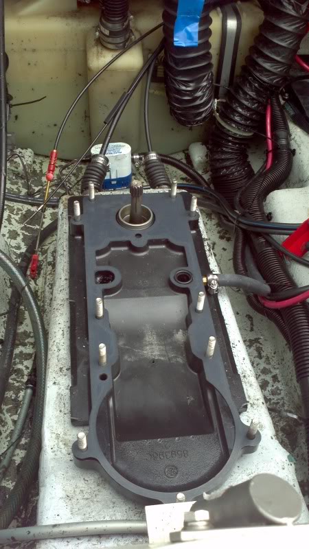

OK... you can't get the pump section out, until the engine comes off the top. The reason is... there is an "Adaptor" plate, that does the clamping, and some of the bolts that hold the engine, and adaptor in place, are cast into the lower unit.
So... from inside the hull... there are 11 nuts (10mm studs) that need to be removed, that are all on the same level. (Bottom of the engine case) Once the engine is up... then there are 4 more nuts that are a little lower on the adaptor flange. Once those are off... then you can tap the studs, to get the adaptor plate free.
But... with all the salt... it's all going to be stuck. (As you already know) But once the engine is out of the way... it will start to be easier.
Here's a picture of the adaptor in my boat. It may help you see where the engine nuts are. (studs sticking up)
Once they nuts are removed... then put pressure on the engine, using a lift... and if it doesn't just lift up... then tap it with a rubber mallet, and I'm sure the seal will give. With the salt, I'm sure you are fighting corrosion around those studs.
Once you get the engine up, and remove that gasket... you will see the last 4 nuts.
