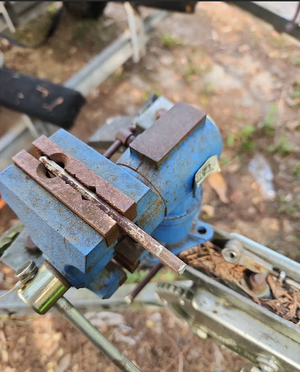

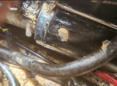

Wow, I did not realize how bad this was until I got under this with a flash light. I didn't even think to check because I did check it while the ski was in the garage on the work stand no where near water, and it was fine. A little bit of surface rust, but no where near what it is now.
Proving once again stainless is just stain LESS:
Jet pump – Google Drive
Obviously, this all could be binding. The impellar can be cleaned up a bit, but that drive shaft is F**D.
The last drive shaft I saw like that, I rode till it broke in half. It was on one of my SPX's:
SPX – Google Drive

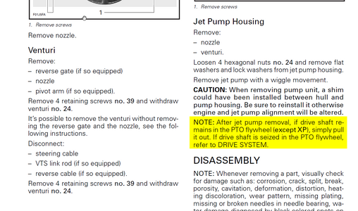

So pump first (has to come out anyway for driveshaft replacement). It "shouldn't" be stuck into the PTO because it has grease in the boot.
