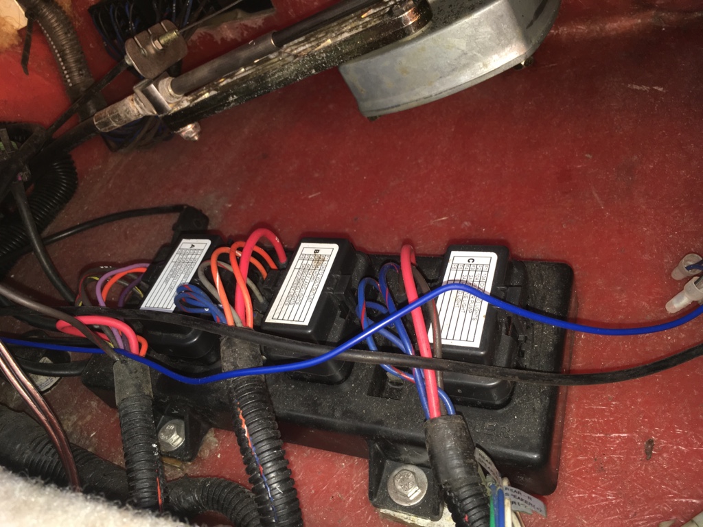

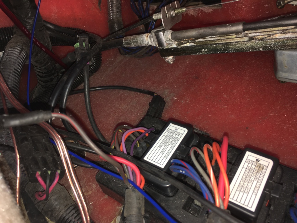

Got it!!! So I left something out... The boat originally died when I hit a cross wake, but I thought it was a coincidence... Digging deeper I found this green wore wasn't making good contact... (See attached pics) fires right up... Good to go! Heading out now, I need a drink!

4) "Throttle Guardian" (black box behind steering column) - Same thing, how do you know if its working as expected? Just disconnect it by cutting the wires and see if problem goes away.
Son of a...! So I cut the dark blue/yell wire only, on the throttle guardian and boat starts and runs great... Took it out for a spin and performs wonderfully with no issue... Throttle guardian is the problem for sure, ordered a new one...
Only issue it that now I have no tach... At least until the new guardian comes...
NO!!!!!!!!
Just toss it in the trash. You really don't need a new one. The tach should get it's signal from the engine and work fine.
I don't see a throttle guardian in my 2000 islandia. Has mine been already removed.
