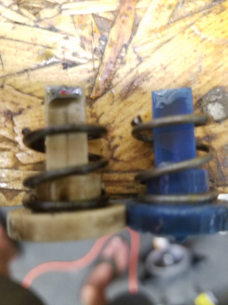

Both engines were installed and aligned. After installing the 2nd engine I realized I forgot to attach the starter cable. As is my luck, I was just starting to snug down the nut and the terminal on the starter just snapped and was laying loose.
After many many curse words the engine was back out part way and starter pulled off. This was the starter I used an aftermarket brush kit on because my 2nd OEM hadn't arrived yet. The plastic insulator just snapped in half.
Luckily my oem had arrived by now and it went back together without issue. Just another lesson in only using OEM again.
