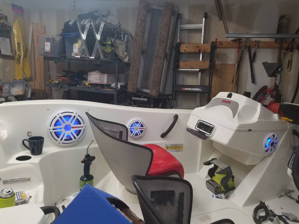

I got all the speakers in last night and LEDs wired. I need to find a good spot for an extra switch so I can control them separately from the floor lights though.
I ran out of time this morning so just hooked the speakers up to the head unit which isn't bad at 45 watts RMS but they really need the amp. I was just wanting some tunes for the lake test. I will say the front speakers are pointless where the P.O. cut them in. You really don't hear them at all, so I may need to fab up some new mounts directing them aft.

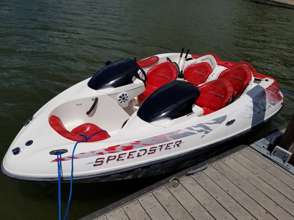

Pics. I did lose a freaking bottom cushion today within the first 10 min. I thought the gallon of oil would hold it down but apparently not. Someone had to pick it up or it just sank as I coudln't find it backtracking several times so im hoping it got turned in at the marina. Luckily I have 5 spares, but that was one of the really good ones.

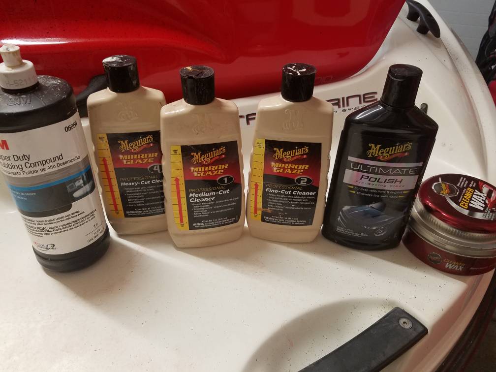

What 6 steps of compound went into polishing the hood back out? That looks great.
This was what I used after wet sanding. Probably overkill, especially since the heavy cut is probably similar to the 3M, but it works.
I used a harbor freight random orbit buffer/polisher (the porter cable type) Along with cutting discs and polishing discs.

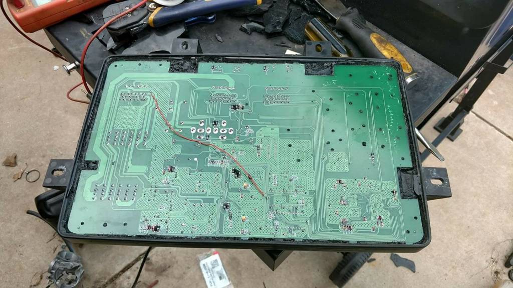

Haha, no thanks. I did happen to find the pic I saved off of Facebook from the guy that was able to fix his no spark issue in the mpem. I'm not sure which engine on his was not firing but this may help you.
It could be something as simple as a broken pickup coil though you never know. The 98s had the updated pickup so that's less likely.
^ Do you happen to know the guy that repaired this one? If my problem is the MPEM it would be nice to be able to have it fixed rather than replaced..
Haha yeah I saw your post earlier on there. That's quite a bit for a fix but I bet it's a nightmare to get them open to even begin to debug the problem.
