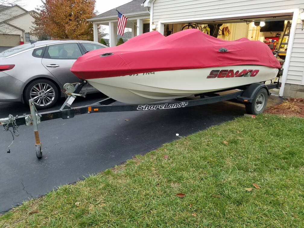

I've always wanted a 98 speedster since I first laid eyes on one a long time ago. After riding in [MENTION=82130]snikwad003[/MENTION] 's challenger on the FL trip it got me back in the hunt.
They aren't real common in Ohio so people always want stupid prices for them when they do come up for sale. I found one for sale at a decent price on facebook, but it was in Nebraska.
Seeing as I had thanksgiving week off and nothing planned I made the 12+ hour drive each way to pick it up. I pretty much drove straight there and back other than a 3 hour truck nap on the way there.

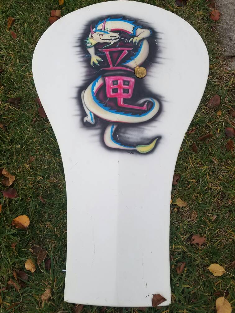

It's in decent physical condition other than some stupid stickers on the side and some hillbilly airbrush painted something on the bow cover. The fiberglass cover was an option anyways so I'm not even sure I'll use it.

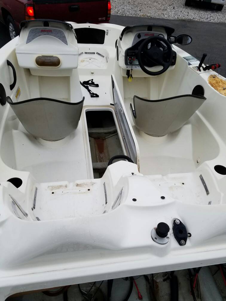

Here are pics from the CL ad. I busted my phone screen all to hell when I was checking out the boat, so was too ticked off to remember to take more pics.

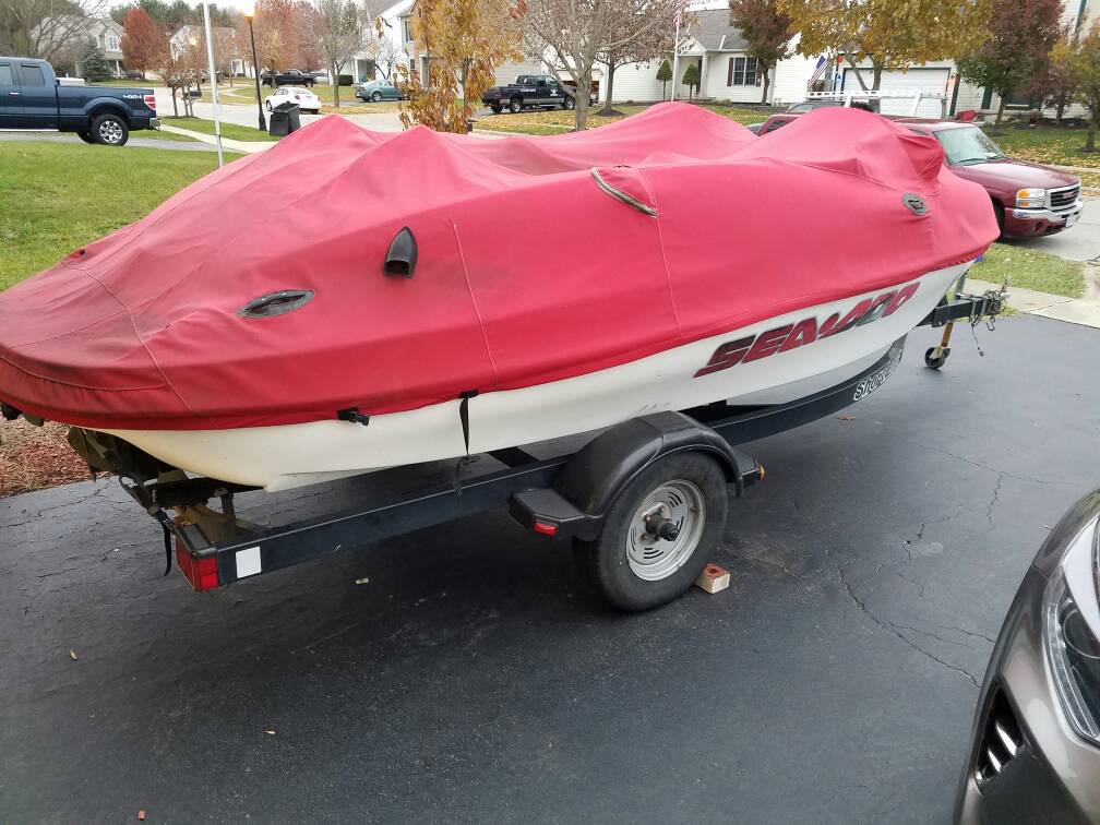

Rough drive but made it home with no wheel bearing or tire issues. I pumped the bearing buddies full of grease at every stop and I'm sure the below freezing weather helped.

Here is the hillbilly art. After I took this picture I went through a few rounds of gel stripper. It was working well until it started to eat into the gelcoat. Whoever painted it must have used 9 overlapping layers.
Looks like I'll have to sand and just paint it white. I doubt it's worth trying to re-gel it.

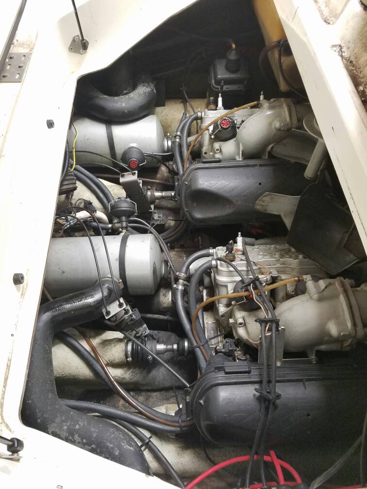

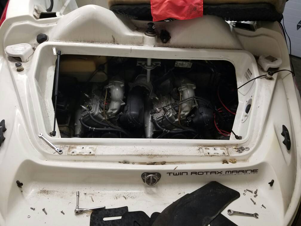

Well after sitting in the garage a few days she is all de-iced.
Started peeling the old stickers off the engine hatch and then removing it to pull the engines.

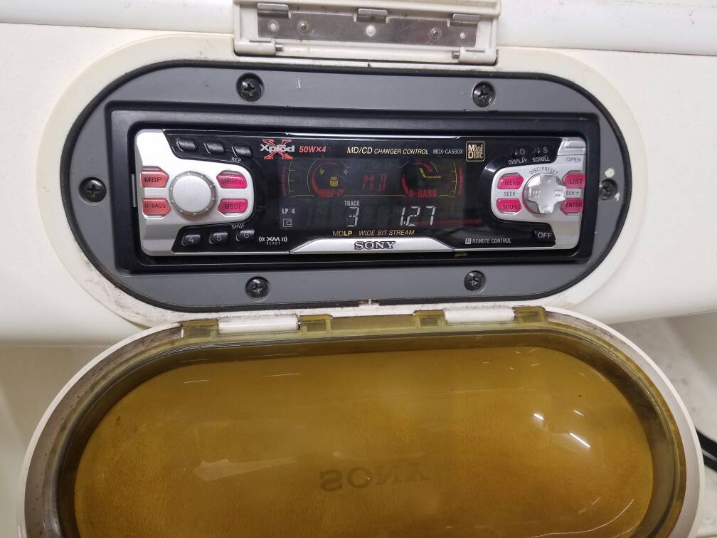

Everyone will be jealous of the sweet collection of mini-discs of hair band and heavy metal that came with it. I'm starting to understand the weird dragon thing they painted on the front.

Do these boats count hours anytime that the key is connected? Or maybe these engines are breaking some 2 stroke longevity records lol. I don't think they've ever been touched.

Whoa that is over a year of run time. I loved minidiscs, my pops still uses them a bit.
Yeah I don't get it. Rental hours says over 12k, which doesn't make sense as you can't reset total life hours, so rental should never be higher than total.
And if you'd like some mini disks and a Sony head unit they are all yours!

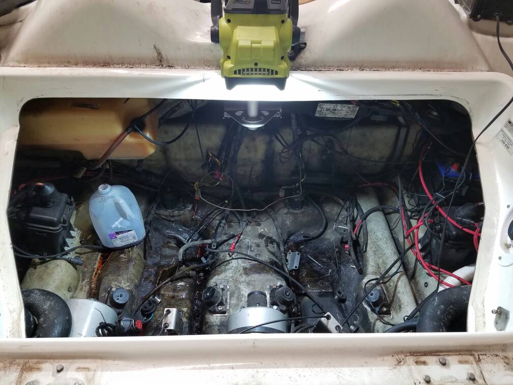

Now you guys have me thinking about vts, lol. I pulled both engines out today so now would be the time to add it if ever. I know I've already got 2 good VTS modules sitting in storage as well. Just not sure it's necessary.

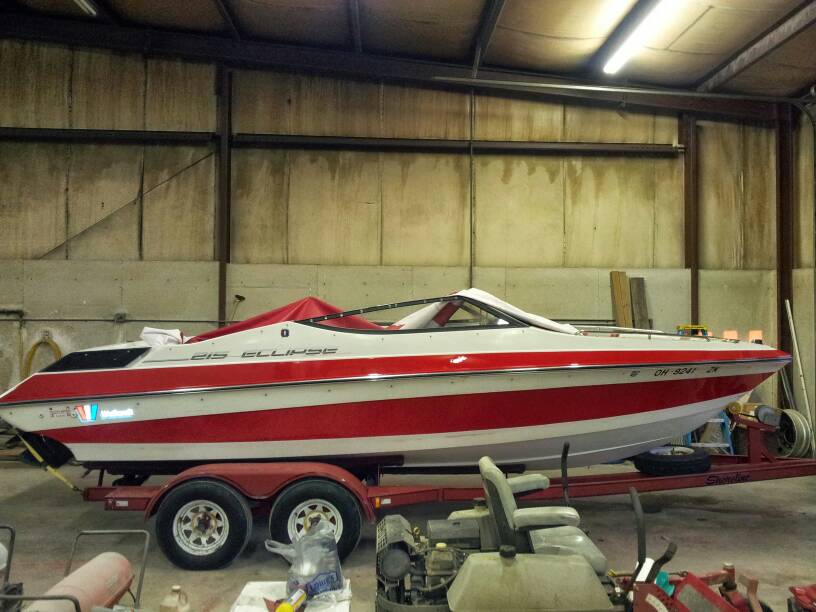

Here is the old girl after I painted the red a few years back. It was so faded and I was sick of buffing annually, lol.

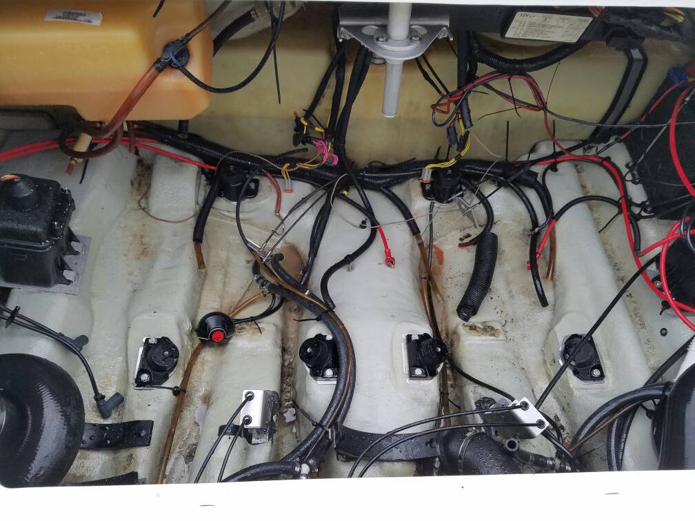

Engine bay will get the super clean treatment on Saturday since it won't get above freezing tomorrow.
It's a real pain to get to anything on the front of those engines in there. Has anyone found decent pricing on OEM new starters? I could rebuild, but I'd feel even better with brand new ones in there.

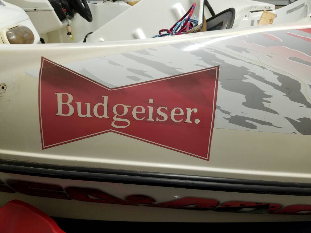

I removed more strange stickers today, not even sure what "budgeiser" is supposed to mean other than some play on bud diesel.
Also removed two sets of reg numbers because you know who needs to remove the previous owners set when you can just put new ones below them, lol.
Next I spent about an hour at the car wash and a gallon of purple power. It's at least clean enough to work on but will need one more cleaning before any reassembly.
