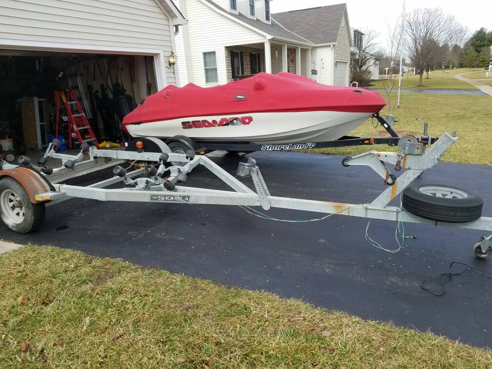

It didn't have a trailer so rather than deal with moving mine off and back on without damaging it I found a roller trailer on CL. It was 20 min from [MENTION=71213]glsmohio[/MENTION] so he was gracious enough to go haggle and pick it up for $250. We met half way Sunday morning to swap the trailer for a bunch of parts he wanted. Thanks again Scott!
The trailer was pretty decent for the price. I had to put some cheap lights on but luckily the wiring was all good. I lifted each wheel and spun them and the bearings seemed smooth so a few pumps of grease and off I went.

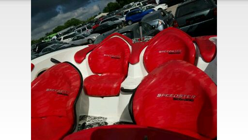

I knew this was a gamble being an insurance auction, but pics showed a minty interior so that hooked me. I pulled in, signed the paperwork and they brought right out on a huge loader with 20' forks and sat it right on the trailer.

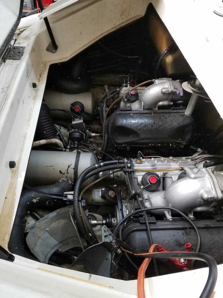

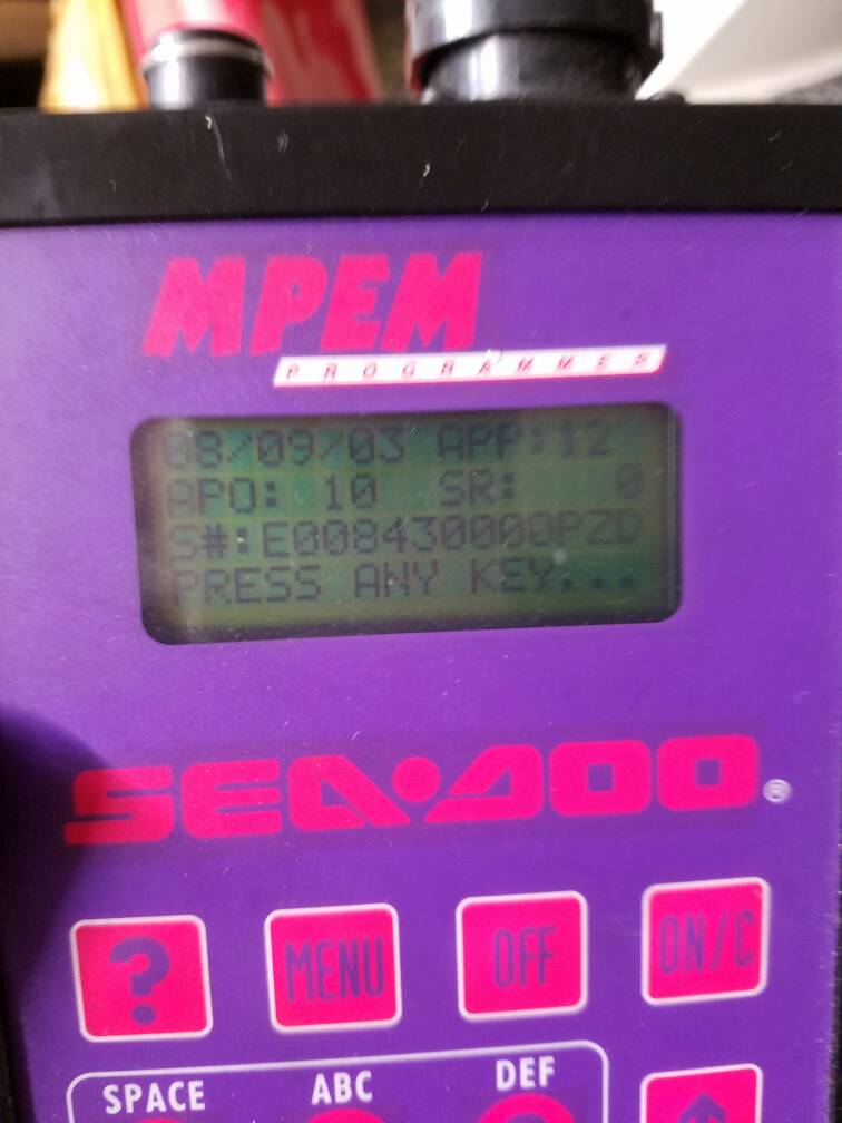

Initial inspection not so great. I think it's been sitting for about 4 years in the sun as the interior wasn't great. It's not horrible but about on par with what I've already got. I checked mpem with my programmer and got it to register then the batteries immediately died in the programmer. I then checked the engines and could hear water in them which was a bummer.
I strapped it down and headed home where I could dig into it more. At home tests Confirmed water in both engines but after programming a new key they both spun over and had spark, so I knew I at least had my investment covered. The best part is its a newish mpem from 2008.
Pulled the big hub pumps and one is minty and the other ate a rock so has some vein chips but not horrible. Someone swapped an impeller though, so one correct swirl and one off of a ski it looks like.
Overall I got more than my money's worth but was hoping for at least 1 engine being a runner. I'll finish parting it this week and haul her to the dump. I don't even have to feel guilty as its hit something big at speed so the bottom of the hull is messed up. From the lines I think it sat in 2' of water for a bit, so some idiot probably hit a sand bar or something.

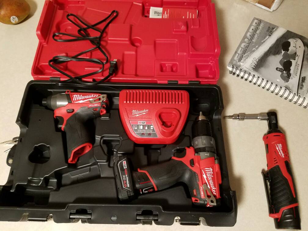

Found a great deal today at home depot to make carb rebuilds go more quickly.
I started hunting for a cordless ratchet wrench online because I hate all those damn air cleaner and carb bolts. I think I rebuilt 6 carbs last year and all those bolts are always the part I hate the worst.
So I settled on the Milwaukee 12v ratchet wrench after comparing a few and almost ordered for $150 with battery and charger. I ended up running over to home Depot to check them out first and found a great combo deal.
You buy the 12v drill, impact driver combo kit with 2 batteries and case and get to pick a free tool out of 15 or so. I grabbed the kit and the ratchet wrench so worked out perfectly.
So for $50 more than just the wrench alone I got a 2nd high capacity battery, case, drill and impact driver.
Best part is I just pulled both sets of air cleaners and carbs off the boat in less than 5 minutes. Pretty happy with that purchase and figured I'd share if anyone else is interested since it ends on the 31st.

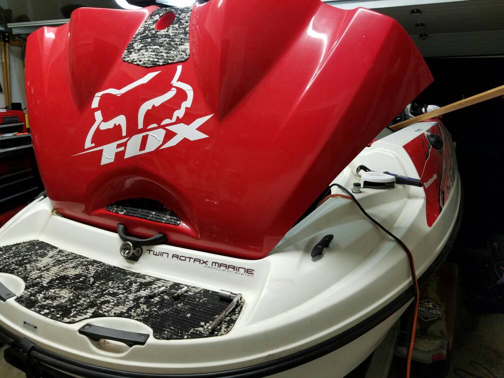

I painted the red stripe and logo with Plastidip about a month ago. Still holding good.

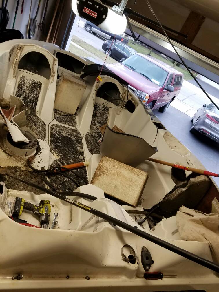

Over the weekend I got pretty much everything on the parts boat torn apart other than the ride plates. I'm going to try to get them off if possible since they are all plastic on these boats and I could see breaking one if you ever hit something in the water.
I will say parting a boat is much more time consuming and frustrating than a ski. Seadoo didn't use blind nuts on anything so every bolt has a lock nut that spins and you have to be a contortionist to get a wrench on both ends.

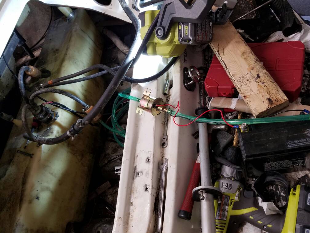

This little ebay fuel pump made getting the 20 gallons of old fuel out super easy.

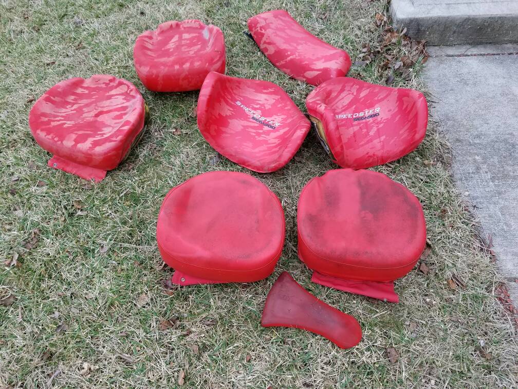

Here is most of the interior. Someone reupholsteted 2 seat bases and did a fantastic job. They are dirty but should clean up well.
