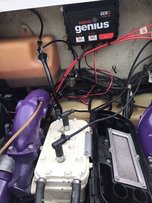

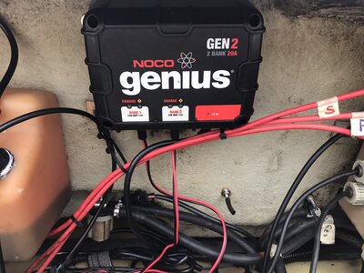

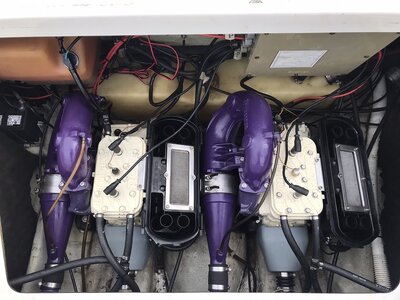

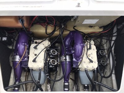

Well here we are. Finally putting the finishing touches on this boat and there are a lot of finishing touches needed for sure. I'd have to say she's READY for the water test. I had trouble removing the bilge blower. I can't believe in 25 years nobody made a video. It's easy but not easy to get to and I couldn't find anything in the manual about how to remove and replace. I'll post something to youtube shortly. I am ordering a blower to install and I have a few squawk items. I need a Tach for the left engine and I can't find the exact one thus far. I need to replace the beeper but I have plenty of those. Got the idle set, injection pumps set, we ready. :D Here are some completion pictures.
