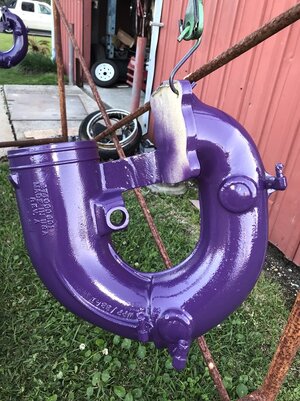

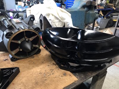

The SAGA continues. :D I ended up using a spare exhaust manifold.... thank heaven for spares and I got plenty. So I painted all 3. Gonna bring the leaky one to the welder next week. Always do a good inspection so there are fewer surprises if any at all. That is our goal. Going in with the exhaust, jet pumps and carbs really soon. Then we'll find out what's whut. :D After I get everything in place I love the final tweakin. Small things then smaller things and it gets better with every tweak.

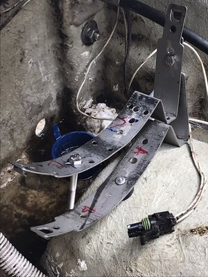

Multiply how long it should take by "4" and that is a better guess. :) I told my wife this boat musta sunk and somebody found it. :) I had to improvise a bracket to hold the right exhaust water box in position. But it is lined up nicely now. I had to so something because there was too much stress on the exhaust pipe to adapter joint. Been trying to get the port carb installed for 2 days but something always leads me astray. I almost passed it... it fell right in place. Yay !! Check out my exhaust bracket. Very sturdy and should do the job long term.

Multiply how long it should take by and that is a better guess. :) I told my wife this boat musta sunk and somebody found it. :) I had to improvise a bracket to hold the right exhaust water box in position. But it is lined up nicely now. I had to so something because there was too much stress on the exhaust pipe to adapter joint. Been trying to get the port carb installed for 2 days but something always leads me astray. I almost passed it... it fell right in place. Yay !! Check out my exhaust bracket. Very sturdy and should do the job long term.
Nice work on the exhaust brackets.
