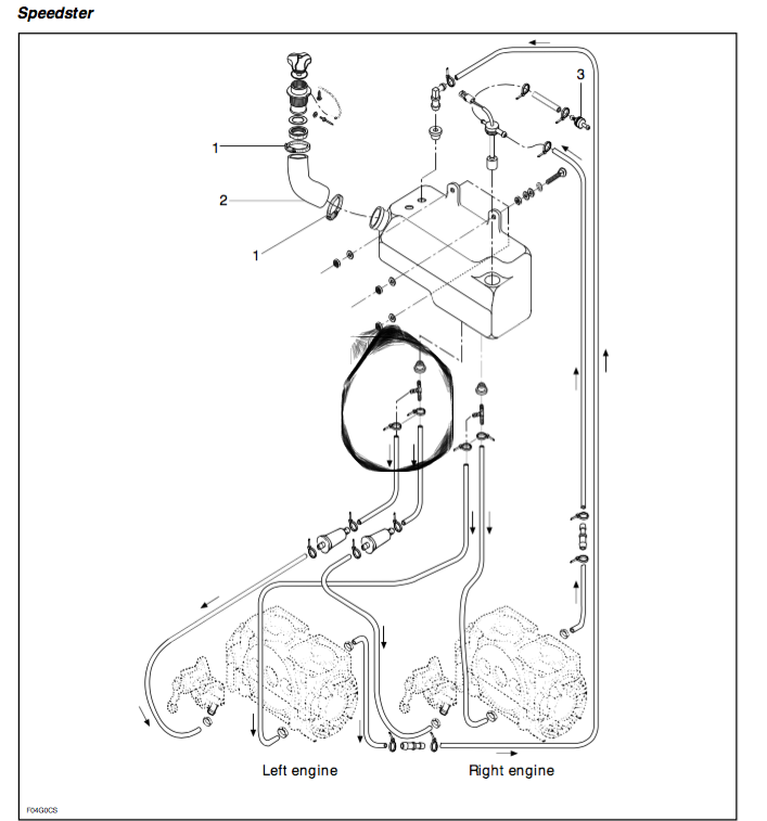

Just bought a 1996 Speedster.
Really eager to take it out, but want to take care of all the minor issues first.
I have attached a diagram of the oil tank and circled the area where the issue is.
The previous owner has disconnected those two lines from wherever they attach to and has simply connected them to each other. So in essence, they run from the bottom of the reservoir and do nothing now.
What are those lines supposed to be attached to? Why would the previous owner do this?

Those are the oil feed to oil injection pumps below carbs. I bet the PO deleted the oil injection and premixed the fuel. You have to keep the oil tank and those other lines to lube the rotax valve.
Thank you for your answer. I felt around and found that both oil injectors have been covered with rubber nubs.
Is the boat safe to run with premixed fuel instead of the oil injectors? What is the recommended mixture for the fuel/oil?
Pro's/con's of doing this? Why would someone want to do it, broken oil injectors?
40:1 with only api-tc oil such as the bombardier xps 2 stroke NOT tcw-3.

If you're staying with premix that's not the way to do it. You will need to get block off plates, or remove the RV valve covers and remove the drive gear for the oil pumps. Also block off the nipples that feed the oil to the engine.
I would suggest keeping the oil injection system.
Lou
If one of the block off nipple comes off, you will develop a lean condition that will possibly cause a runaway engine. That will scare the crap out of you. Best to stick with the automatic oiler.

If you are going into it, see if the gear is in there, test oil pumps, and fix it while you have it appart. You need to see if the gear is in there no matter what to know if its done right. If there are block off plates on there put a little oil in the spark plug hole and check the compression if the po only ran it for a few minutes youre probably ok for a little while but you might be in for some rebuilds soon

If and when you do test the oil pumps, use a drill with the proper sized socket and spin the drill in reverse. That's the way it spins in the engine. You will have to pull the rotor valve cover, and then separate it from the intake to get to the oil pump gear.

Pre mix or oil injection is the only way it gets oil to the top OR bottom end. The oil lines that run down to the case are only for the rotary valves
