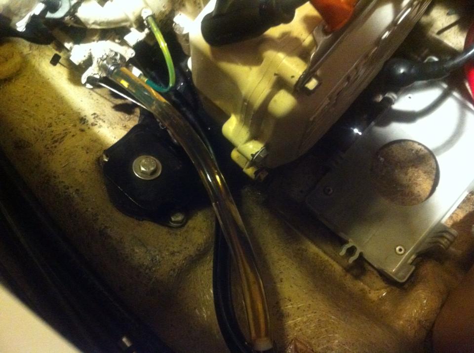

What do I check next? My only thought is that when I replaced the grey tempo lines I replaced them with fuel sizes too small? Or I have gunk in the selector knob? I'm willing to check anything. I just want my beloved jetski to work correctly. Maybe it just doesn't like my friends.

1 connect a volt meter to the battery and run it again. Look for over or under voltage when it bogs.
2 it sounds like fuel starvation, Not sure from what.
You could hook up a temporary primer to it and give it a shot when it bogs out.
Connect a volt meter to the battery and run it again. Look for over or under voltage when it bogs.
Hmm. I'll have to whip up some leads for my voltmeter that I can screw between the battery leads and the terminals, the bog only seems to happen at high speeds (and high rpms) so I'll need a way to be riding at speed on the ski.
Do you think it could be the size of the fuel lines I'm using? Actually, that doesn't seem suspect, I keep having to come back to the fact that the thing ran for 10 hours or so this season while only bogging a few times. Maybe I'll take the fuel selector nozzle out and re-clean that.
Could it be water in the fuel?
Water in fuel, Definitely could be.
I'm thinking that something has dislodged somewhere and is partially clogging the fuel feed to the carbs. Selector valve or pickup tube would be the first places I would look.
Try blowing back through the system from the carb to see if there is any restriction that seems to go away.
What size are you using ?
1/4 inch is what I use.
If you get out there again and do a plug chop. Hold it at that bog point and hit the kill while letting go of the throttle. Check the plugs and they might tell you whats happening. Ie , White = lean, Black = rich, brown = good, light tan = close to lean.
In the video it doesn't seem to stay boging for long. Does it keep recovering when it does?
Another thing could be a crack in a fitting at the selector or tank pickup .
I'm using quarter inch sized fuel tubing. I'll do the blow test, I'll try to perform a pressure test as well, sometimes the inside of the hull has a faint gasoline odor that I can't really explain, could the bogging be a loss of fuel pressure?
As for if it stays bogging for long, it's hard to explain. It seems to bog down, and come really close to stalling, sometimes if I keep the throttle depressed the engine will recover, and sometimes it will stall. I can sometimes keep it from stalling by letting go of the throttle. It seems to bog down, and then work fine for about 30 seconds, then bog again. Though sometimes they are more spaced out (up to 5-10 minutes) and sometimes they are close together.
Also, once or twice after bogging and trying to give the ski throttle again, holding down full throttle has almost no response for 10 seconds or so, and then the engine picks up.
Throttle response from idle is pretty great though, actually.
Looking at the microfiche, I see a filter at the bottom of the fuel baffle that I've never cleaned. Though, I remember the fuel baffle to be kind of troublesome to remove, so that might take me a while. I can't actually remember it was even possible to remove the fuel tank without removing the oil tank.... Gosh, I really don't want to have to deal with any more oil tubes.
I'll start looking again tomorrow.
Edit : What could have caused water in the fuel? (I don't actually think I winterized the ski before putting it in my garage in August and taking it out to give it to the shop in March)
Most water in fuel comes from water in the tanks at the gas pump. Did you install a filter before the carb when you did the fuel lines? If you suspect the fuel selector, they're cheap enough to replace rather than try to clean.
Edit: make sure the filter isn't backwards, and bypass the selector to see if it is causing your fuel restriction.
