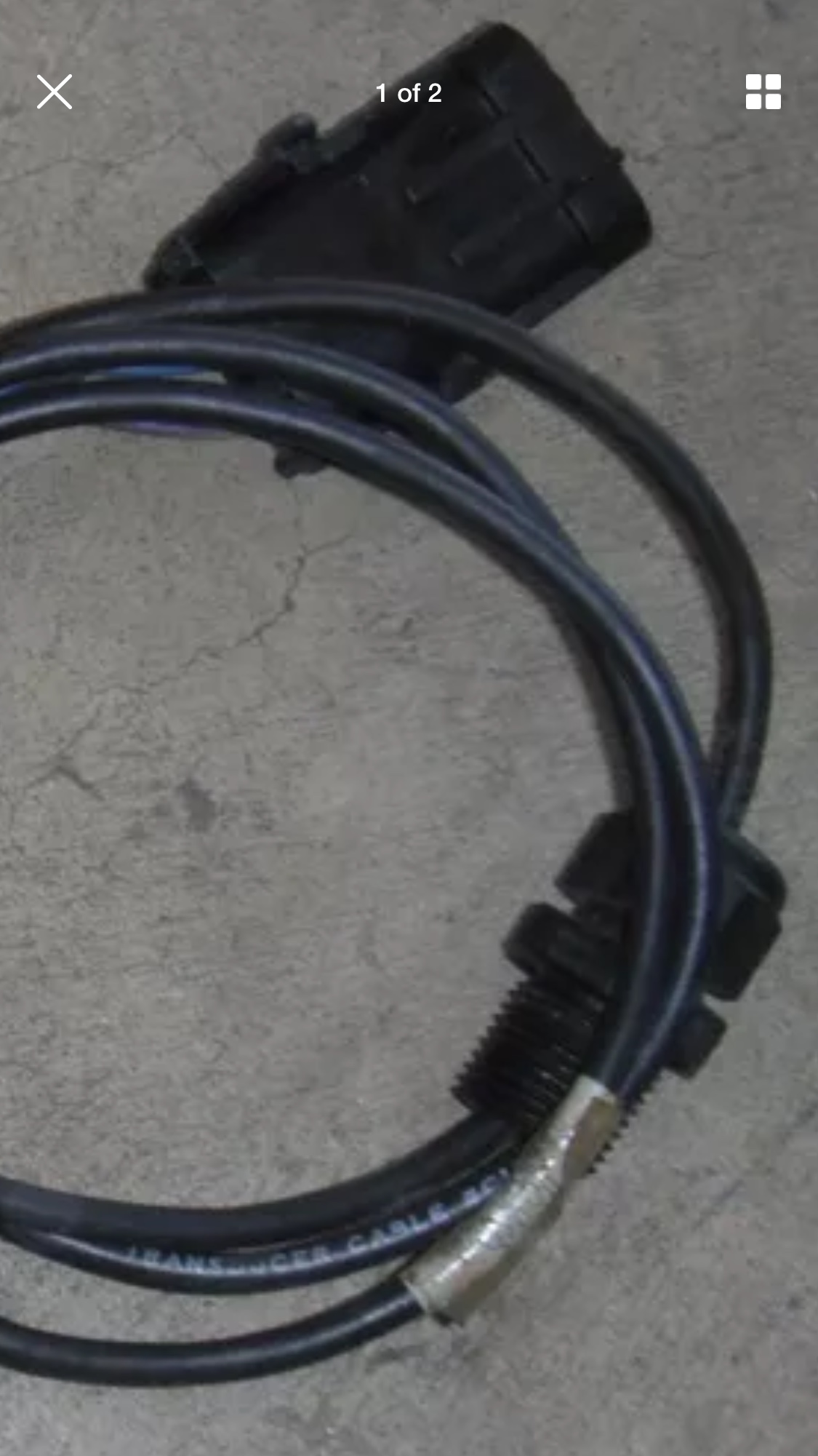

Few parts I picked up, a seat for $80 shipped, got lucky, great shape, came off a 99' gsxl. Also, picked up a speedometer sensor, compass, and ambient air temp, all hook right up to the info gauge. VTS looks ok, but I have no way of checking it at the moment. Fuel pick up is trashed, float doesn't float, I tried to fix it thinking an F1 problem, but no, it has a break in continuity on one of the poles, I've hacked it in 3 places and now I'm throwing in the towel. I need a another one.

I have the same model. Can you tell me what part numbers for the speedometer sensor, ambient air temp, and compass. Also, do you have a pic of how/where you mounted the speedometer sensor?
You'll need to remove that dummy plate in the rear, the speed sensor drops right in. I'm a longs ways off to installing/wiring it in, but it plugs in at the info gauge and there's a red/blk wire you ground off the gauge in the mpem to activate it.
I don't have part numbers, I bought everything off ebay. Search the 96' and up GTX's, you're looking for the 3 wire speed sensor. People are proud of them, used it is tough to find one under $50, even broken, but be patience and a good one will eventually show up for the right price. Get one with the plug and hull nut to make it easy. You'll pick up lake temp also on the 3 wire sensor, that's the 3rd wire.
The compass and ambient temp plug right in, each less than $10 shipped all day on ebay, again, 96' and up GTX.
I finally ordered the speedometer. Should be in this week. Couple of questions. How do you remove the dummy plate? Also, you said, “but it plugs in at the info gauge and there's a red/blk wire you ground off the gauge in the mpem to activate it.” Can you snap a pic of the red/black wire you referred to and where I ground it? Thanks
Look under the ski at it. It should be 6 phillips head screws, least mine was that way. Is yours different? I'll try and get a pic of the red/blk wire in the next couple days. Look carefully at the wiring schematics of a 96'- 97' GTX, it's a good guide to apply to the 96' - 97' GSX. That red/blk line needs a good ground, I verified on my 97' GTX it's attached to a grounding point inside the grey box/MPEM.

Oh yeah I know what dummy plate you’re referring to, it’s there. What I meant to ask was the threaded portion by the jet pump, do you just drill it out to allow the speedometer wiring to pass through as you thread the nut into it?
That's what I intend to do, drill it out. Looks like Seadoo used the same 140mm hull plate on some models just molded it accordingly with features equipped. Such as my 97'GTX has the VTS pass thru sealed, but our 96's GSX's have the speed o sensor sealed.
