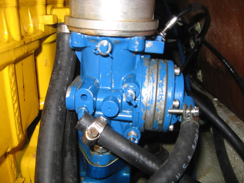

Ive been messing with this for a while and have rebuilt the carb, and put a new external fuel pump on it. It has the yellow motor. I have been doing some online research and cant find out if my BN round body is supposed to have an external pump as well as the one that is on the carb? Right now it will run if I pour gas in the carb, but thats about it. The external fuel pump is working. The fuel pump on the carb is not hooked up to a pulse line, only the fuel inlet and return are hooked up. can I get rid of the external and run just the carb pump? should I run another pulse line to it? can I just block it off? I dont know much history on the ski except its SUPER clean and was told it has maybe 15 hours on it and It looks it. It has some sort of intake adapter and had a nice K&N filter on it until it ended up in the lake. I would like to at least get the BN working enough to ride it before updating to the SBN which seems popular. So for now please dont just tell me to ditch it and get a new carb, thats not in the budget unless one is shipped to me for free, which I will gladly post my address for.

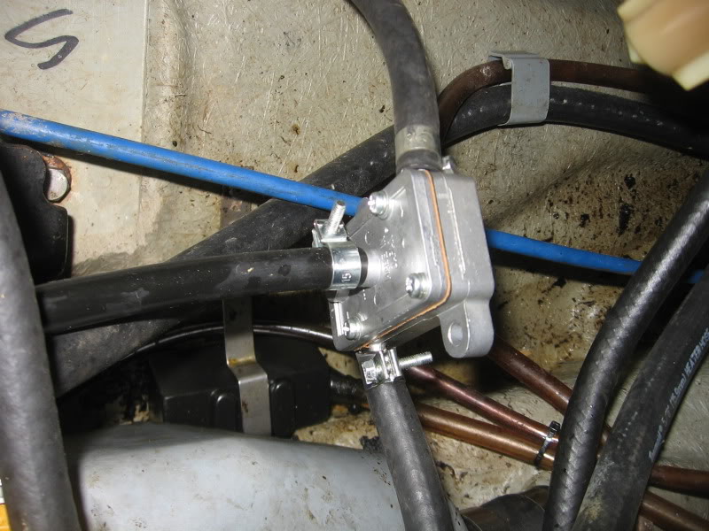

Anyway... that's not the factory carb. Your engine should have a round carb without a fuel pump... and then use an external.
This is what your carb and pump should look like.

A blue carb ... this is way out of my league of limited experience.
I just checked my stock 90 SP and it has the configuration the Dr indicated with black carb and external fuel pump.
I also checked my 91 SP and it has a black carb with built-in fuel pump.
Yes... the 91 will have an early SBN carb. (Square pump built into the carb)
If you need a carb... I'll sell the one in the pic for $45 +ship. It's off my old Si. (I did an SBN conversion on the Si) It's clean and redy to run.

That carb you have pictured is a 38mm BN and the blue one pictured is a 44mm BN. He will need the manifold also as the bolt spacing is wider with the 44.

As always... Chester is right.
Thanks for the heads up. I knew it was "aftermarket"... but didn't realize it was that much bigger.
well I guess I need to figure out what Ive got. So somebody has replaced the intake manifold and the carb at some point? Anybody around the northern IN area that would like to make some $ and get this thing going?
At this point I think Ill keep this carb and not mess with swapping the manifold.
