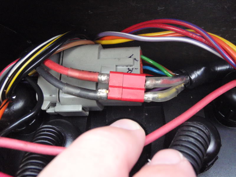

When I bought my Polaris, I found 3 bad pins in the wiring harness. AND... I got creative to fix it since I didn't want to buy the factory plug, with the tiny little pins for the main power supply. It took me about an hour. BUT... that's why I got it so cheap. The shop couldn't figure it out, and the owner bought a new ski.

here's my fix. (The red plug is my bypass)
