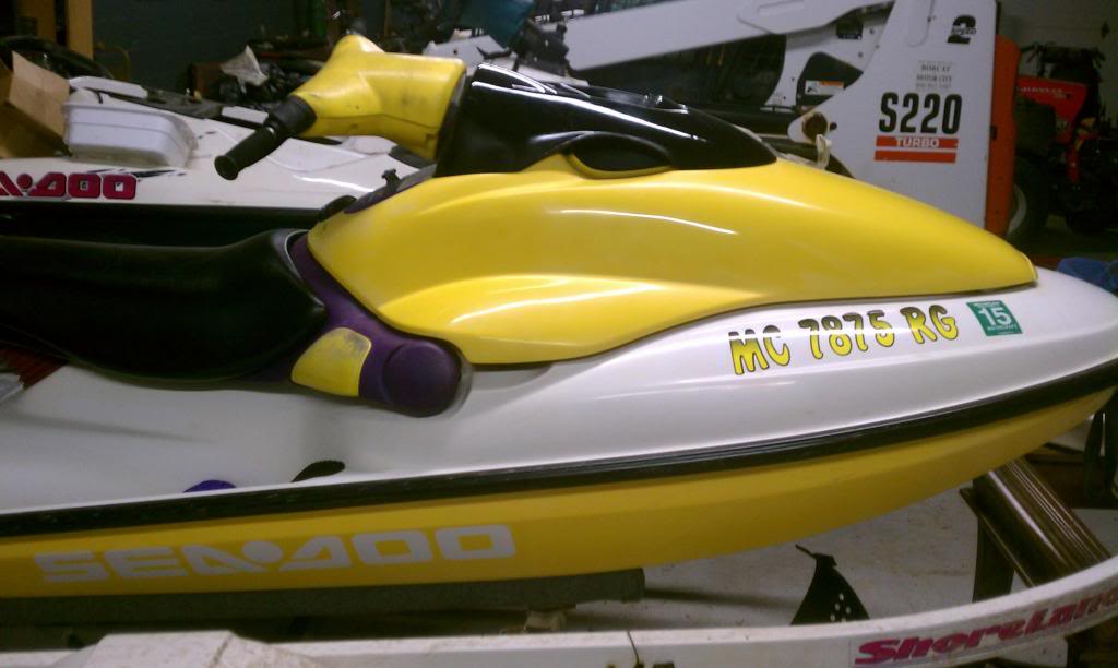

Here's one
Here are some before and after pics of the hull, tried taking more but the ipad doesnt have a flash
Yes but lose the iFad, major difference though. I really like the outside pics it really makes the ski pop and the hood looks sweet!

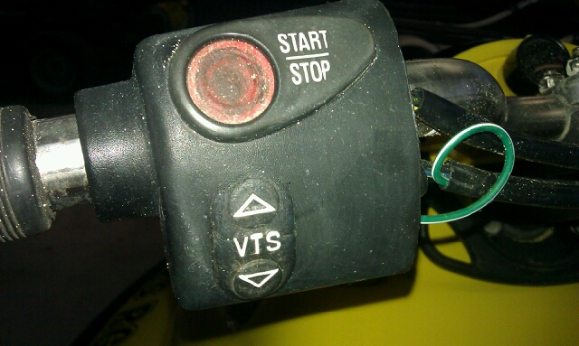

Today, i replaced the start/ stop button as well as the vts buttons, i also recovered the pad in black viynl and put the modified handlebar pad on.

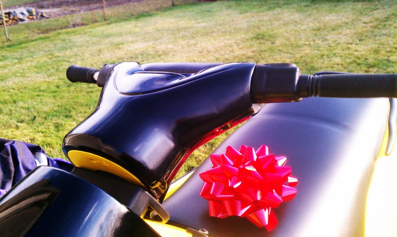

Also merry christmas to all you guys on the forum, some of you guys knew i was doing this project for my fiance's brother, i would like to thank Dr. Honda for rushing out those decals in time for me to get them on before christmas, I think this thread turned out to be an awesome xmas card,

I think he will be really happy with it, he hasnt read this yet, tomorrow at about 4pm he will. He has a 95 xp now and has been looking for a 96xp. I was going to make him a gsx because thats what i thought he wanted, but the day before i started it i was over his house and kind of brought up if hes seen anything on cl, he said he was looking at 96 xp's and mentioned they are still going at higher prices. I casually brought up what color scheme he would do and he said black everything and a single gauge hood. So i had an xp too so i think i got his wish list down. Tomorrow we have a family xmas party at his parents, at some point i am going to hand him my ipad and have him read this thread to see what he thinks of the project. today i went over there and squeezed it through a 36" gate and covered it up. The hull is 39" wide.
