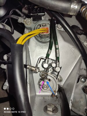

Hi.
Does anyone have a 787 800 oil pump on the bench and could measure the distance between where the spring sits and where the adjustment line should be on the oil pump.
Mine has rusted and I can't set it up following a rebuild.
I've attached an image to show what I mean.
If that is your actual engine, replace the small oil lines and make sure you are using the correct API-TC oil.
If you scrape the paint off you should see the line as it is stamped into the metal.

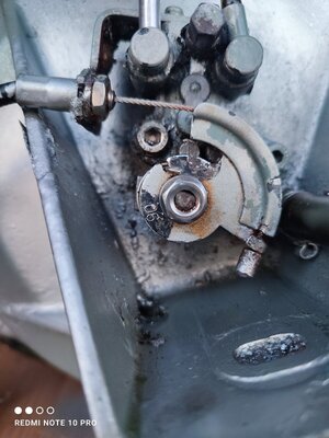

Yes it is mine. I have just rebuilt it. But the oil pump looks like this before I sprayed paint on it the other day..... Attached. Do I am not exactly sure where to set it IMG_20230608_213350.jpg
