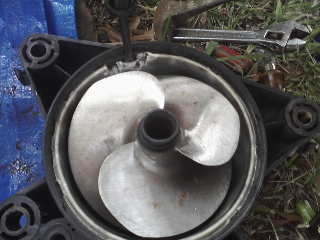

That's a whole lot of cavitation, on both sides, crazy. Are you sure your wear rings are ok? Post a pic of them. Also, when you installed the engines, how did you align them? If they are out of alignment those seals won't seal properly.
