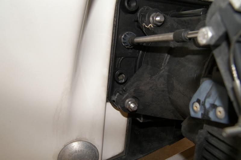

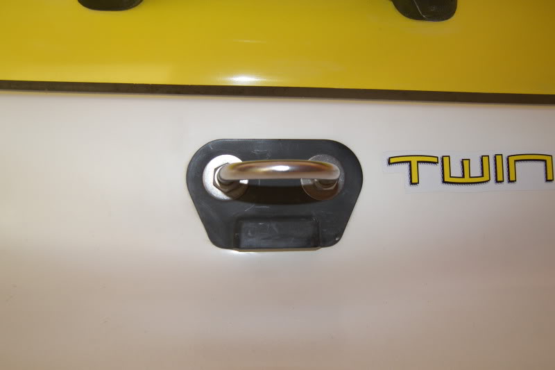

This is what I am calling the bleed outlet. Should be getting water from here so that it is easy to see.
I only get water to come out if I plug the hole right above the bottom screw.
Your pics confuse me even more. What you are calling the bleed outlet, looks like the tow hook to me.
On my challenger the tell tale comes out from under the tow hook . you can feel the warm water when sitting on the swim platform. I have the opposite problem the hose going to lower hole is clogged.
