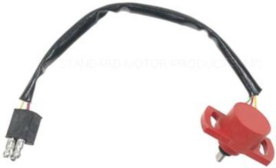

Well... all the Merc guys know, that the Throttle Position Sensor (TPS) doesn't last forever. AND... that it's a $500 part from Mercury.
Last summer, a couple members and I were talking about a cheap replacement. We talked about using something off a car, and making an adapter. BUT... last night... I may have stumbled across the actual part !!
SO... knowing that Mercury didn't have something custom made(they never do)... the search was on to find it's automotive counterpart. From what I can tell... it looks exactly like the 80's, to early 90's Lucas electrical TPS. They were used on some of the Jaguar's and LandRover's. The actual "Case" of the TPS looks the same, with the same "Blade" connection into the throttle body. (FYI: the generic part is TH418)
The only thing I can see that is different is the actual plug on the end of the wires. The Auto version is just bullets, and Merc Probably spec'ed out a "Weather Pack" connector so it was waterproof.
So... right now...
The good news: It's only $125 brand new from RockAuto.com !!!! (not cheap, but better than $500)
The bad news is: I don't have one in my hands to know if it will work.
I'm going to try to find a used one, just to see if they are physically the same, and that they rotate the same direction. If they don't... I'm going to just find the cheapest, common 3 wire TPS out there... and make an adapter.
Here's the Jag version:
