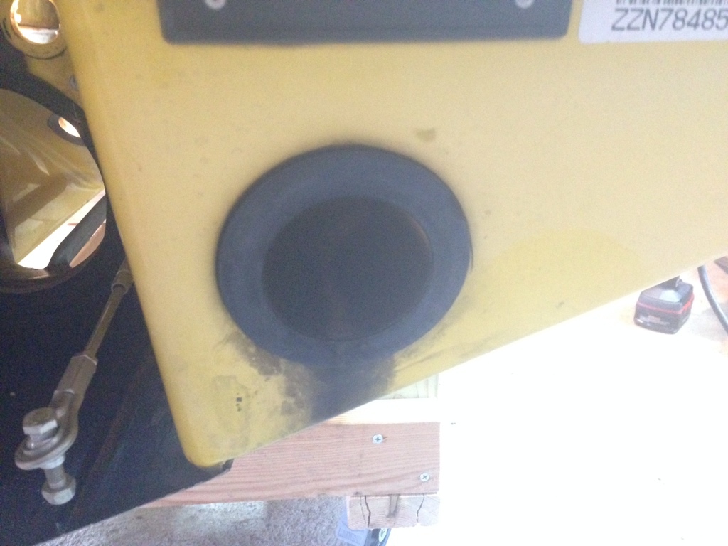

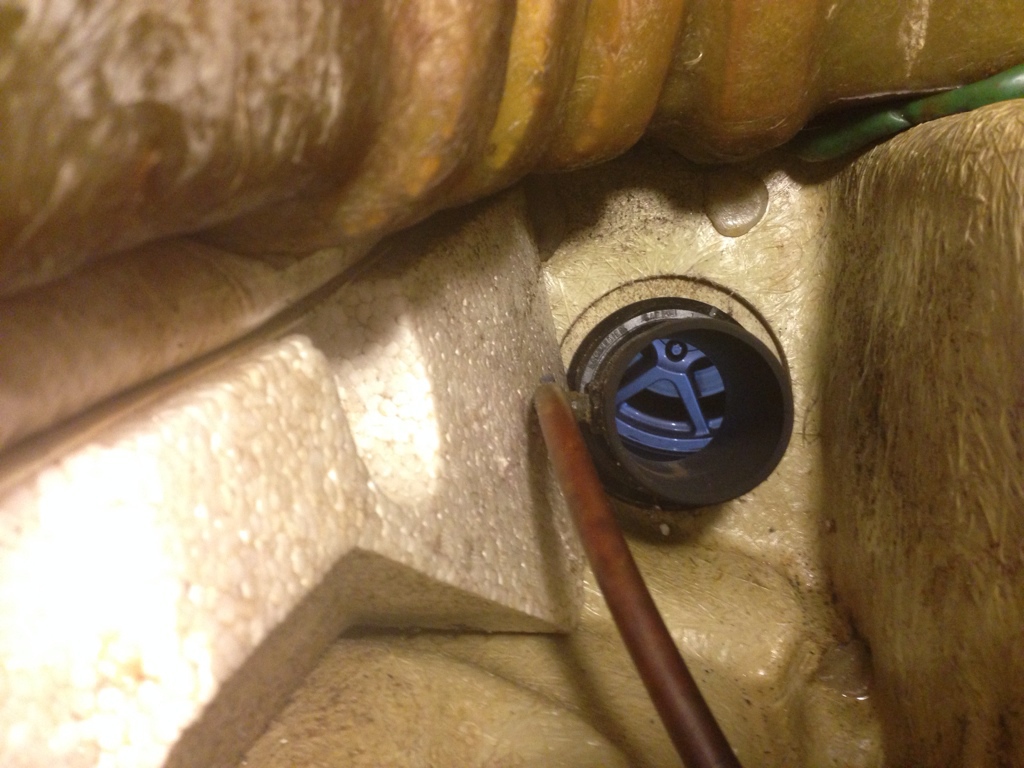

Yep, it appears there is a special tool to turn the big nut on the inside. Anyone have any ideas to remove and install this without the special tool?
Pics.

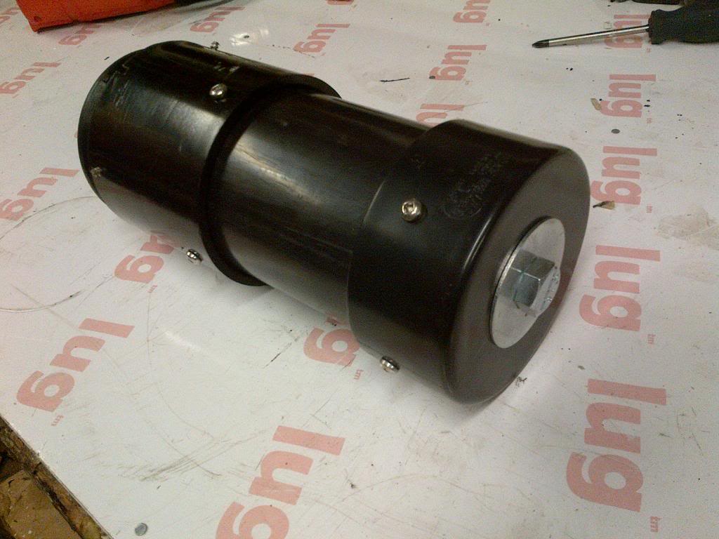

I think [MENTION=51350]Jetskigoodies[/MENTION] or [MENTION=41828]Minnetonka4me[/MENTION] or [MENTION=57920]racerxxx[/MENTION] had made a PVC tool to take that off
Yea, I vaguely remember a tool made perhaps from a PVC cap and some screws...maybe someone will chime in

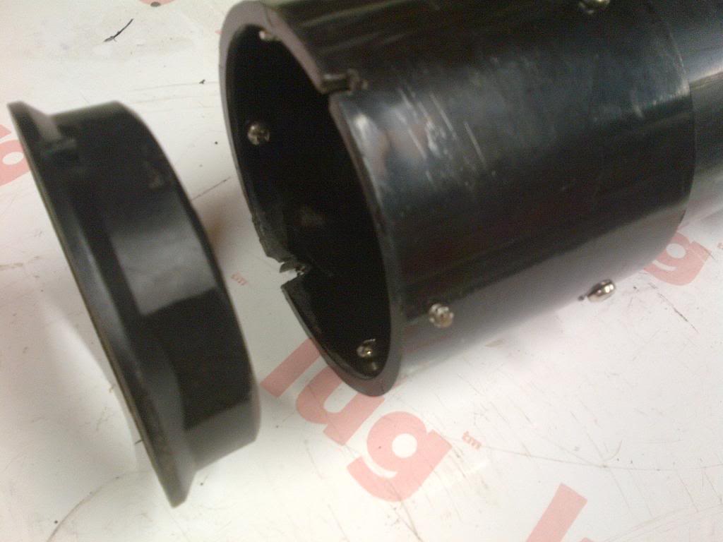

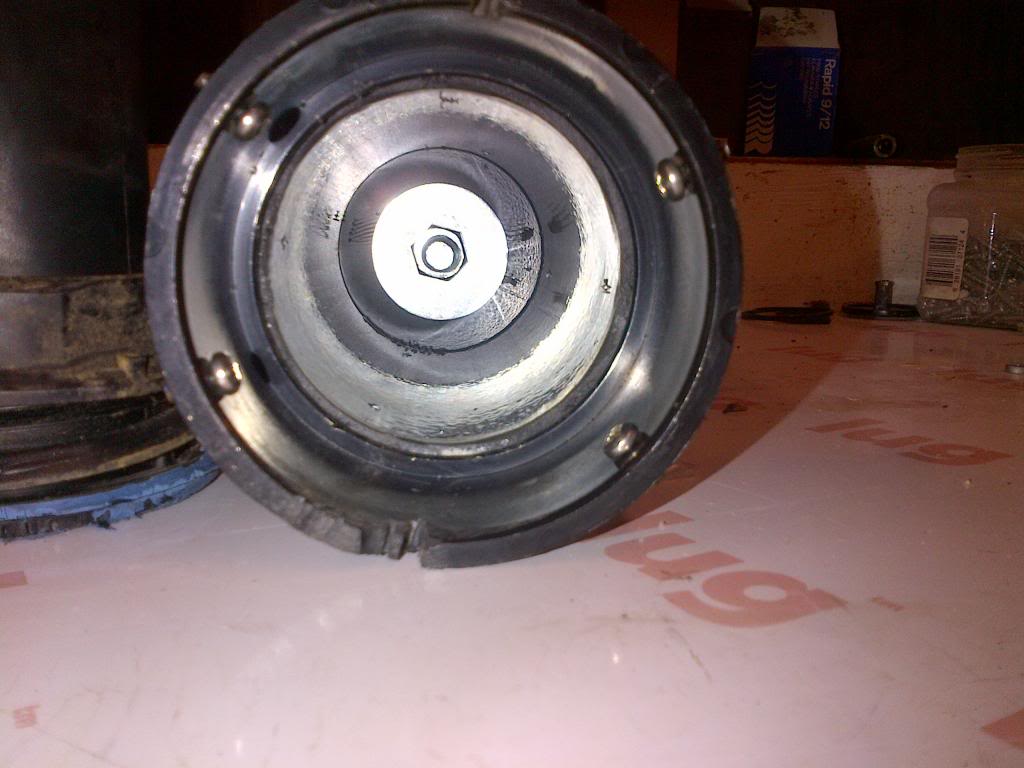

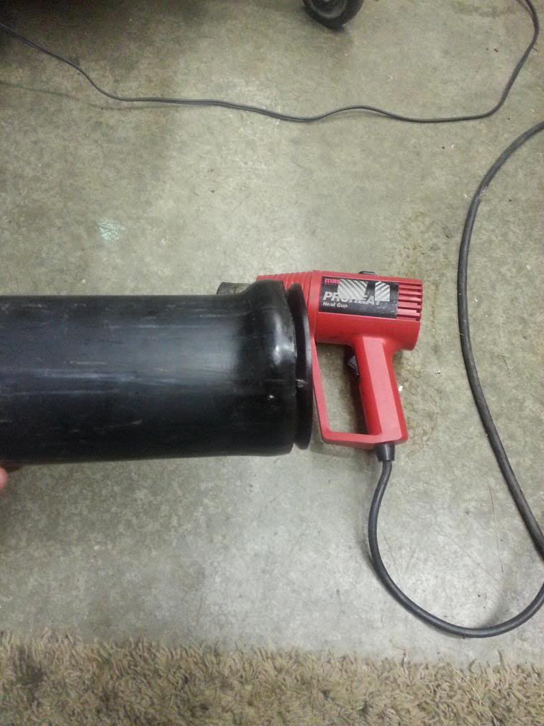

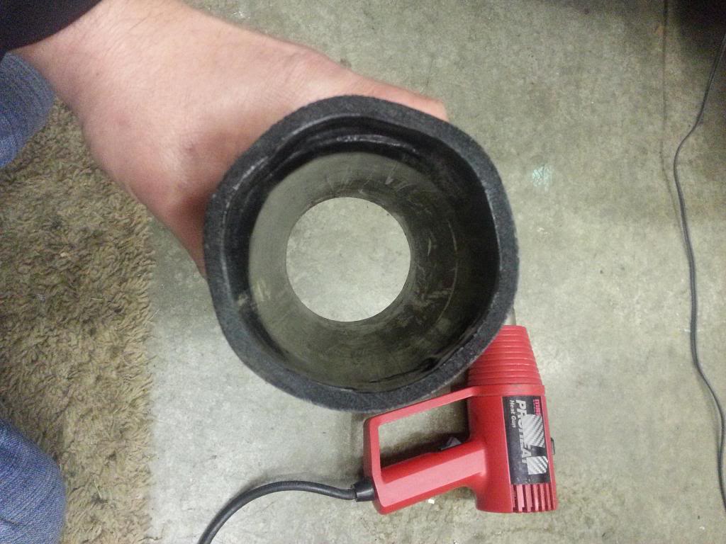

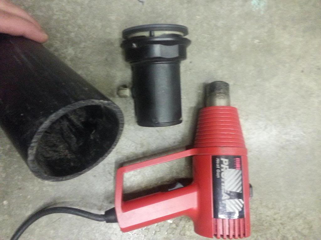

LOL this is funny. I just made one today but I cheated. Tonka has one that his Pop made, it was nice but it required me to run to HD to get supplies. I already had 3" inside diameter ABS pipe at home--note not PVC. I also already had an exhaust set up out of a hull, but I do believe this could be done in the hull. So I just lopped off a chuck of my pool drain extension pipe (to get the water to my neighbors yard, LOL), heated it up so the black pipe started to blister a bit all the while rotating and heating the inside and outside from the end to about 1" to 1-1/2" back, then I worked it onto the nut, let it cool. I walked over to the 95 slipped it on and with next to no effort it was off. This measures about 8" OAL, You can go as long as you like since the hull is empty. I used the same ABS pipe to make my VTS nut removal tool but in smaller 1-1/4" pipe. Enjoy!
Here is Tonkas

ABS is "airy" compared to PVC. PVC is a mother to get hot enough--in that diameter and keep it molten enough to form. I heated the ABS for about 5-6 minutes.
Thanks to Tonka's Pop, here is option B.
I do like the molded route though, I think I will make one that way for the VTS nut and those nasty x4 gauges.
That is probably one of the most awesome things I have ever seen.... Great idea, and opens up a lot of possibilities for other things.... Definitely gonna be grabbin some abs to use on a couple nuts on my Ultra.... Never would have thought of that, thanks guys!
Yup we can thank my dad on the pipe-turned-tool idea...I was just coming up with nothing and was really busy so I tossed it to my dad and he came up with it in about an hour.

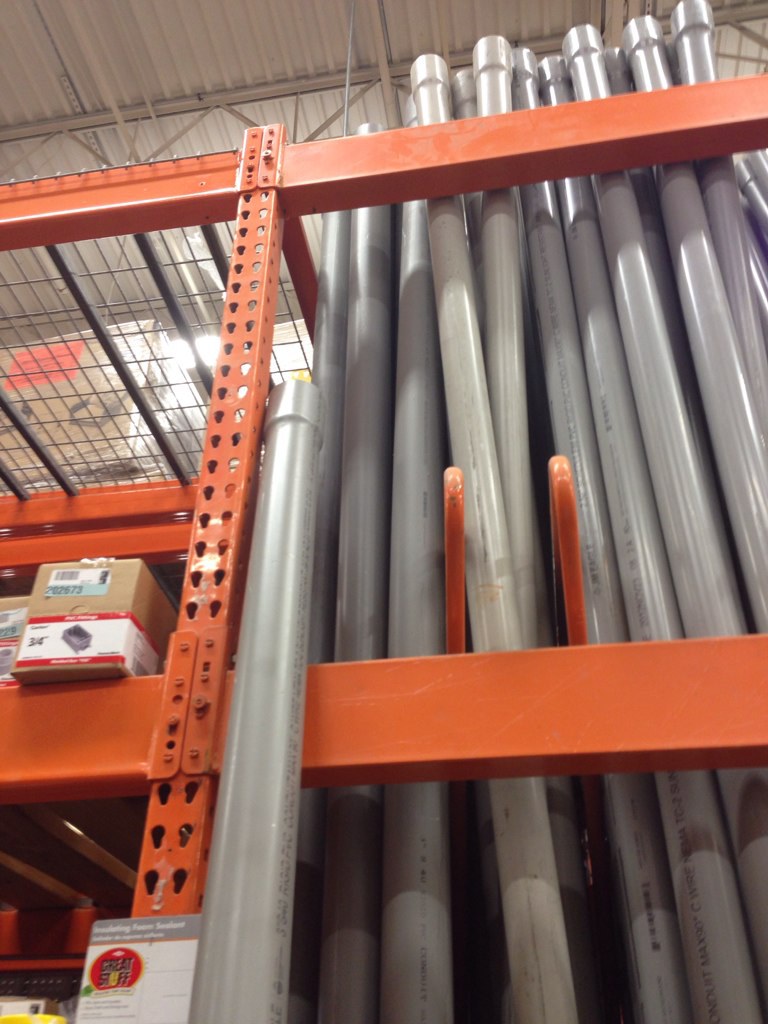

At The depot now.
All they have is 10ft lengths of this stuff. Abs?
What I think I am looking at is PVC just grey...
That's electrical conduit, not the same, that's pvc. Go to the plumbing section and see if they have it.
Sent from my SGH-T889 using Tapatalk 2
No dice, I did find something that may work. Going to try it now..
You might need to hit a real contractors supply house. I will say I had has this abs for probably 14 years.

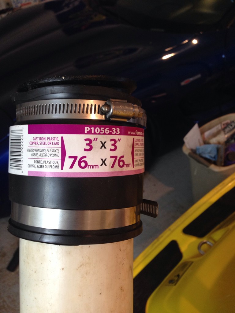

Success! I ended up using a 3" rubber coupler for PVC. Worked like a champ, the rubber formed nicely around the nut with the aid of the included hose clamp...
Thanks to all for the help!

Racer made the first gauge removal tool, [MENTION=57920]racerxxx[/MENTION] was asking me how to get them out and I suggested making a tool like the one that [MENTION=41828]Minnetonka4me[/MENTION] made for the exhaust nut. He made one and after seeing his I made one immediatly and took about 15 gauges out of hoods that were sitting in my basement. The tool makes a world of difference.
